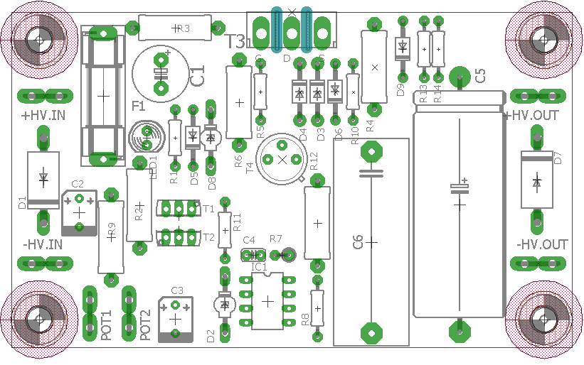

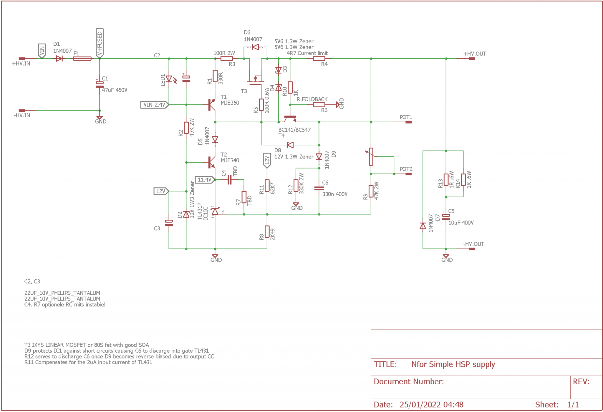

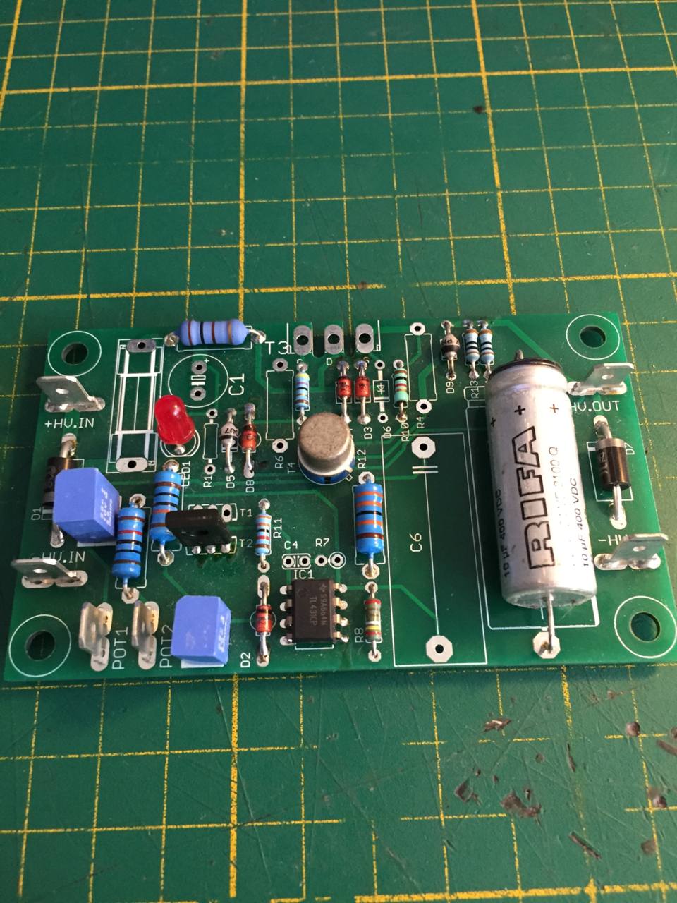

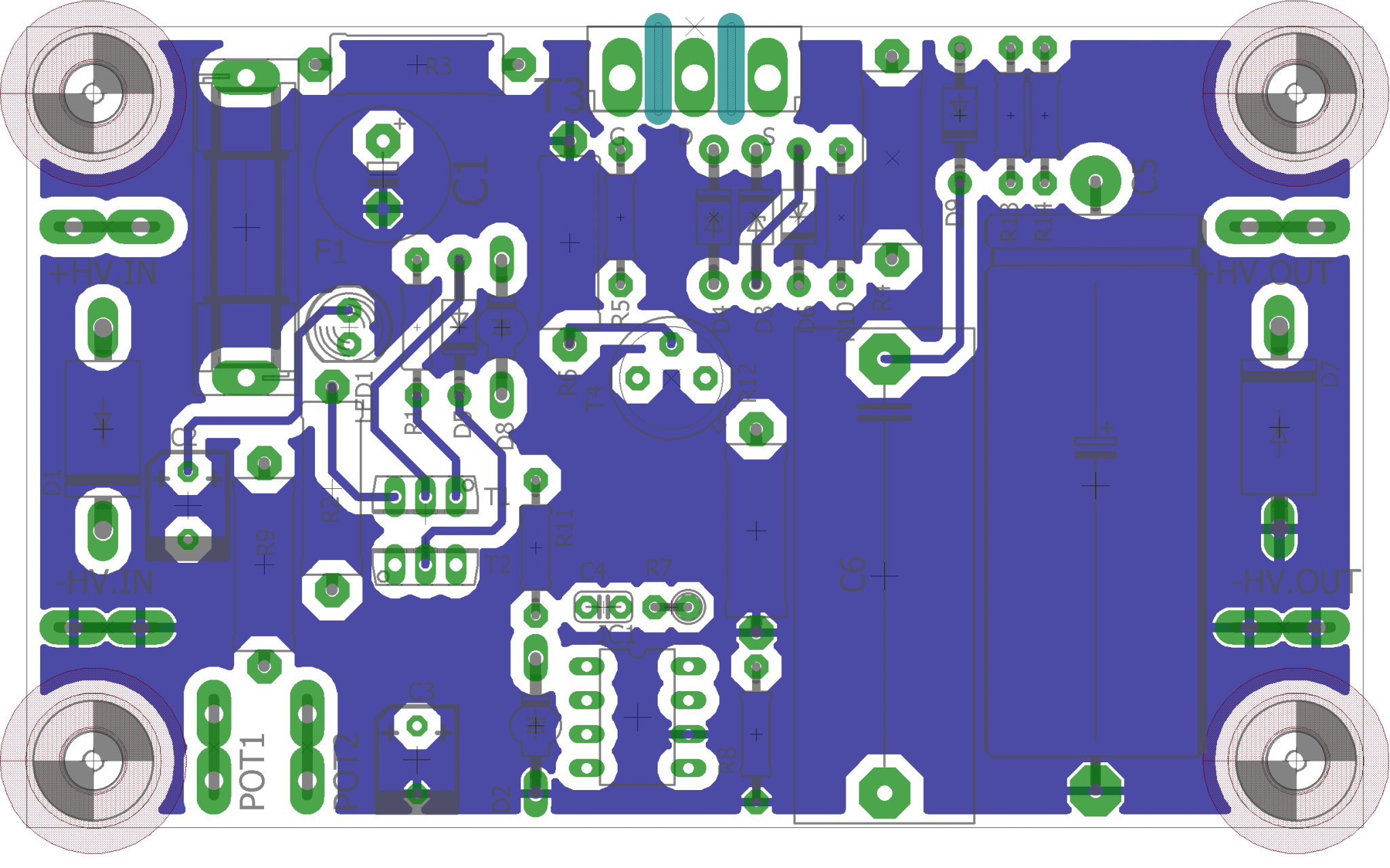

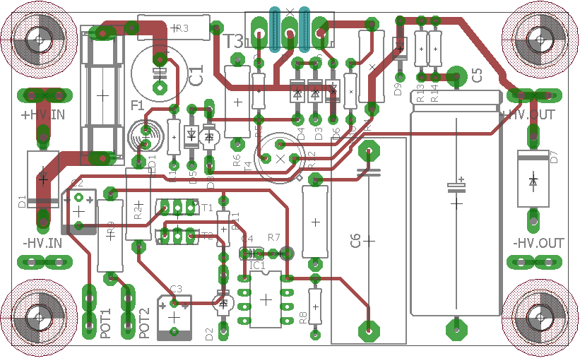

Ive designed a similar regulator, but took the TL431 for the control chip. attached all the design files, in case you want to do anything with it.
