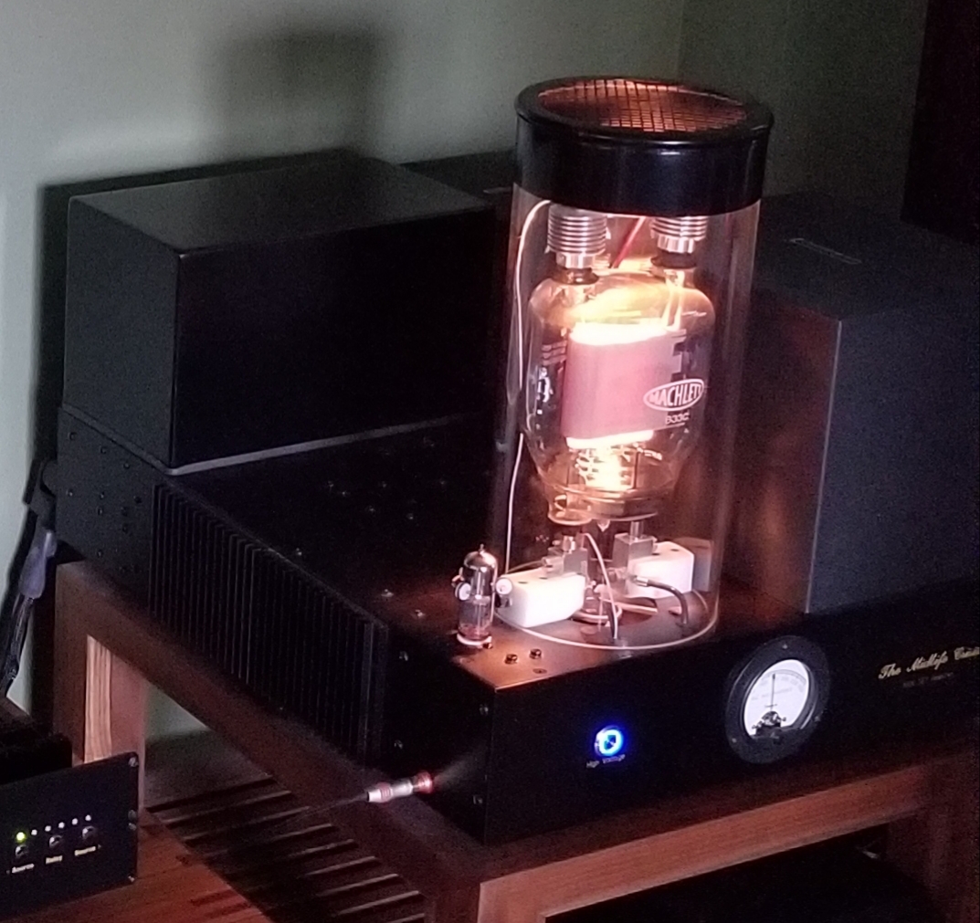

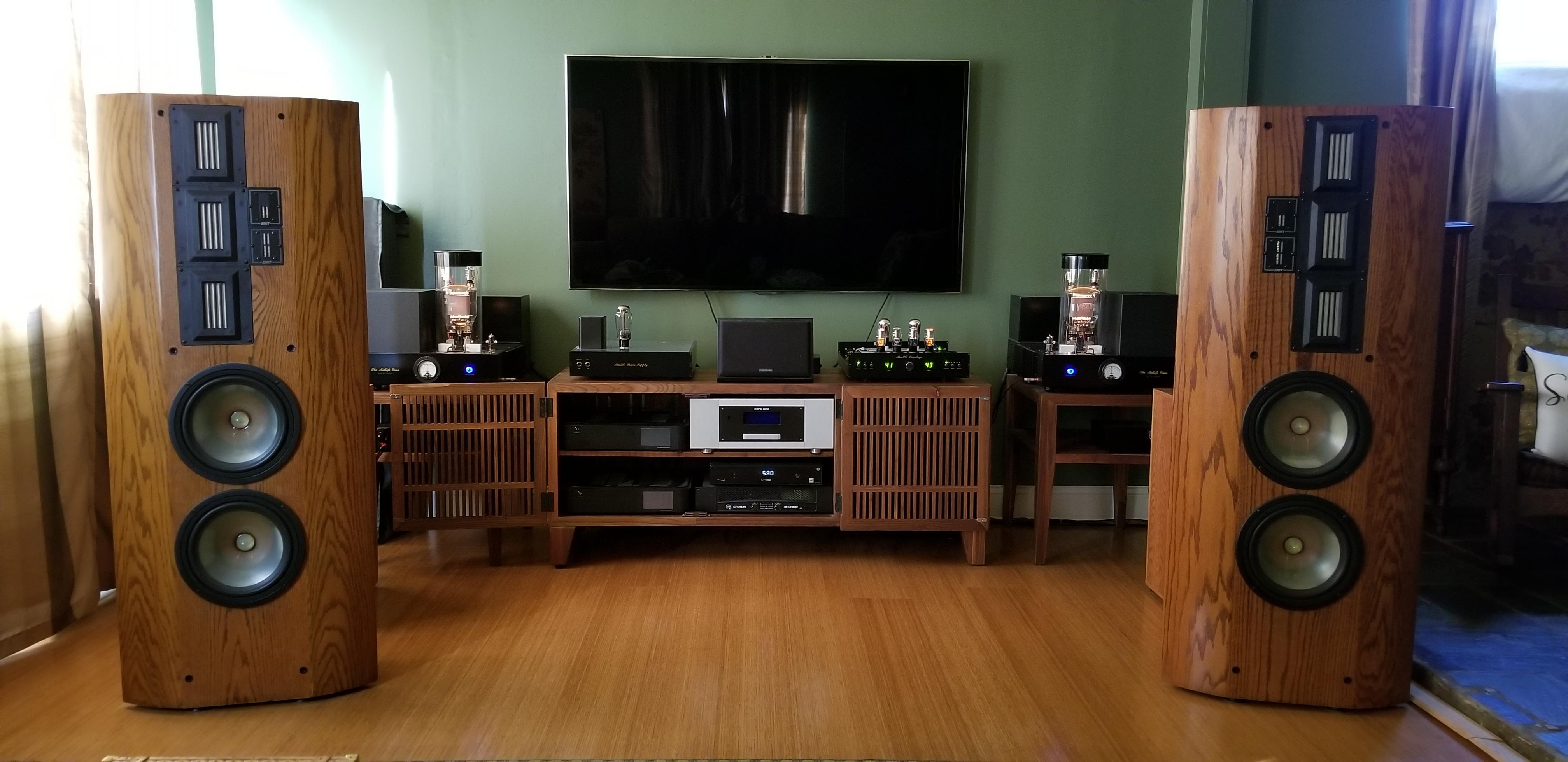

I run my Infinity RSIIb speakers full-range with SET monoblocks. Unfortunately I had to build them from scratch myself, if you are so inclined they run at 2.3kV, took about a year to build, and look like this...

And it looks glorious.
Magz, that is impressive man ! I’ll bet that sounds awesome. I have the opportunity to buy my llb’s back but I’m out of room. I did purchase a bunch of McIntosh stuff today for the Gammas but I’d sure like to try some tube stuff up top.
Damn that’s Glorious !

These monos are nice looking
Mingda Handcrafted High End Valve Amplifiers
but I suppose it operates mainly in A2 mode
They talk about a max anode voltage of 1000V, so definitely A2.
And it is expected then, that the 300b driver tube operates as a cathode follower. It is, in fact, similar to Wavac833 general features.
