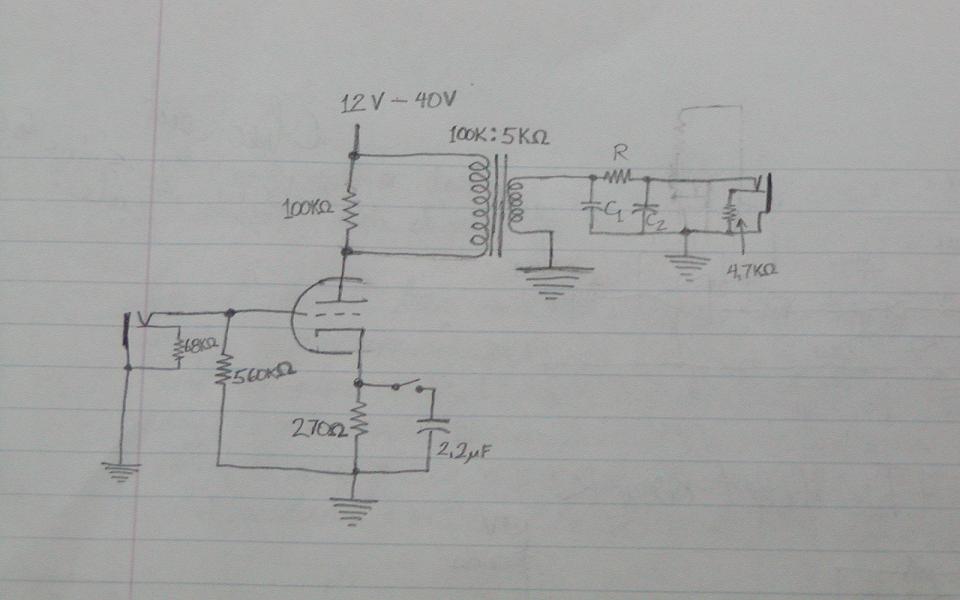

i've used 2 of these cascaded with a 12V wall wart supply (rather than the 40V shown) and get a surprising amount of gain out of it. and the tubes i used weren't the 12ax7's shown, but 6BF7 submini tubes with a lot less gain than 12AX7's. it's a nice stompbox with enough boost, and tube sound.... you'll want to add 1meg level pots at the input and output

with most average-to-hot pickups, the tube pre shown above will distort if driven hard enough. gain with 6BF7 tubes is about 30, with 12AX7's probably closer to 75-100 (with 2 of the circuit shown above cascaded and running 12V plate voltage). if set right to the edge between clean and dirty, it has a real nice smooth "touch" since it doesn't go into hard clipping

i've seen some DC-DC converter modules that take 5-24V in and have outputs in the 100-200V range (regulated quite stiffly and cleanly at whatever voltage is selected). i was thinking of trying one of these in my next model of the stompbox. using 100V for the 6BF7 tubes would increase the gain of a single stage to about 50, so i wouldn't need to cascade the stages. this would also work for a 12AX7 version also and increase the gain of a single stage to well over 100...... then again, i may have to make my own..... i found one such module listed in newark's catalog .... for $60.00. dc-dc converters aren't difficult to homebrew if you have a few toroid cores in your parts box. i'll just need a wall wart capable of a bit more current........

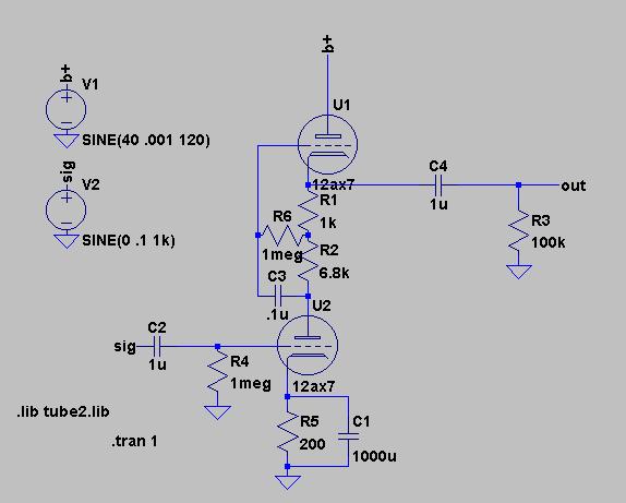

As a guitar player and an electronics technician/hobbyist at heart, I would like to help you just as the other readers do. however I must clearly understand what KIND of sound you're looking for. As mentionned before if you could give us sonic examples (Chords resonating à la Van Halen, Won't get fooled again type intro sound, etc) then we'll be much more able to know what type of electronic solution to provide.
I was particularly interested when you said: "I was thinking that using a single 12ax7 would be fine, the iron needed should be pretty low level. I'm assuming I would need a small preamp sized power transformer, and that would really be it."
So you want to actually have a little class-A preamplifer, made as a power amplifier, to drive the input of your Orange Amplifier.
Is that your idea?
If so, then why not something like this:
Oh, wait I gotta draw it...
Is that your idea?
