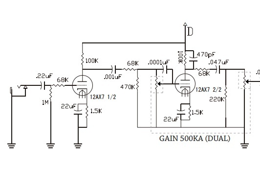

I recently decided to have a dabble with a tube amp to see if I can make a reasonable design myself.
As a total tube newbie I started with the veritable 6J1 bile amplifier from China.

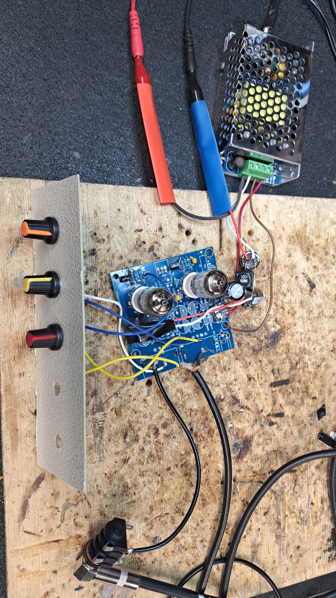

I didn't have an AC transformer but I got a smps with hv and heater outputs.
I've prototyped the design, adding gain, tone and volume controls. I changed the tubes to GE5654.
But it sounds... Bad. There is no hum but the distortion sounds crude and rough, more like a bad fuzz pedal.
I'm not totally sure it's being biased right and I'm still reading up on load lines etc
I've captured the schematic and build in case I'm making newbie mistakes!
I know I need to change the caps to polymer - they are on order.
Has anyone built one like this specifically for overdrive distortion?

I don’t have 5654 curves in triode, so I can only comment on frequency shaping for a guitar preamp: change C10 and C16 to 1 nF and remove C17.
Here are the 5654 (6AK5) triode curves: https://www.diyaudio.com/community/threads/6ak5-in-triode-plate-resistance.343410/post-5931791

Not strictly true. Most famous amps clip one side mainly (see cold stage and CF two stages apart), and many unbypassed stages.

Usually, you never achieve a good preamp distortion tone with only two stages, but rather a fuzz sounding tone... In fact, you need a third gain stage, plus serial resistors of 220 to 470K in the grids. This is the way to offer smooth clipping and sustain.
Marshall, Boogie, Dumble, Matchless (HotBox) all went for this classic, long proven solution, and after much tests, I had to go to this solution myself too... Even on a SF Twin-Reverb with MV, you find 3 stages, and serial resistors.
An exception though : if you plan to use clipping diode in your circuit, like it was the case on the Westbury W-20 The Tube (1978-1982, historically one of the first tube overdrive pedal) and on some Marshall amps (2210, 4210, JCM900 series).

The stages are biased at 0.8V, 0.9V, try biasing to 1.5V Increase R26 at least100k, reduce C10/16.
