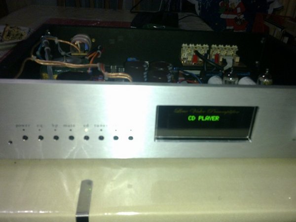

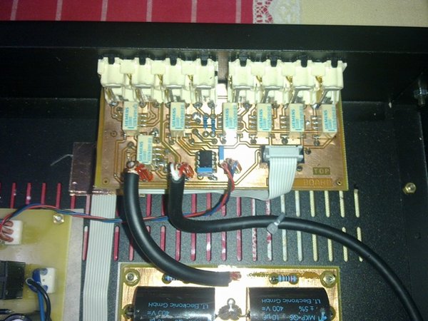

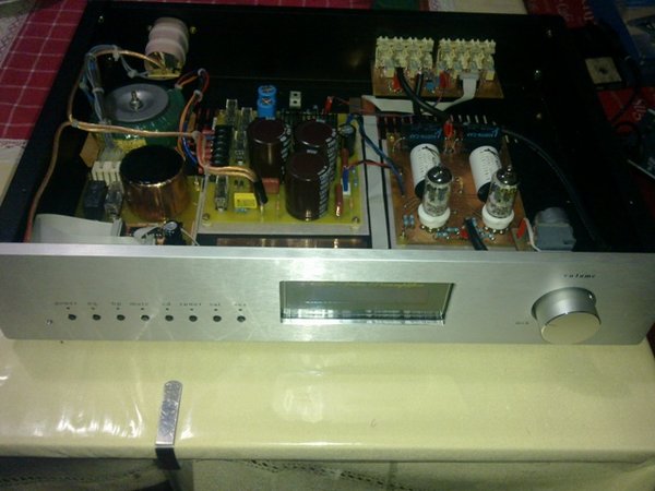

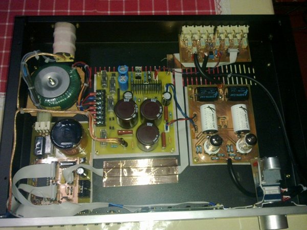

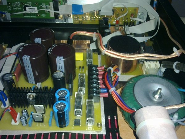

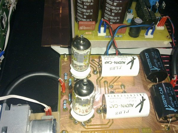

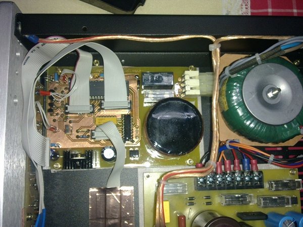

hi,
finally i made this preamp: DIY ECC802S (12AU7 / ECC82) Vacuum Tube SRPP Preamplifier
the preamplifier sounds good but i have two problems and i need your help.

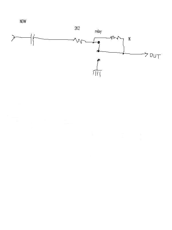

1.i have a mute relay at the preamp output (see first picture). when i power on the preamp the relay is in mute condition for 10sec. after 10sec it connects the output to the power amp input. when this happens i have a loud thumb from the speakers.I try to change the 10sec to 15 sec without any difference.
2. even when the preamplifier is working and i press the mute a have a thumb when the relays goes to mute on state.(when it grounds the power amp. input). When it goes to the mute off there is a little thump.
that two are a big problems for me because in most cases when i power up the preamplifier the power amplifier is already on. (it is already on because i use it for home cinema too with the home theatre bypass feature of the preamp)
can you show me how to connect the mute relay and possibly what resistors i need to use?

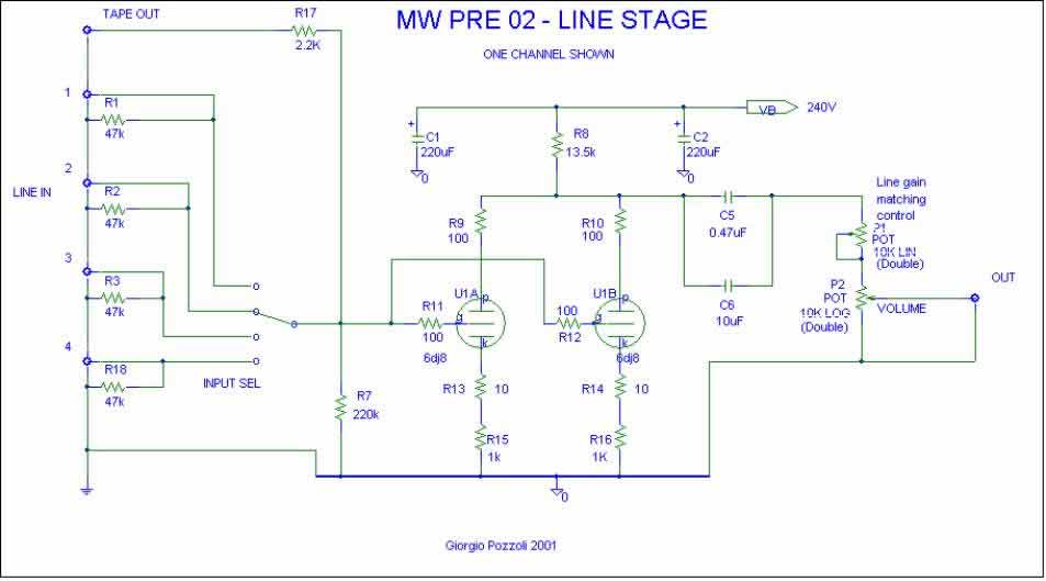

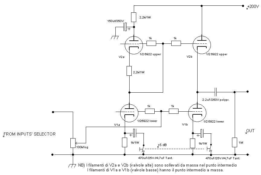

hello,
I am searching for a tube line preamplifier schematics. Does anybody knows a very good sounding designs? I do not have any tubes so i have no limitation on that.
thank you
Hi korabetsni!:hohoho:
Here schematic pre-amp (Line-stage) with 6DJ8 (ECC88).
Know gives a great sound!
Enjoj!!
