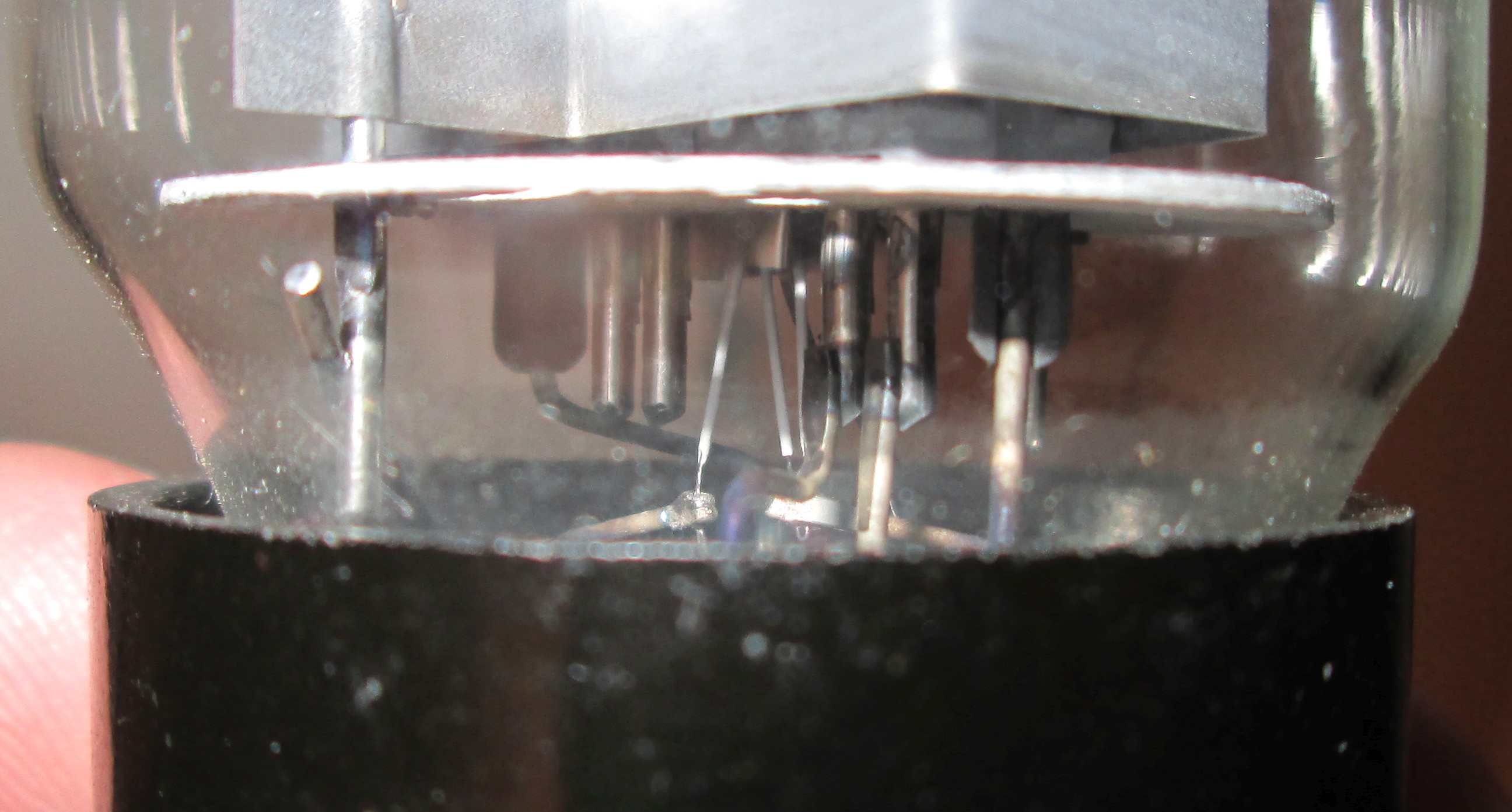

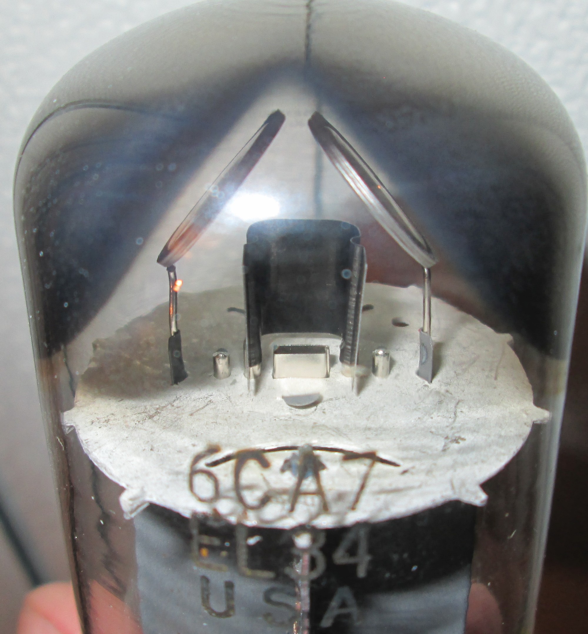

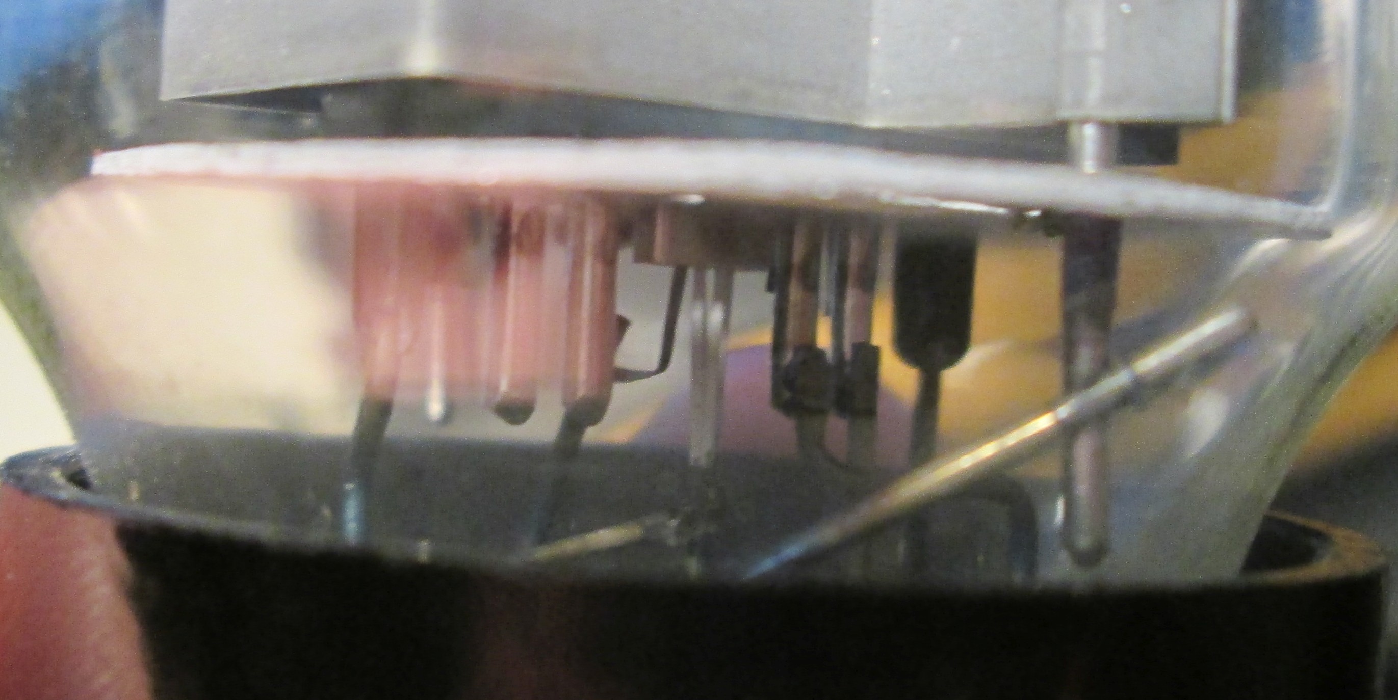

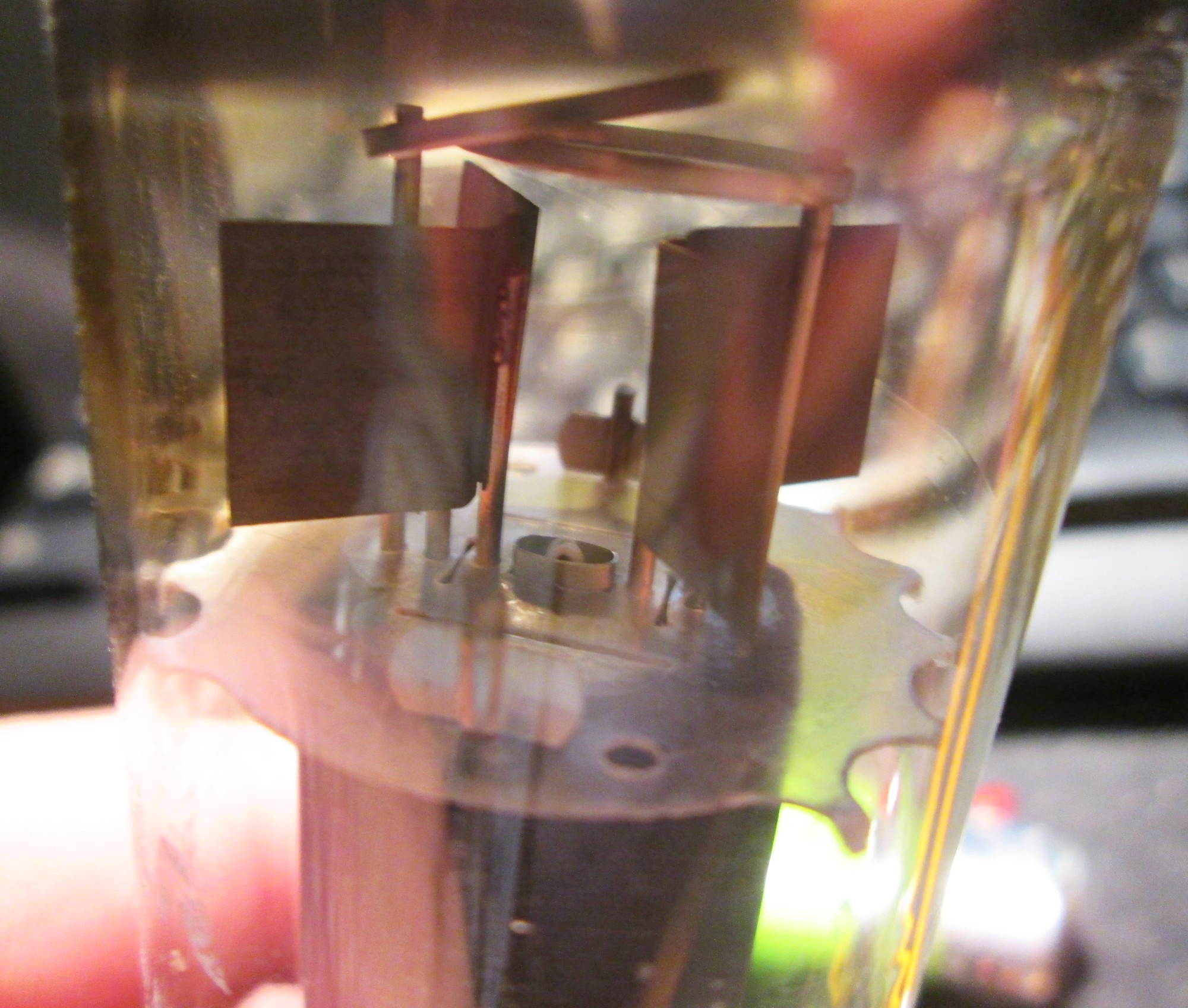

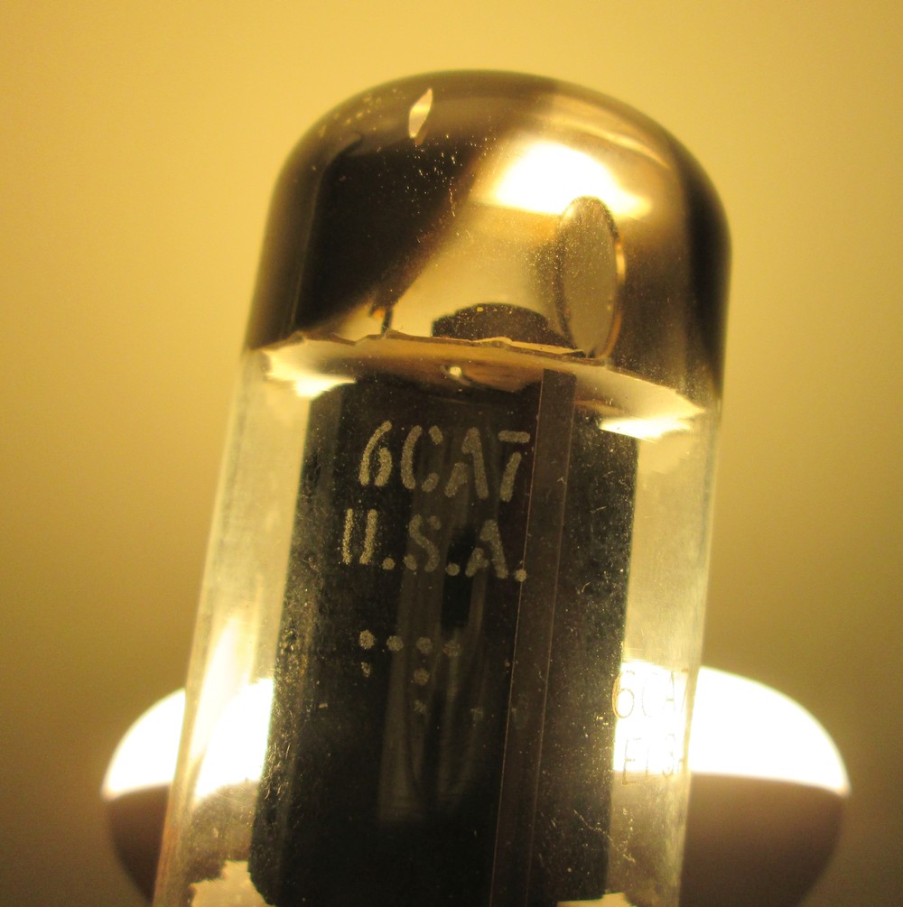

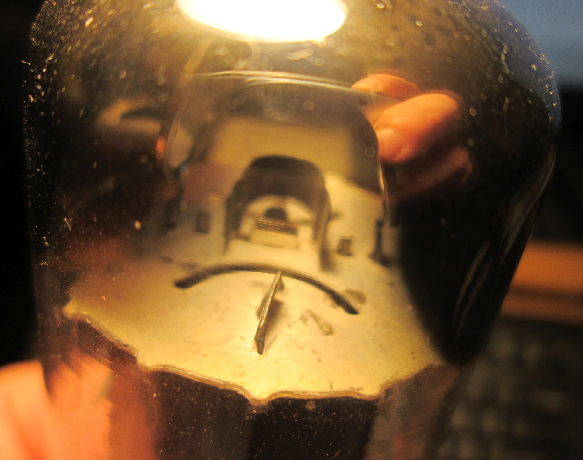

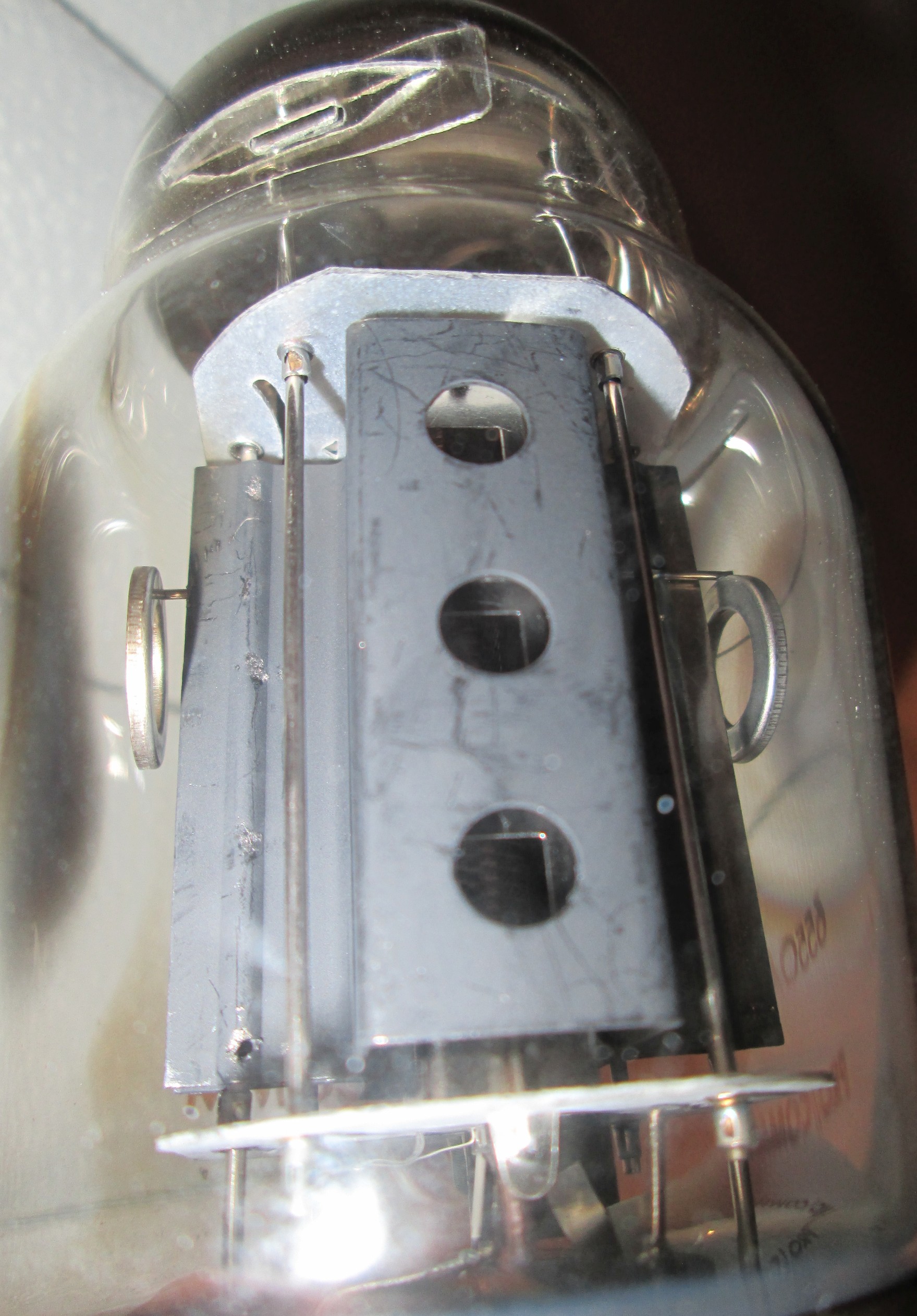

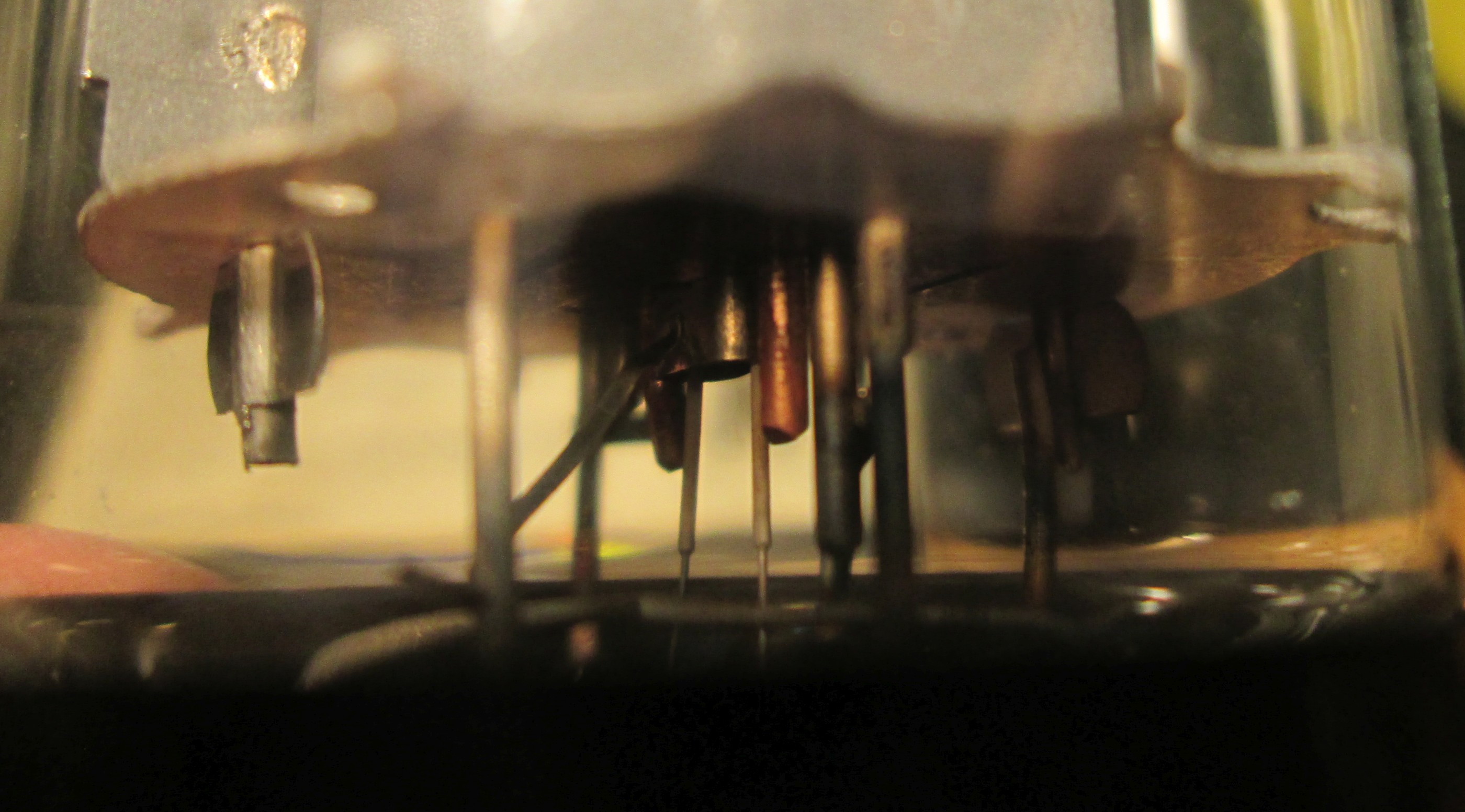

You may be right 6A3sUMMER. I have some old GE 6CA7 here, and a an early 1990s Tesla EL34. I also have a 1970s RCA 6L6GC to compare them to.
I've attached some photos of the innards (through the glass; I'm not smashin' these). Any way to tell from these photos?

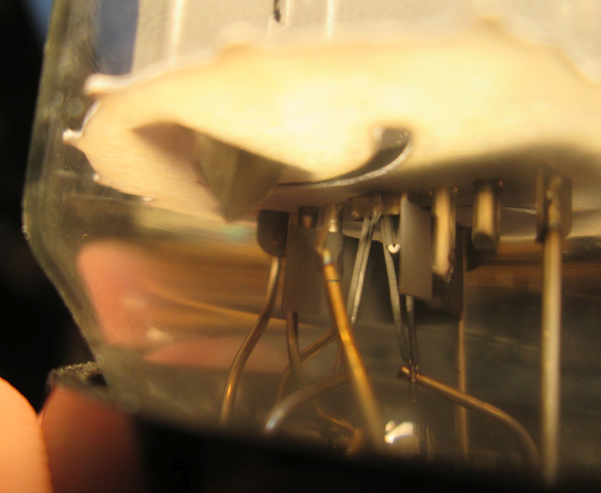

First batch, GE 6CA7

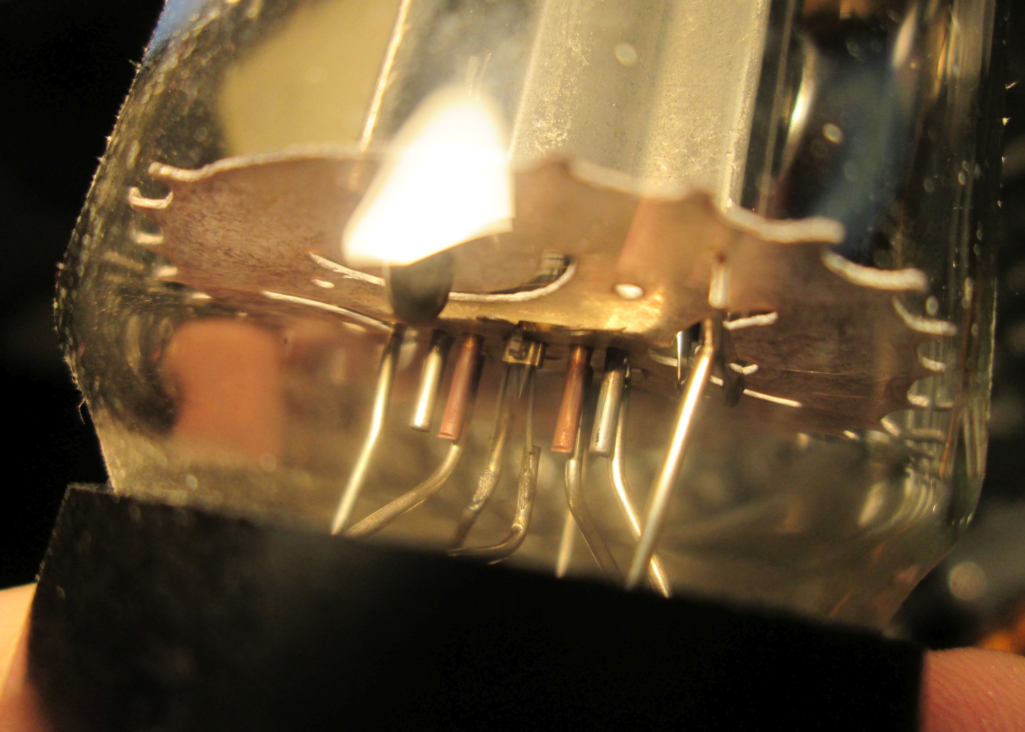

The base has all 8 pins

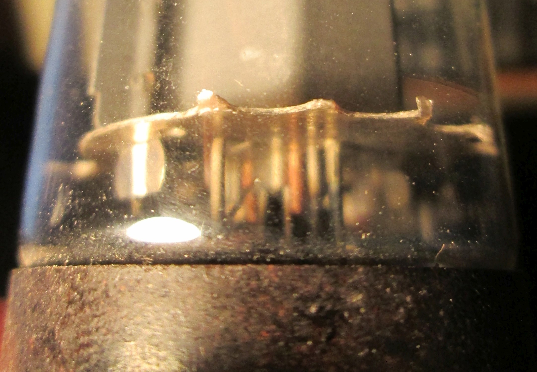

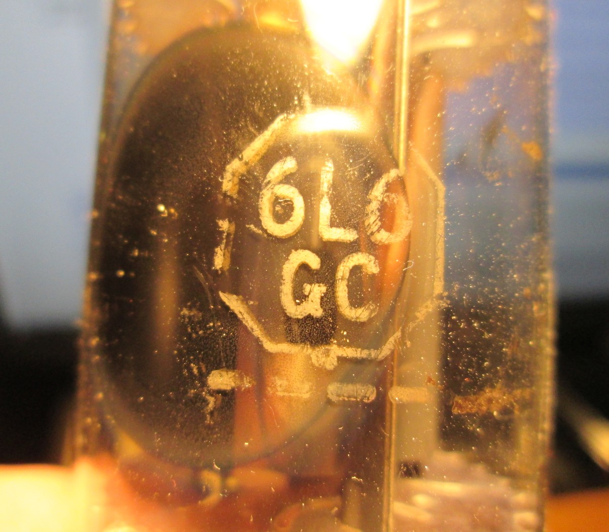

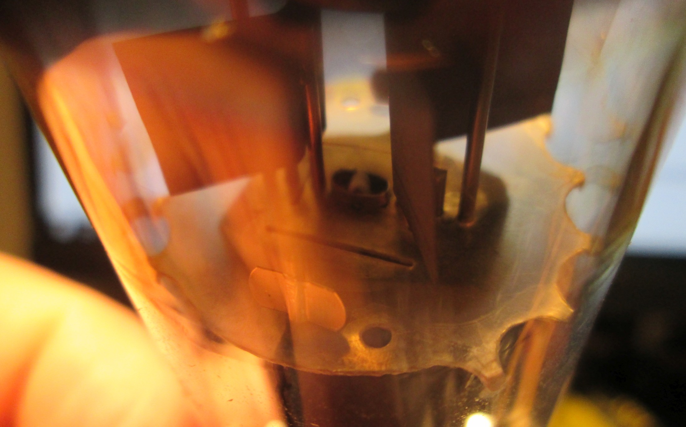

Second batch, RCA 6L6GC
The base has pins 1 and 6 omitted

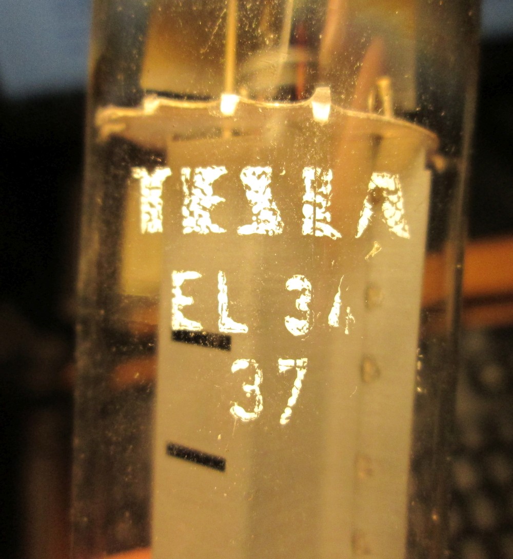

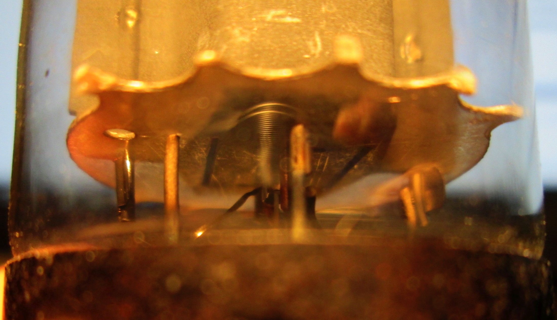

Last batch, Tesla EL34
I hope this is useful...

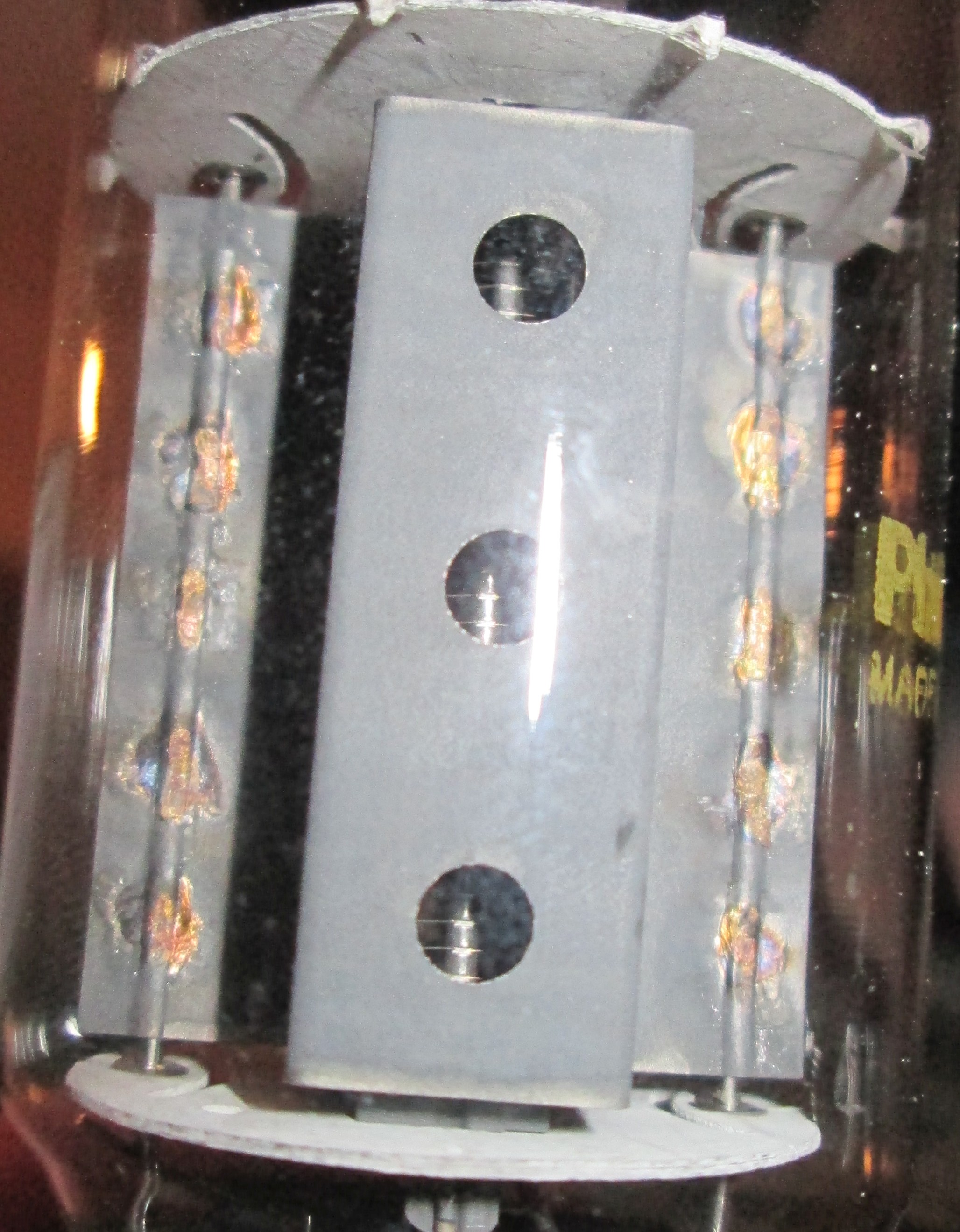

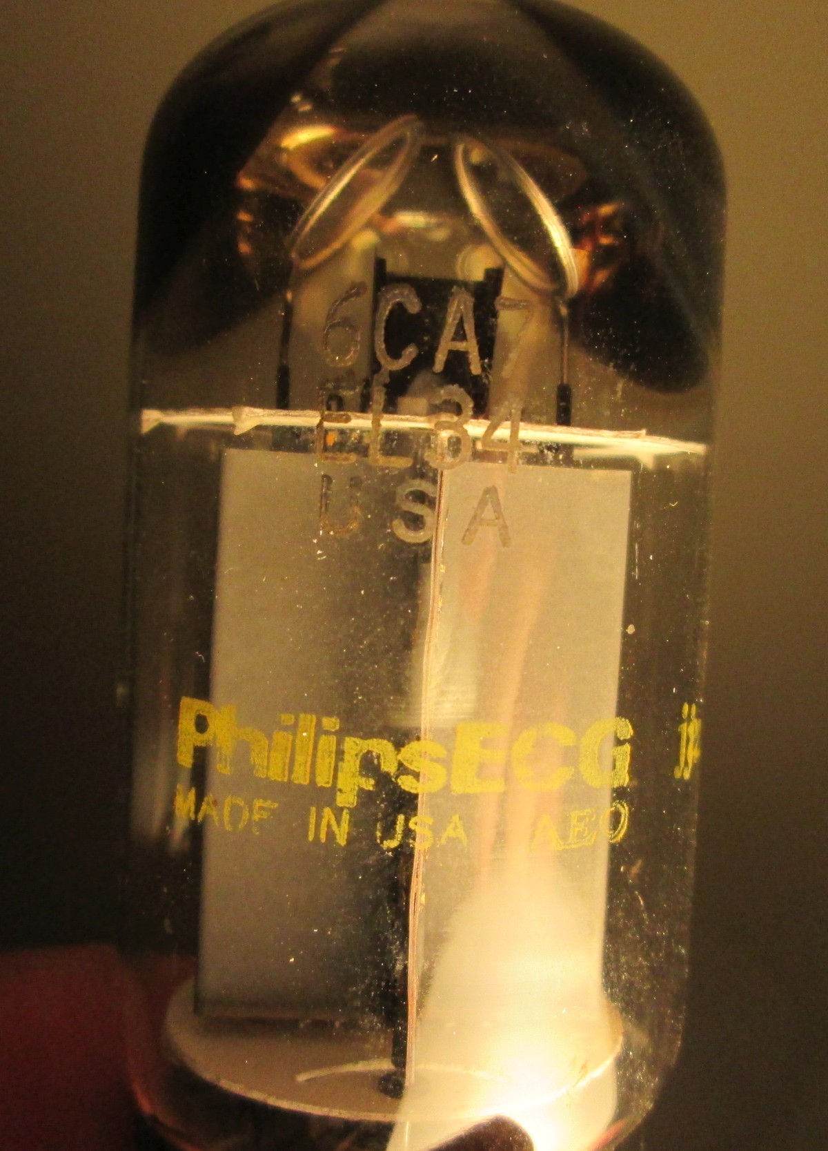

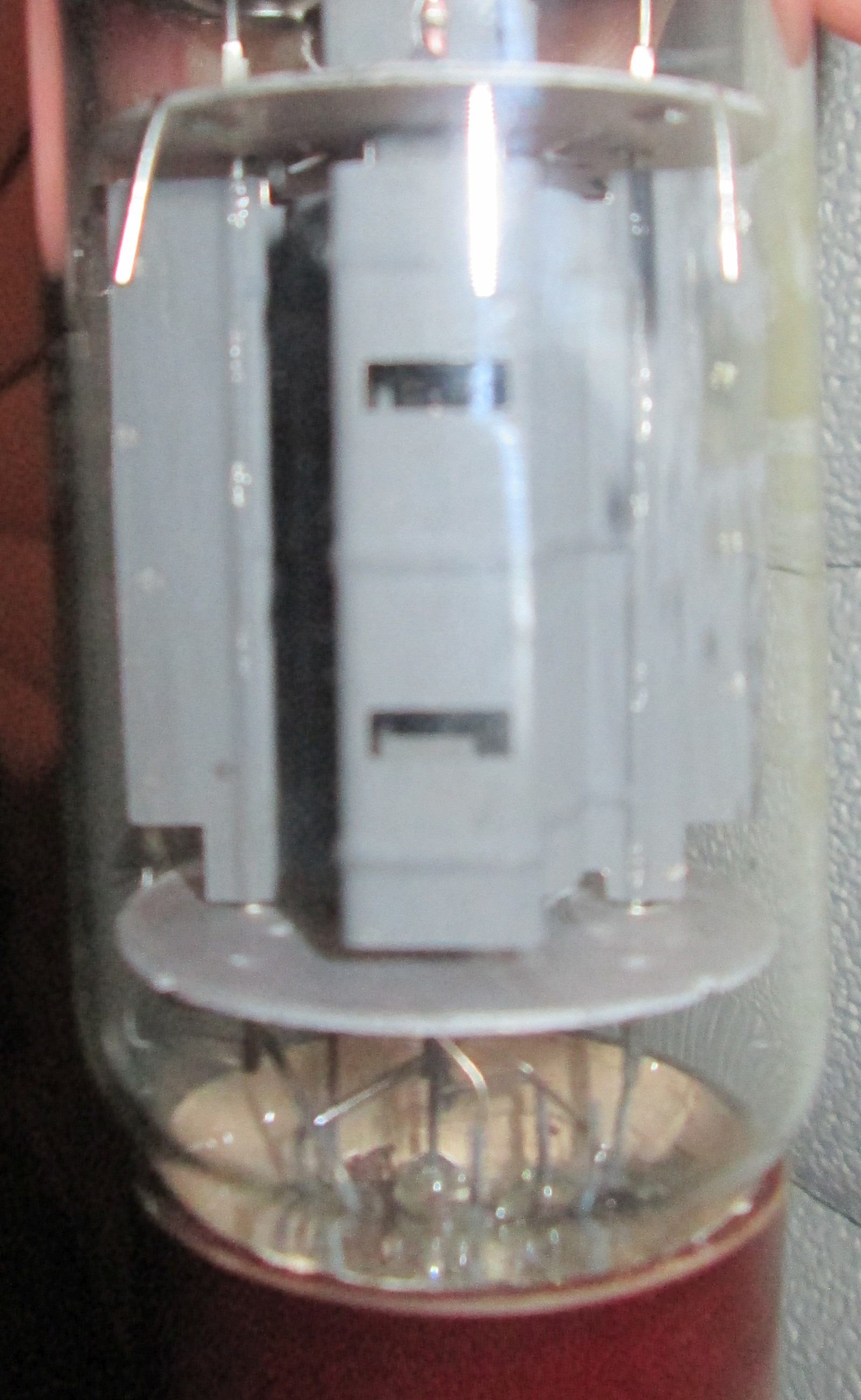

One more, a Philips ECG 6CA7 from the 1980s.
If I'm looking at this correctly, it's easy to see the coarse windings of the suppressor grid through the holes in the side of the stamped plate (anode). At least that's what I think I'm looking at (see attached photo 19_6CA7_SYL.jpg).
Aaaa-HAH!!

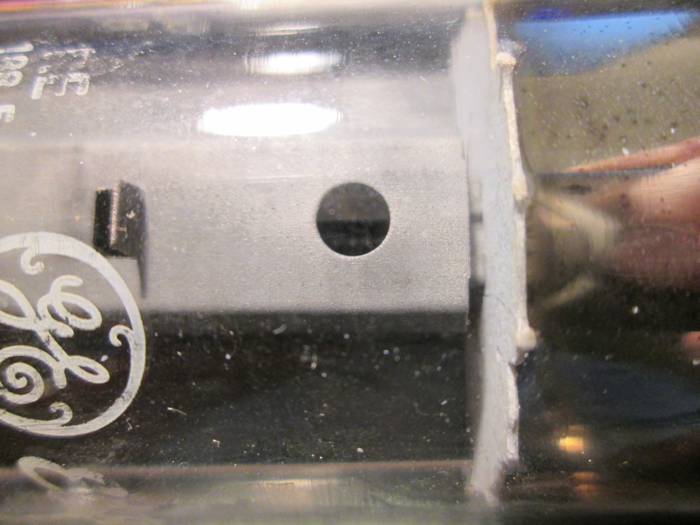

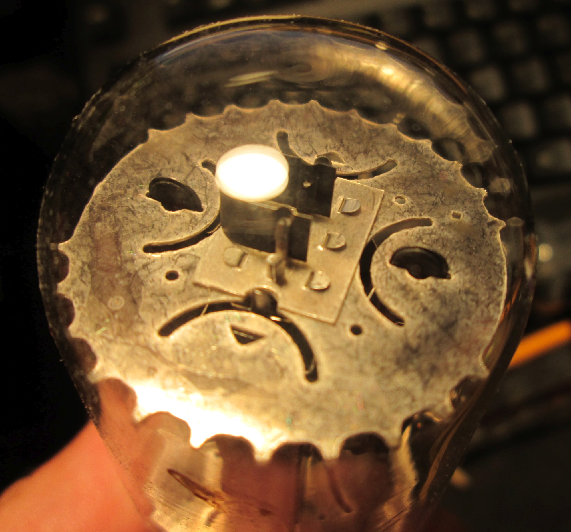

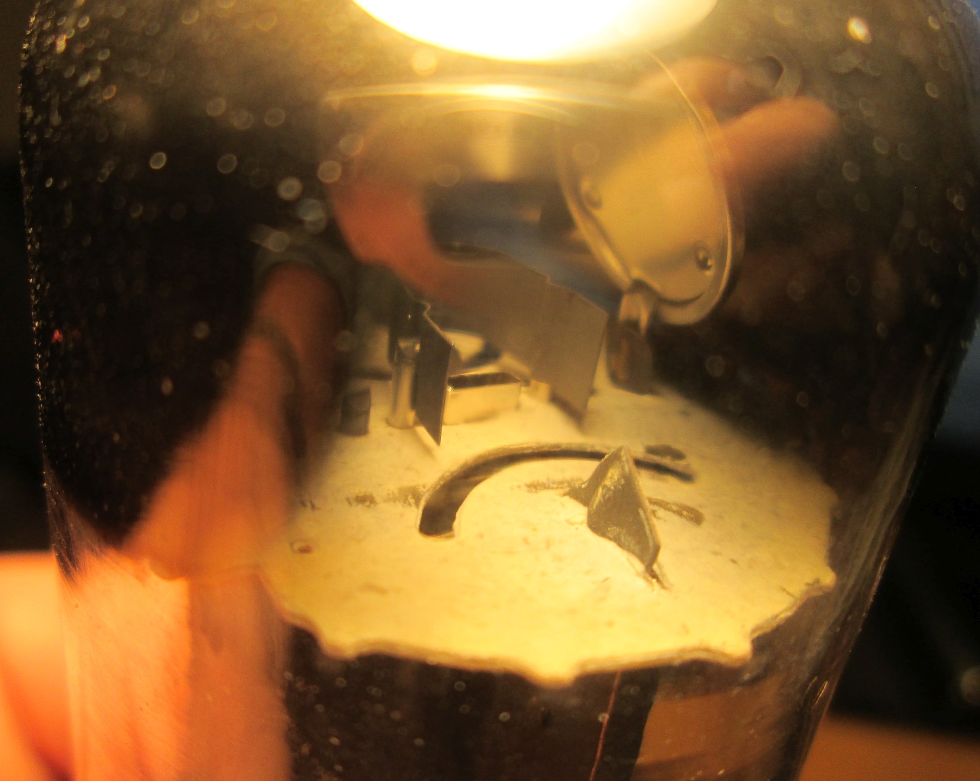

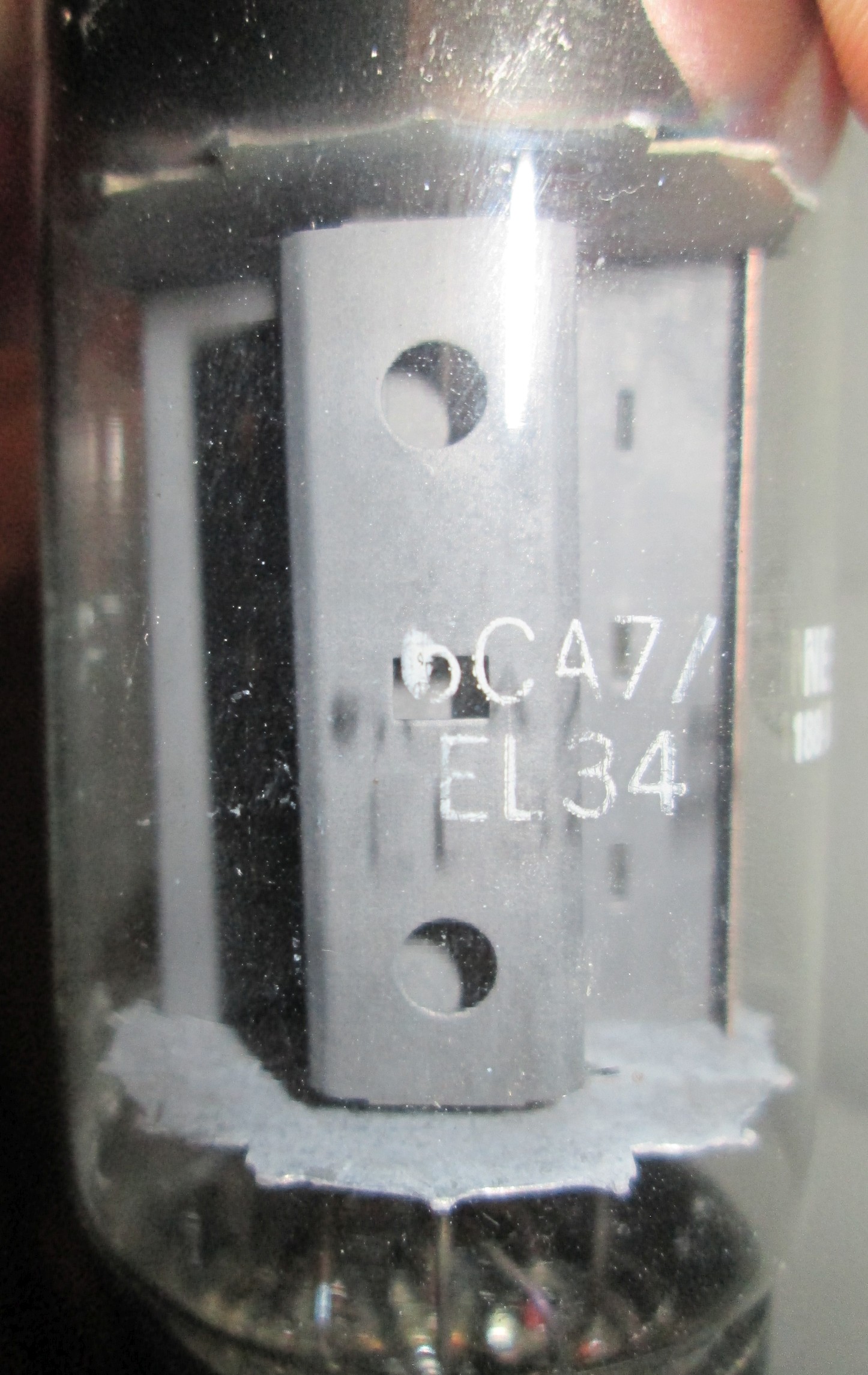

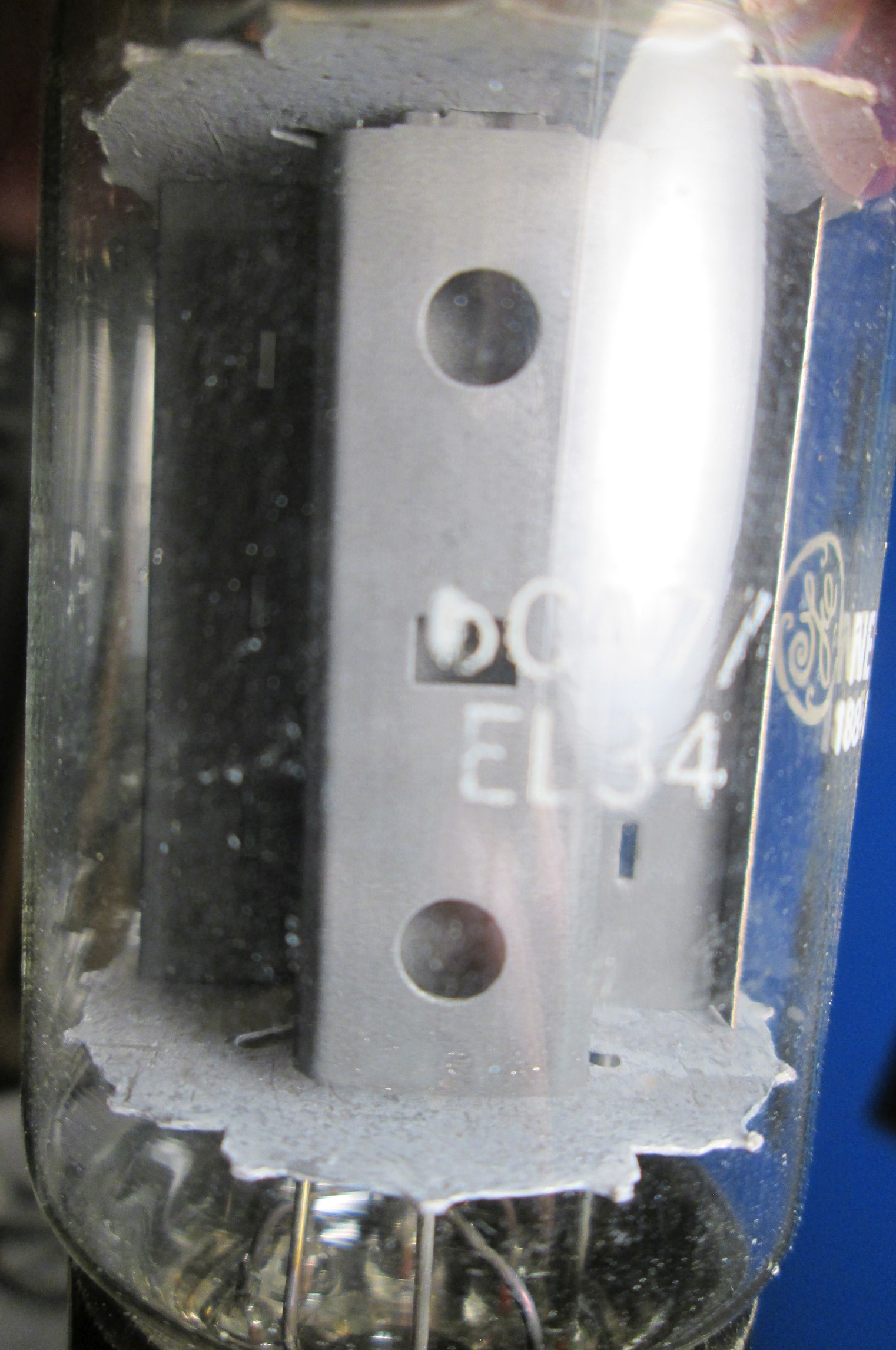

Here are a couple more photos of the GE 6CA7. Look inside the holes in the plate. You can't see a wound grid. You see another sheet of gray stamped metal. Isn't that a beam former? Take a look and tell me what you think...

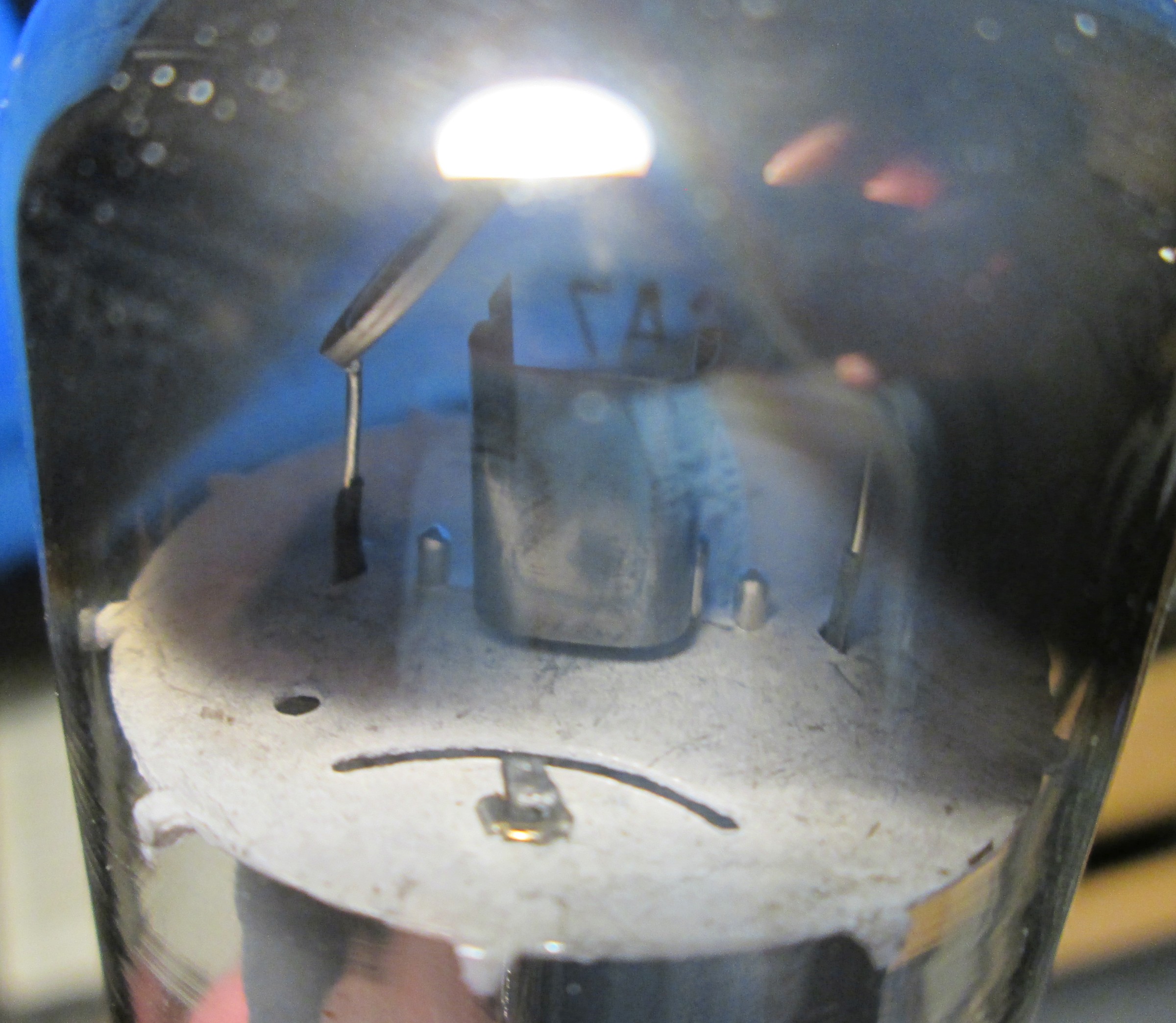

And take another look at the Tesla EL34. You can see inside the plates there's a coarsely wound grid, which I think is the suppressor grid (g3). Right?
Unless I'm mistaken, it appears the Philips/ECG (Sylvania) 6CA7 is indeed a power pentode, but the GE 6CA7 is a beam tetrode.

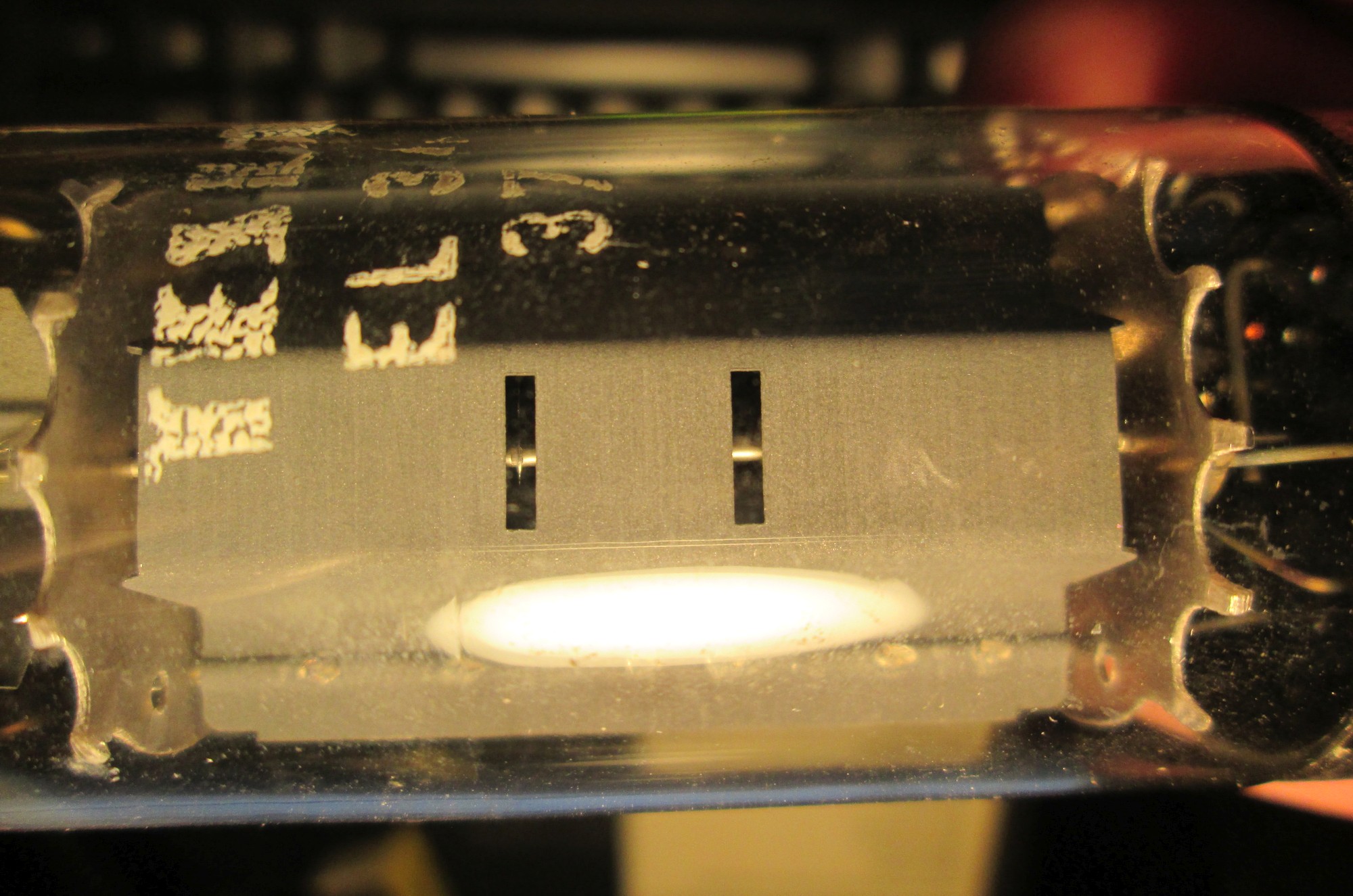

A couple more photos of beam tetrodes. The first two are of a New Sensor/Svetlana 6L6GC. The last one is of an old Chinese 6550A (branded Pro-Comm).
You can see the beam formers inside the plates. In a couple of the photos you can just make out the screen grids showing through square holes in the beam formers.
The Svetlana 6L6GC is missing pins 1 and 6.
The 6550A is missing pin 6 only.
Let me know if I've got this all wrong. I hope this is helpful...
