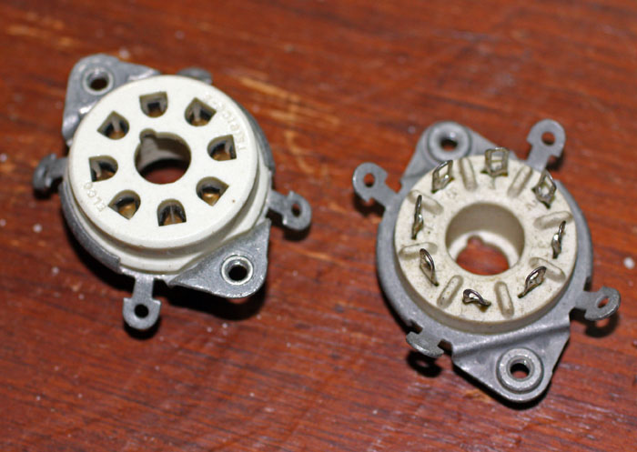

OK, I know you have received a lot of information, much of it conflicting, so let me put in my $.02: you are far better off with any NOS U.S. made socket than any ceramic Chinese made socket. The Chinese sockets are trash: weak mounting ears and cheesey contacts that weaken quickly and create intermittant noise.
Buy a good quality Korean Micalex before you buy a very poor quality ceramic.
Just for comparison here is a high quality ceramic NOS made in the US.
15 TUBE SOCKETS,AUDIO,RADIO,TUBES CERAMIC BASE WWII ERA - eBay (item 160369811956 end time Oct-21-09 10:56:05 PDT)
Sorry, I have already bought these; but the picture shows clearly the difference in quality.

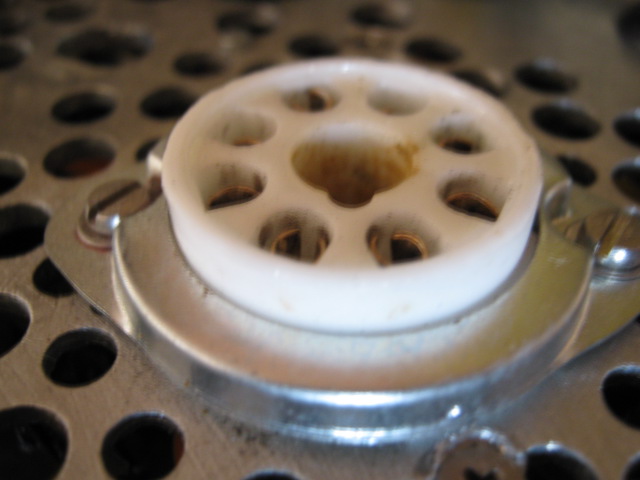

I bought a set of belton sockets for my Tubelab Simple SE but unfortunately the pin spacing didnt work with the pcb. I really liked the quality of those compared to the chinese sockets that I currently am using.Here is the Belton pic of an int oct. I find them sturdy and reliable. One can get them from

Yes, their PCB mount sockets are a little funny.
http://s69.photobucket.com/albums/i43/Ty_Bower/GetSetGo/Belton.jpg

For those not into Fender Guitar amps the main thing to look for in a socket for this amp is the contacts that grip the pins, not the insolation material as the tubes are mounted base up and hang from the socket, you don't want a loose fit.
ChrisA, Yes that is one of my concerns; holding the tube in snuggly as they hang upside down in these Fender amps & need contacts that will grip the pins like you say.
Well, it seems a few people seem happy with the Belton Micalex sockets, so I am leaning towards them. They look like decent sockets as long as they do hold the tube in tightly.
Ive been grabbing a variety of sockets of various materials for use in amps as aesthetics demand - these are a few observations....
I'm using the Belton sockets in my Kingfisher amp. The octal sockets have fork contacts (as opposed to sleeve contacts) with very good retention force. This I would think is important in a guitar amp, which is likely to see a lot of mechanical abuse and vibration. I've also seen Russian sockets with fork contacts at very reasonable prices, both in black phenolic and ceramic. Since you're replacing a socket that had some high voltage tracking issues, ceramic may be your best bet, as George has mentioned. I have both of these sockets in hand (Russian phenolic and ceramic octals), and the build quality looks good - not surprising, since they were most likely military issue. I used the Beltons in my Kingfisher, as I had both 9-pins and octals in matching colors, and the tubes are right there on the top of the amp (ah, aesthetics...). The Belton octal socket has built-in mounting flange, while the Russian octal sockets have a separate mounting ring that can be deployed for either above or under-chassis mounting - a nice feature, though the rings are easy to misplace.
The Belton 9-pin sockets are good quality with ok retention force. They have sleeve contacts, as do the majority of sockets this size. I've seen 9-pin sockets for auction that appear to have fork contacts, but I wouldn't swear to it. The Belton micalex body material is very hard and durable, and stands up to soldering heat with no sign of degradation. This appears to be better quality material than your run-of-the-mill brown phenolic, maybe not far short of ceramic. I don't know about the tracking resistance compared to ceramic, though I would bet that the Belton material is far superior to plain phenolic in tracking resistance (it may not even be phenolic - it feels harder).
You may also want to invest in some jaw-style tube retainers. The fork contacts grip the tube pins pretty tightly, but I don't know that I'd totally trust that by itself to hold an upside down tube in place. Also, heat resistance is important, as all the air heated by the tubes is wafted upward, bathing the tube bases and sockets.
Buy the Belton sockets, which are made of Micalex.
Don't bother with ebay
Gotta agree there: leave the good ones for me.
