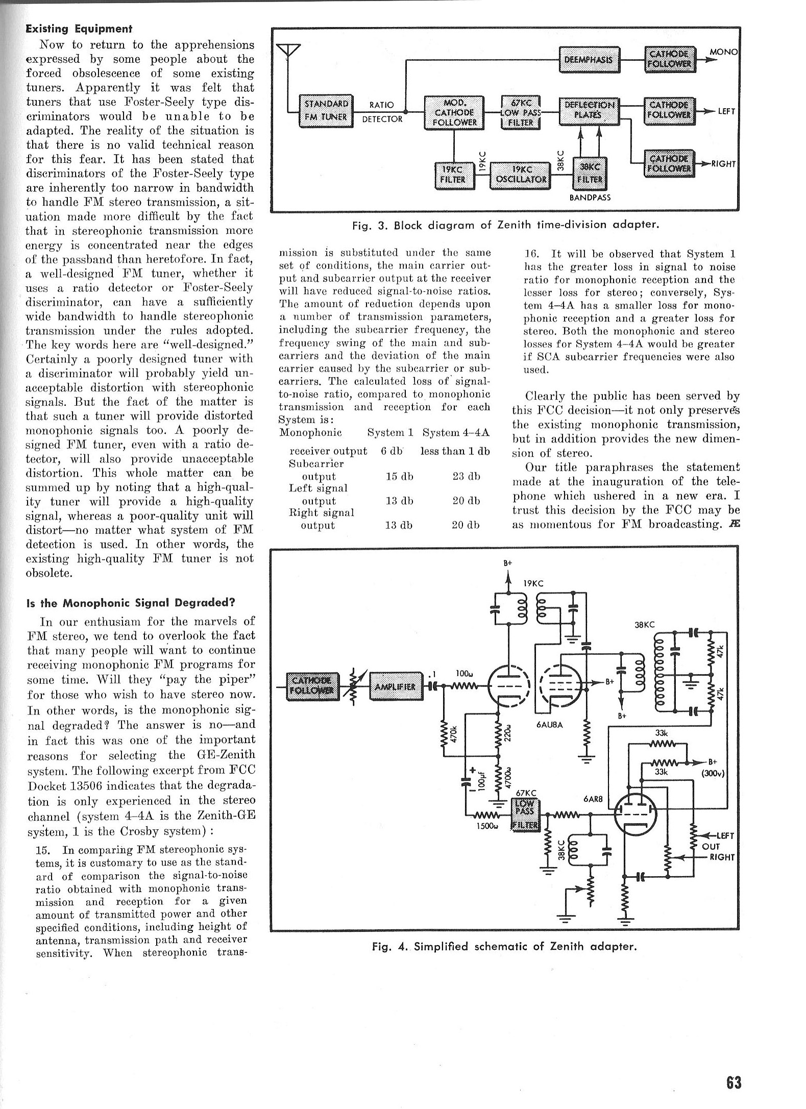

There is a multiplex decoder described in RCA receiving tube manual, I have edition RC-30, it is on page 686, it use one 12AX7 and one 6CL8.
There are also the HH Scott 335, the McIntosh MA6, and the decoders from the Dynaco FM3 and the later Fishers themselves to consider. All easy builds except the ones that require precision inductors.

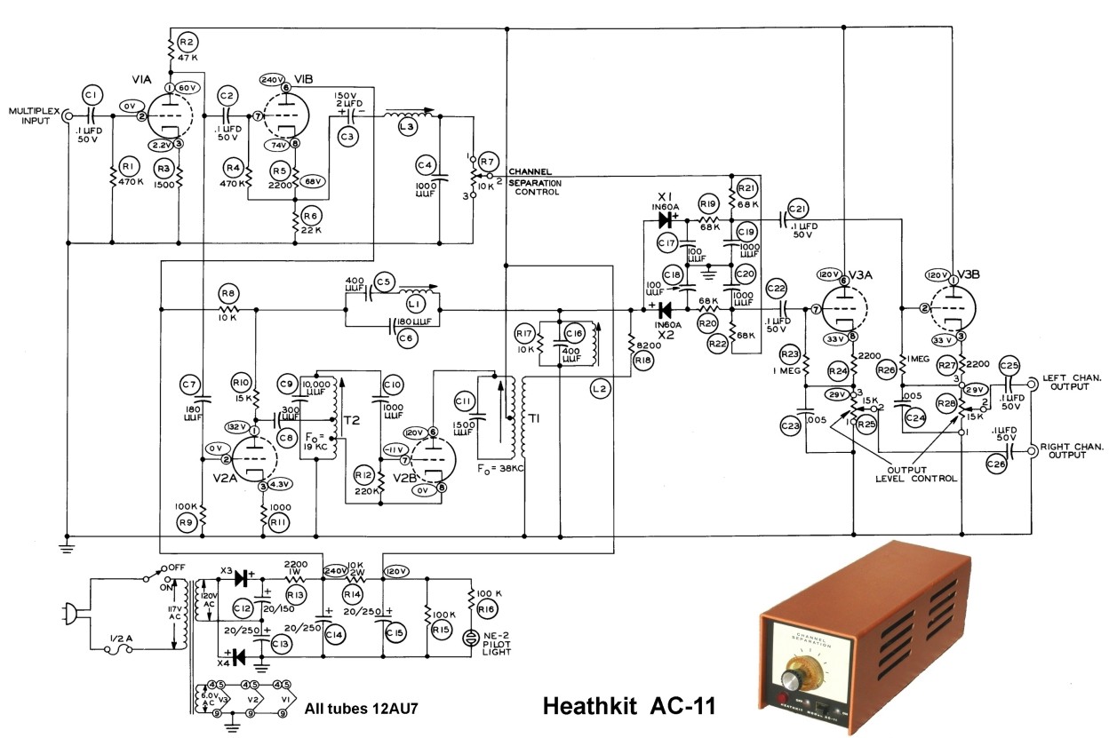

Mr. Turner provides this circuit that also uses SS diodes.
A 6AL5 might substitute for the SS diodes in either frequency doubler. A 6JU8 quad diode might substitute for the SS diodes in Turner's ring demodulator.

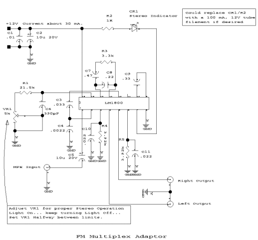

If 100% tubed is not essential and SS is acceptable, I strongly recommend DIYer extraordinaire S. Bench's IC based design. That setup is "idiot resistant" and a successful conclusion of the project is quite likely.

Or Bob Fitzgerald's LM4500-based decider at FM MPX Adapter. I've built about 18 of these for various valve and SS tuners. They are great. And the price is right too.

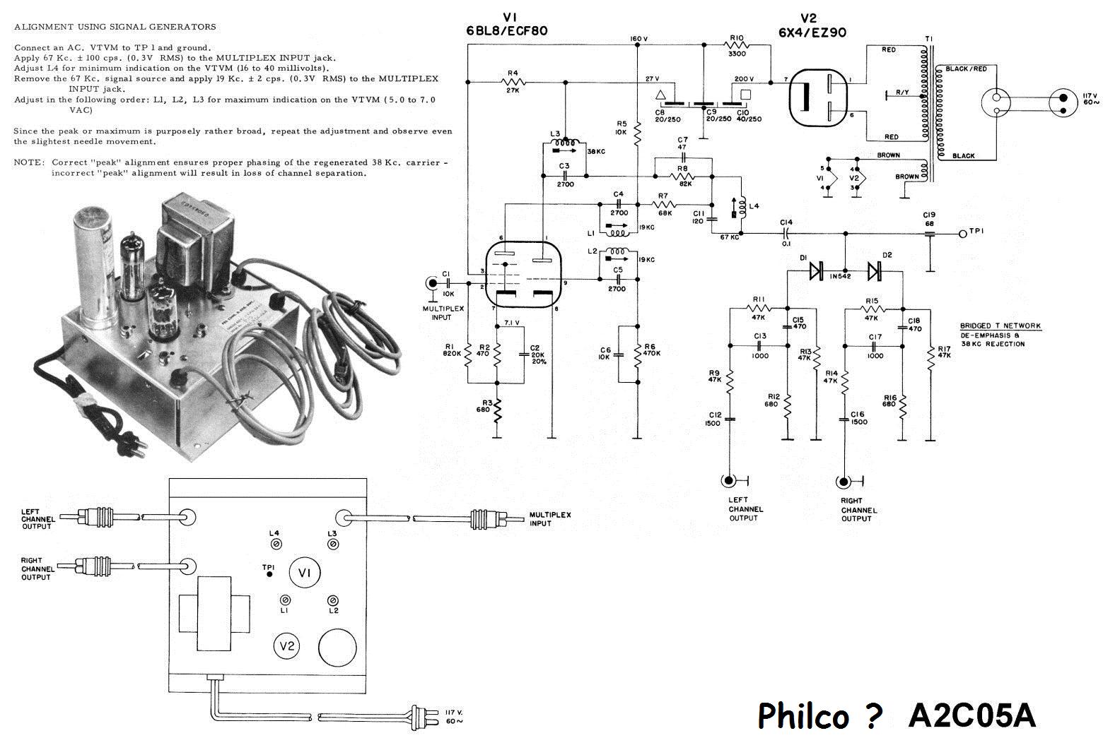

The resonant frequency of any circuit is given at least for the Philco unit. So basically one could calculate the inductances values and proceed. But we have no clue where the tap is in L3?

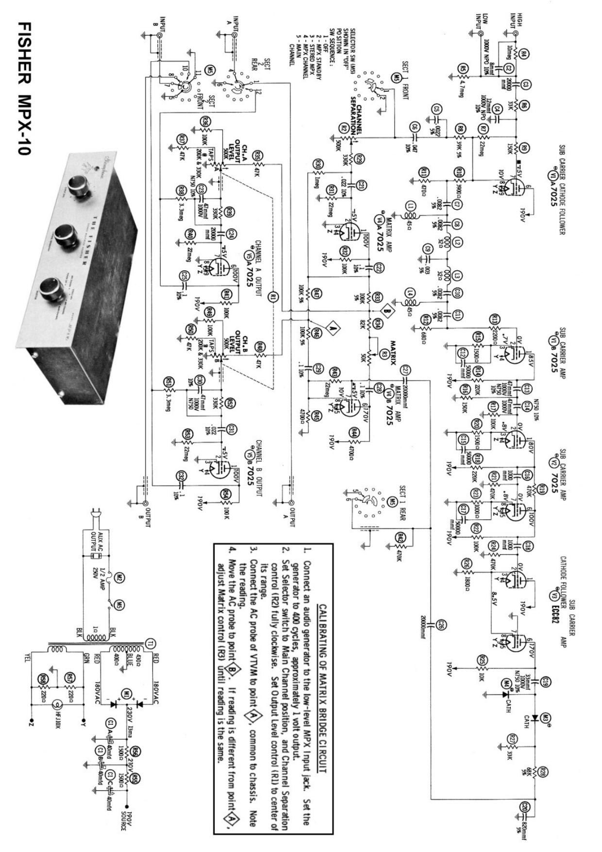

Or maybe this Fisher MPX-10 (with a Roddam detector). It only uses four RF chockes of which both the resistance and the inductance is mentioned.
Still two solid state diodes (beside the two in the power supply), so not 100% tubes.

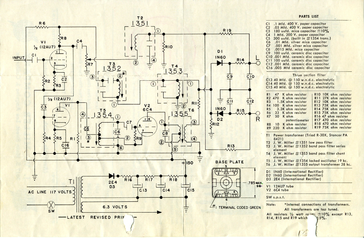

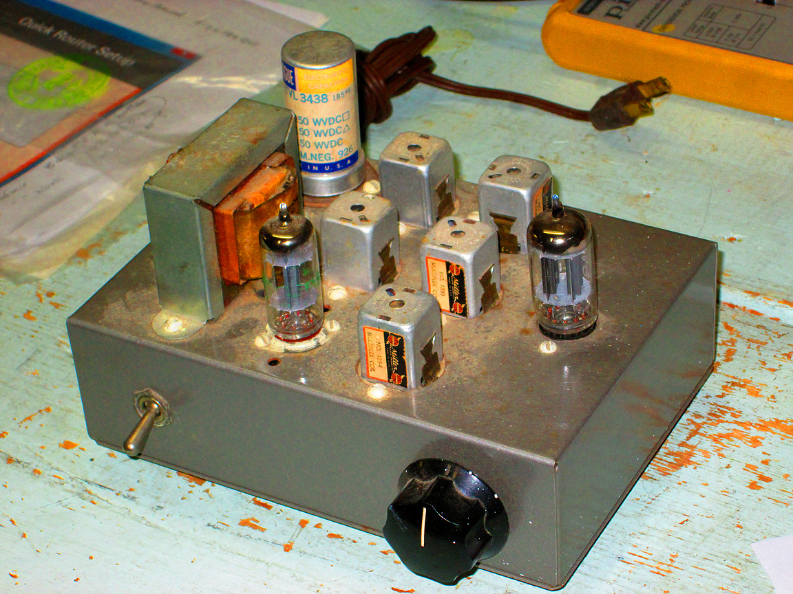

Miller MX Adapter Built From Their Coil Kit
The Miller coil kit was on the market not long after the MX standard was approved. This is my build, might be around 1962. The PT & chassis are Hammond. The adapter was used with an EICO HFT 90 FM receiver till 1977 when I bought a Sansui TU717 receiver & the matching AU 717 amplifier.🙂

The Fisher MPX-10 and MPX-20 work with the Crosby FM MPX stereo standard which was not selected by the FCC in the USA so they do not work with any modern FM tuner. They are basically museum pieces.Or maybe this Fisher MPX-10 (with a Roddam detector). It only uses four RF chockes of which both the resistance and the inductance is mentioned.
