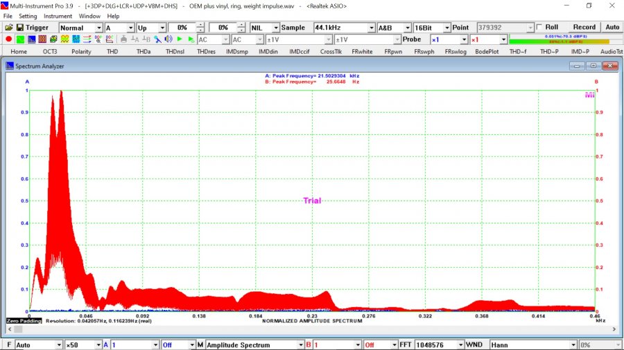

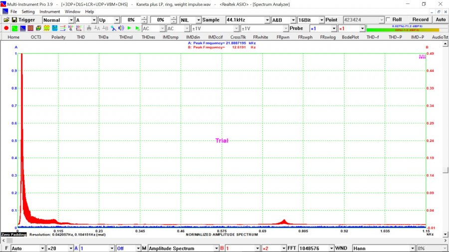

These are impulse tests of an SP10mk2. Test was done with an old LP on the platter with the stylus resting on the stationary LP and marble dropped from 300mm above the LP.
IMO you can't over damp a TT when we are talking about vibration damping. Any unwanted excitation will smear the signal. What these tests and my experimentation with various platters for the SP10 show is as platter thickness increases, specifically the POMC SQ improves. POMC has similar acoustic Z to rigid vinyl so coupling the LP the POMC platter increases the platters ability to sink stylus/LP interface vibrations away from the stylus. The thicker POMC provides greater vibration attenuation before the wave hits the bottom of the platter and is reflected back to the LP.

The first is the OEM platter / mat and the second is a stainless steel platter with 16mm POMC bolted to the top.

Interesting measurements, thanks for sharing. Some people seem to like the sound of their records with condiments on top - go figure.These are impulse tests of an SP10mk2. Test was done with an old LP on the platter with the stylus resting on the stationary LP and marble dropped from 300mm above the LP.
No problem, Bon and I did a lot of R&D on SP10 platters to improve the TT. What we found was POMC (Acetal) in thicknesses of at least 20mm ontop of the platter improved the micro detail in the music significantly. The impulse response confirms what we both heard.
