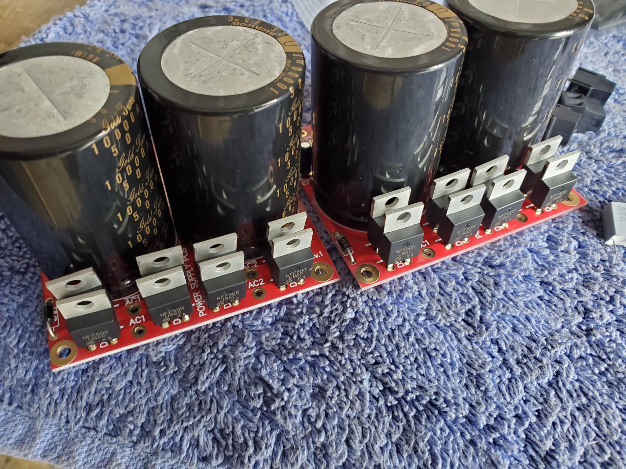

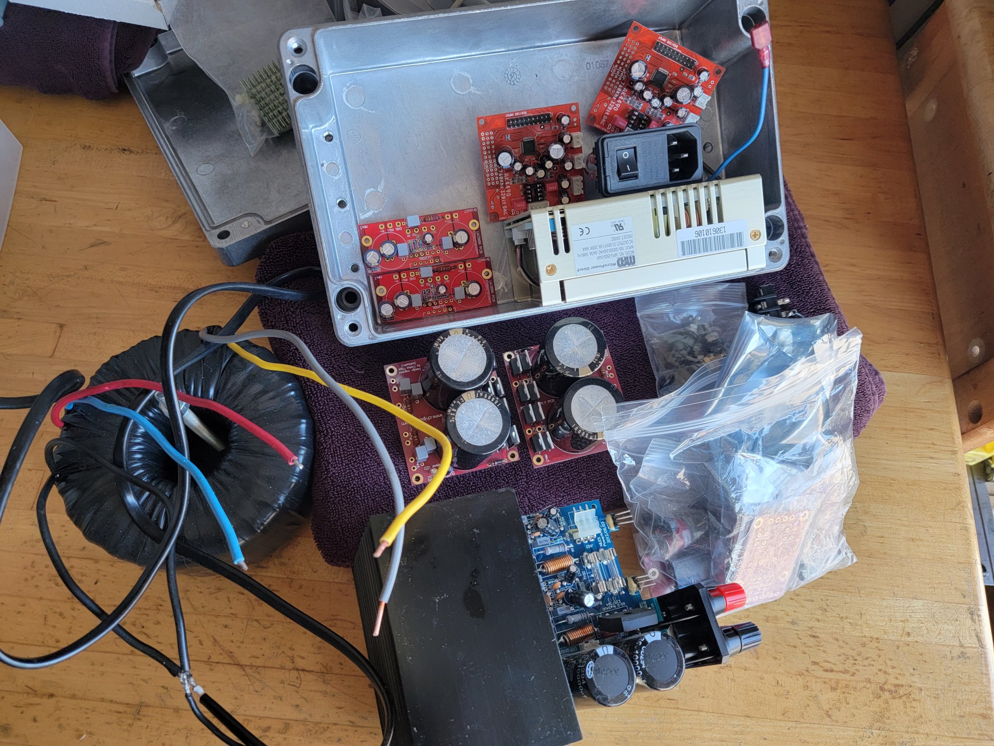

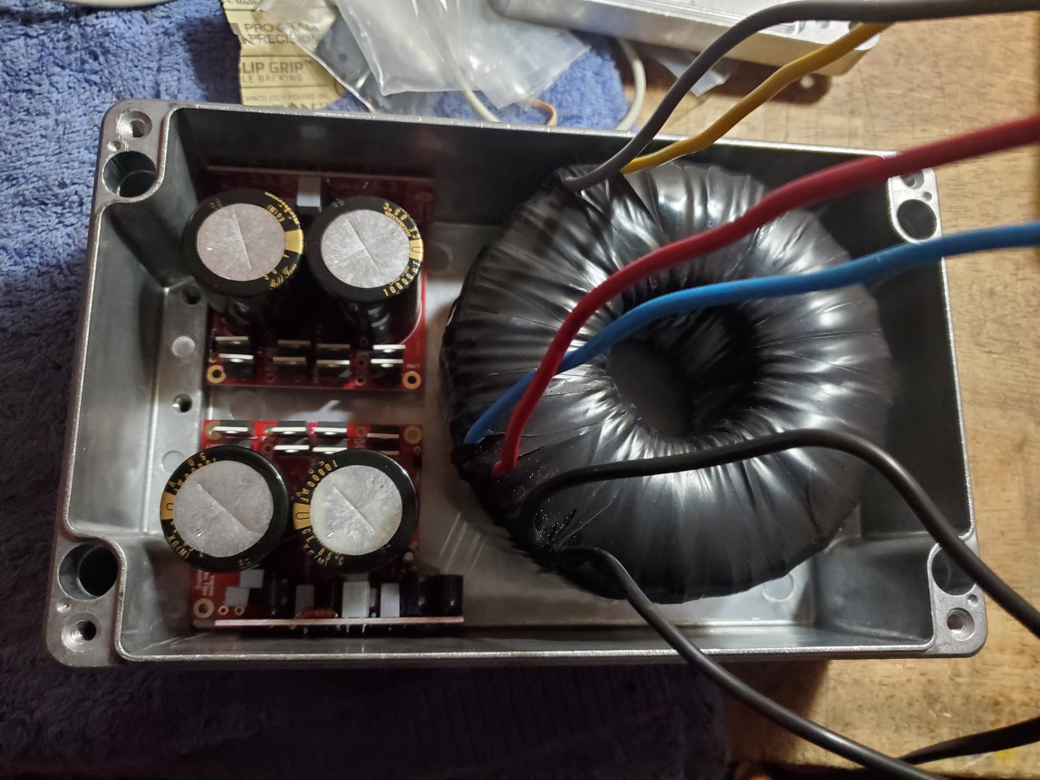

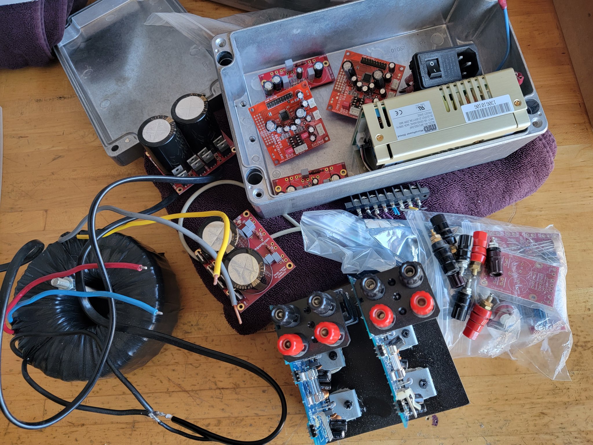

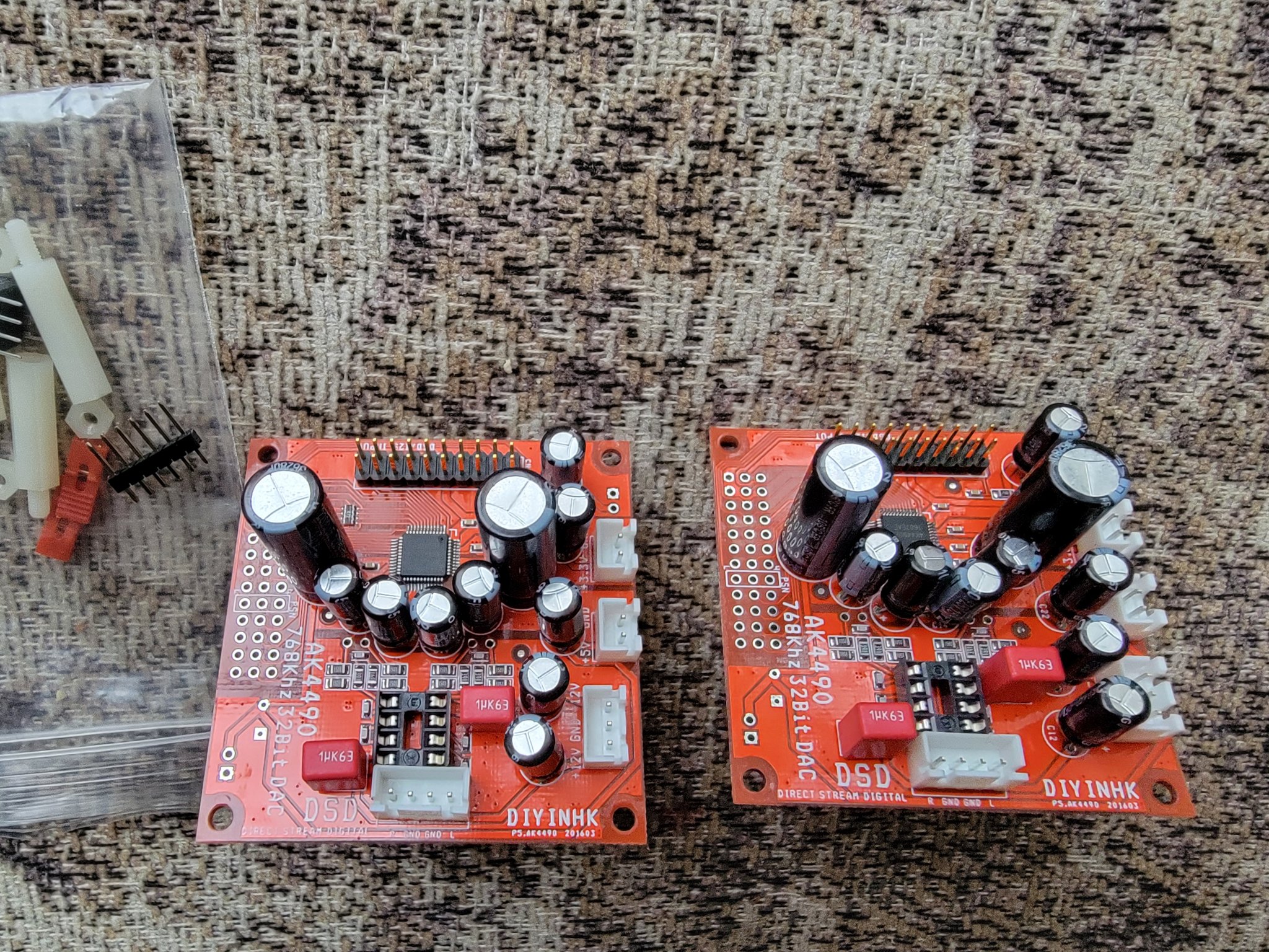

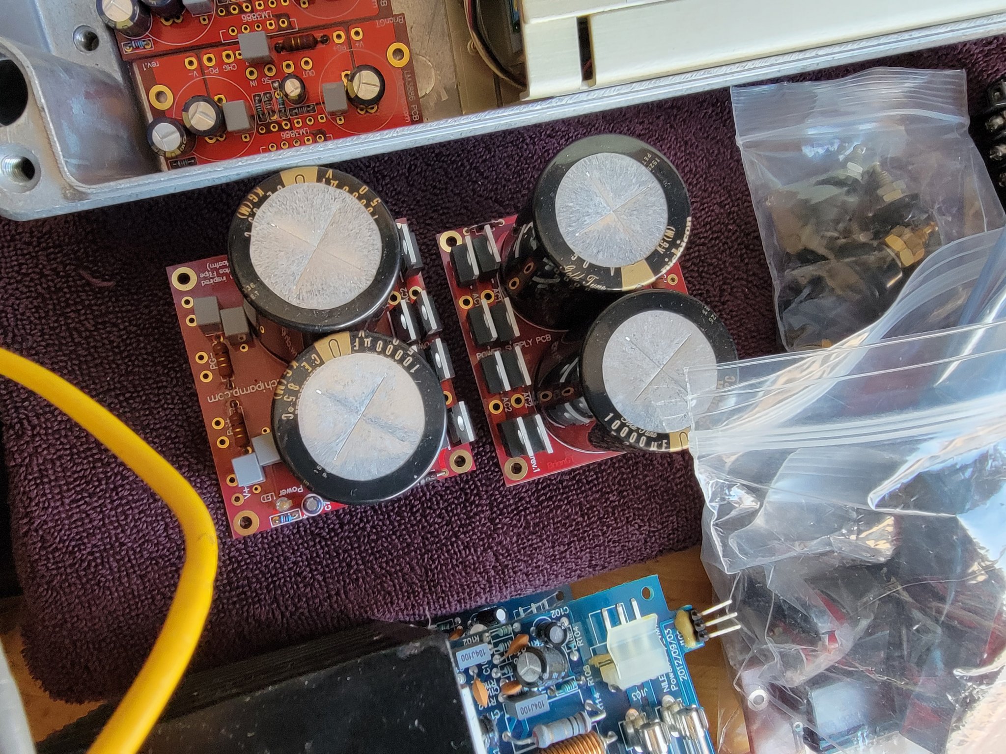

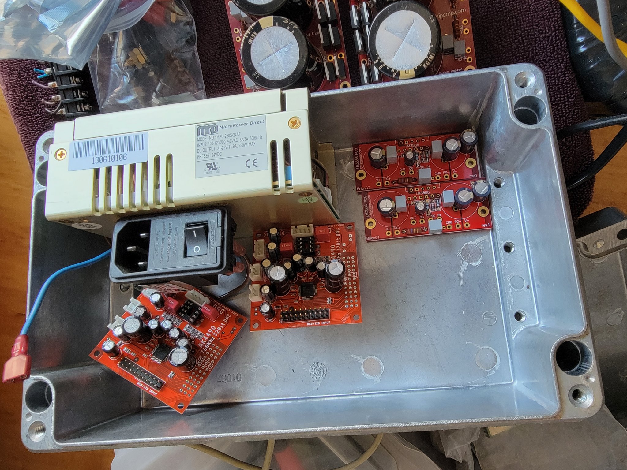

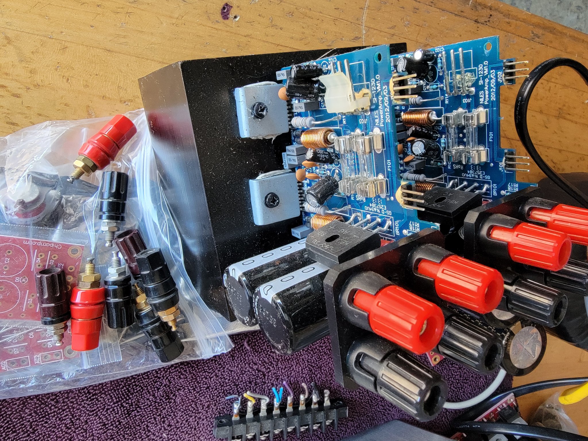

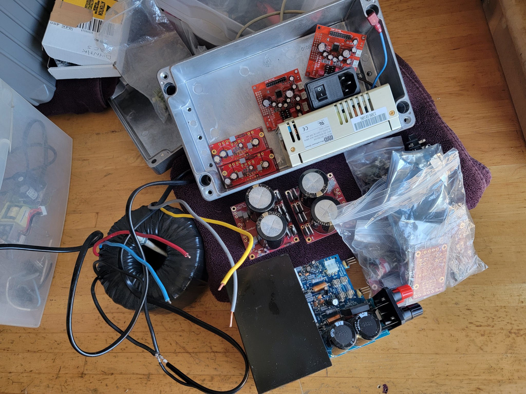

Having a hard time with the DAC.
I guess I need an IS2 board? Then optical input plug?
I can handle putting the LM3886 amp together, might even get it in the case I have with the MD power supply.
The DAC I'm having a hard time figuring out what I need to get it together.
And it seems getting a DAC into a case with an amp is going to be hard.
ALSO, can I control the volume from my TV if using optical output?
Does optical output have much better sound quality than headphone output?

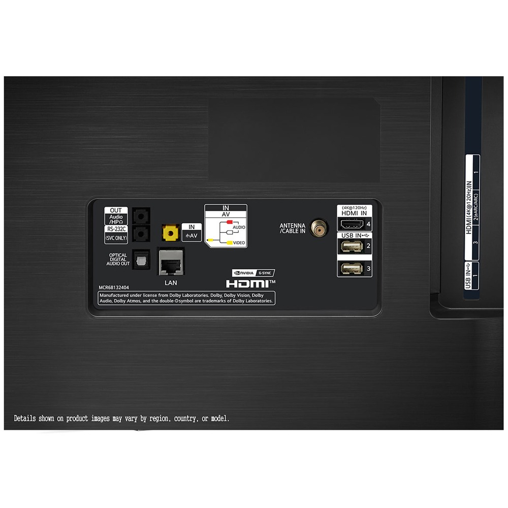

TV usually has Youtube, Netflix, Hulu etc playing.
Even music is from youtube.
Sounds like I might as well stick to headphone output, especially since I can control the volume with the TV remote.
Family turns off my amp/speakers and uses TV speakers if they have to mess with different remotes or amp controls.
Will optical out be much better than headphone output?
TV is -- LG OLED65CXPUA Alexa Built-in CX 65-inch 4K Smart OLED TV (2020 Model)
https://www.amazon.com/LG-OLED65CXPUA-Alexa-Built-Ultra/dp/B0817H41YN
Use headphone out into your amp. Everything will works nice and clean, and tv remote will control amp volume. Check both levels (tv headphone out and amp) to get minimal hiss.

Agreed, the headphone output is simpler. As for the quality, check the audio settings in the TV and adjust for the best sound. They usually have several things like tone controls, compression or dynamic range limiters, simulated surround sound, etc, that can affect the sound a lot. Some experimentation required.
On the other hand, the optical output has no processing since it's intended to feed an AV receiver / sound system.
