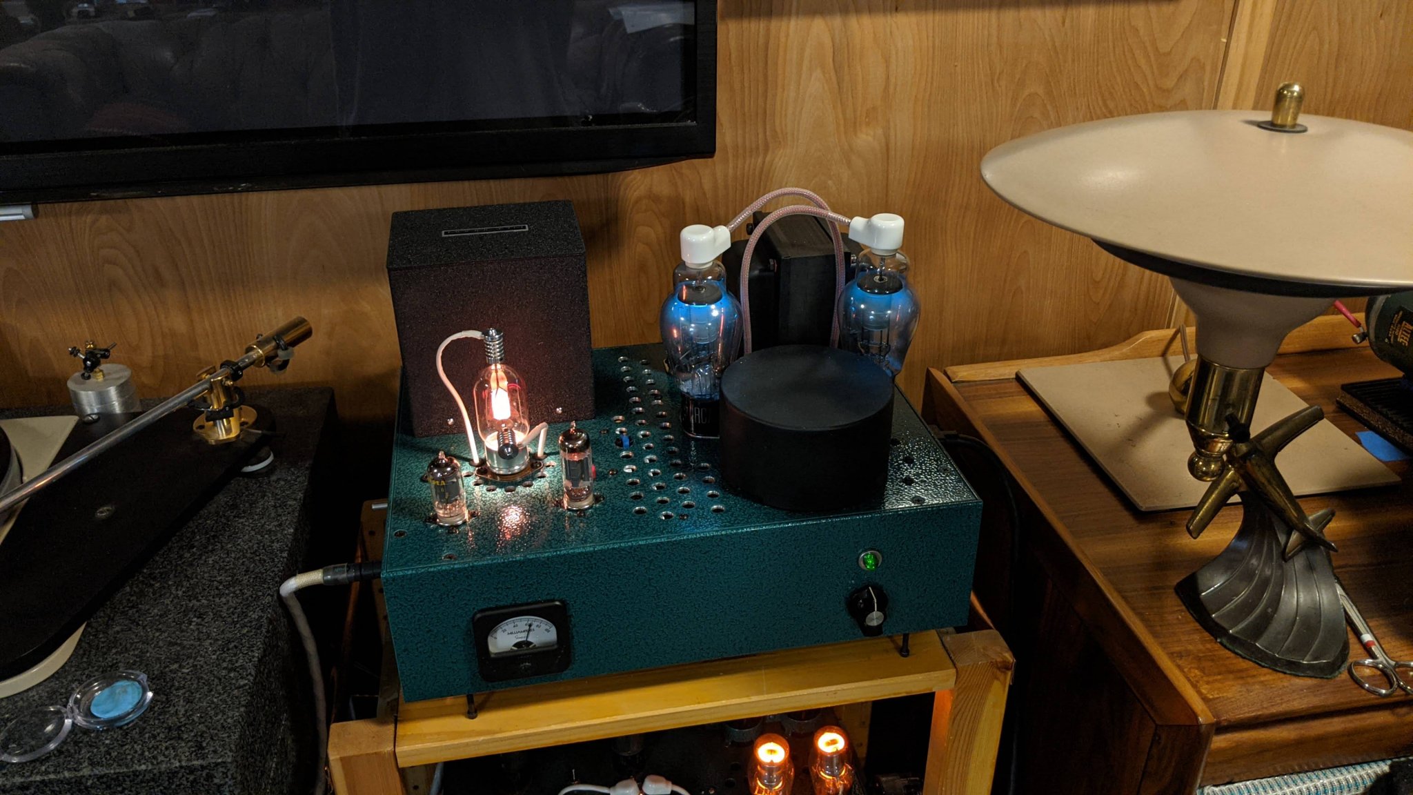

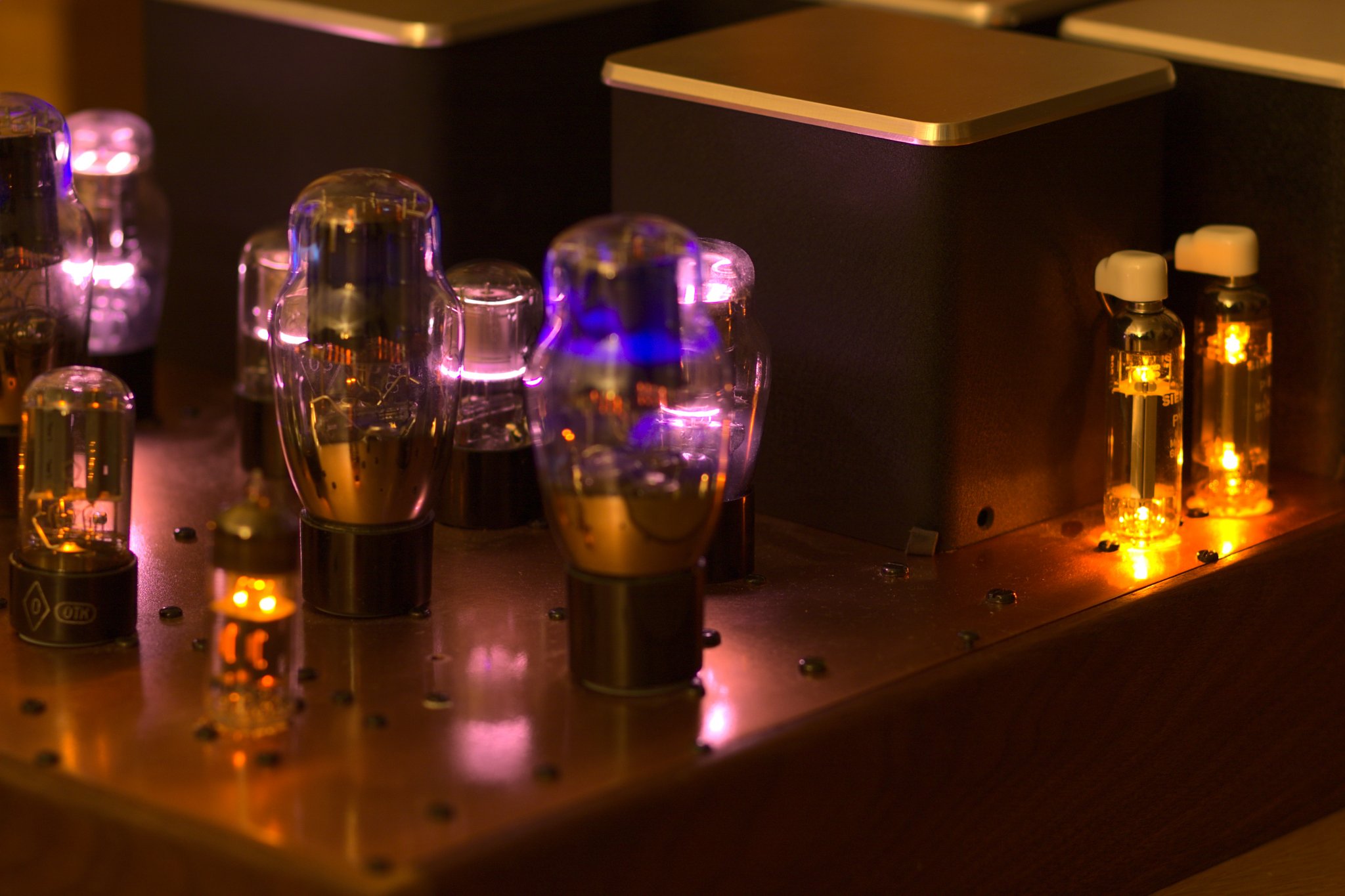

I recently built a 3C24 amp with 866A MV tubes. I used a separate filament transformer for them that comes on when the mains power is switched on. Forty five seconds later an Amperite normally open tube relay closes and energizes the power transformer. Works nicely and was simple. I tried using the relay to switch the B+ but got more arcing than I was comfortable with.

All the UV dangers are overblown, the glass blocks all of it. Thats why UV lamps are made of quartz - it allows the UV to pass.
Shoot, I just sold 4 816's as I like the larger bottle of the 866A or 866AX.
wow, they sure look nice dont they!Shoot, I just sold 4 816's as I like the larger bottle of the 866A or 866AX.View attachment 1060740
