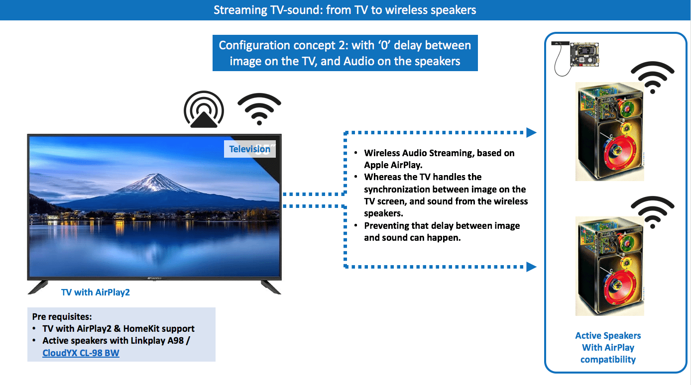

Update: Scenario 2 > TV sound via AirPlay to AirPlay speakers
In the meantime, I found more information for this use case. I learned that the issue of wireless audio from a TV/video source to wireless speakers, does not exist between the 'Apple TV 4K' box and AirPlay compatible speakers.
The Apple TV 4k box is of course handling both video and audio. But in this case it is able to drive wireless AirPlay speakers AND have the video and audio synchronized (lip-sync). So there actually is NO delay.
This could mean, that TV's that are Apple AirPlay2 compatible, might give me the solution. So far, I have found a lot of
there are a lot of TV’s which are AirPlay2 compatible. But until now I only found models able to stream content from iPhone/iPad to the TV. So not to the other side; stream audio from the TV to AirPlay speakers.
This made me think of creating the following setup (see picture below).
Question
So this is what I am looking for; which TV is capable to function as an Apple TV box / capable of connecting to AirPlay speakers for sound output?
- TV with AirPlay2 compatibility
- Speakers with integrated LinkPlay A98 module
Question

It’s not. Maybe you missed my question:
Question
Apple won't produce TVs anytime soon so the Apple TV box is your best bet probably as it performs exactly the way you desire. You'll be caught in the Apple ecosystem as a side effect. I sure would not want to rely on Airplay 2 on a non Apple device as it likely (assumption) won't have high priority on the feature/bug/update list.

Apple does license AirPlay, and many TV manufacturers have already implemented AirPlay2.
The issue is that AirPlay2 implementations exist in two versions:
a) streaming iPhone/iPad content to the TV.
b) streaming audio from a TV to AirPlay speakers.
I am looking for televisions with b).
