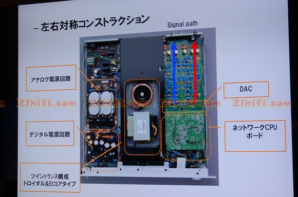

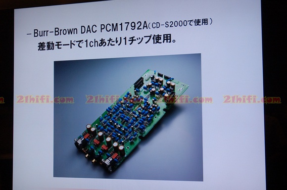

This DLNA network player from Yamaha is equipped with TI's PCM1792A (PCM1792) and otherwise also equipped with top quality components.
Like by various cd player models also by this multimedia player here is much space for tuning steps (e. g. implement/replace additional PCB's and parts) to enhance additional the sonic performnce.
Examples are a very low jitter master clock oscillator like that one from LC audio technology (XO3, X03) or Trichord so as optimized I/U (I/V) converter.
L C Audio Technology / LClock XO3
Trichord Clock Mods
http://www.diyaudio.com/forums/digital-line-level/34324-best-opamp-i-v-conversion-dac.html
http://www.diyaudio.com/forums/digi...-best-output-i-v-transformer-pcm1704-dac.html
Are there already experiences and test results?
