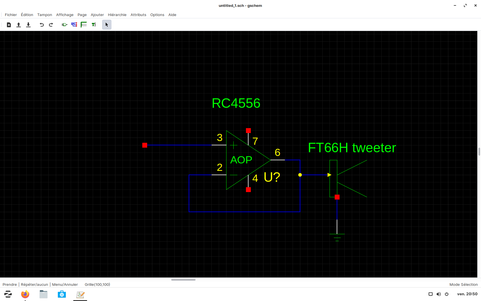

Choose a high yield tweeter like FT66H FOSTEX https://www.fostexinternational.com/docs/speaker_components/pdf/ft66hrev.pdf and drive it with RC4556 built in unity gain follower. Unity gain amplifier or voltage follower in a voltage divider
RC4556 Datasheet PDF ( Pinout ) - High Output Current Dual Operational Amplifier
a FT66H tweeter needs only 100 mV at full sound level and RC4556 can drive 8 Ohm at 100 mV level.
I = U/R = 100mV/8Ohm = 12 mA and the limit is 70 mA.
