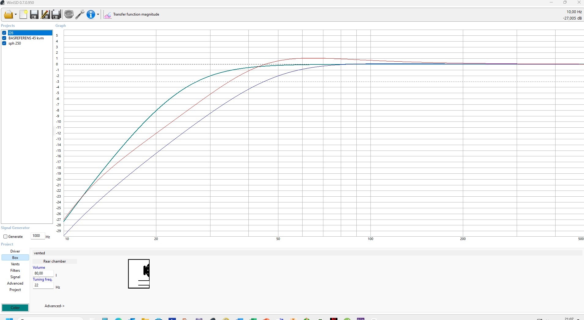

Thank you for your response.
3 liters for Scan-speak 12MU-8731T00 cabinet is what I have thinked.
The total volume will be 80 liters bass reflex, It will be a rather voluminous speaker (I love deep bass).
My actual Monacor SPH250KE is inside a 74 liters box bass reflex, but the new box I would like to make it a higher so with more volume.
The simulations I did with BassBox with the new box show greater extension in the lower frequencies with Seas L26RFX/P on 80 liters bass reflex box.
I prefer to use a single woofer inside a large box that is easier to design.
I don't know the distance between the speaker and the wall, because they are going to a new house that I don't know yet.
However, I don't think I will have enough space to put them very far from the wall.
I confess I am quite satisfied with the speakers I have, in fact I would like to design something similar but of better quality.
Actual ---------------------------------------------------> New project
Box Size internal 26x91x32 (cm) ------------------------> Box Size internal 26x100x32 (cm)
Woofer: Monacor SPH250KE (single) -------------------> Woofer: Seas L26RFX/P (single)
Midrange Visaton DSM 50 FFL --------------------------> Midrange Scan-speak 12MU-8731T00
Tweeter: Visaton KE25SC --------------------------------> Tweeter: ????? Morel Supreme ST 1048, BlieSMa T34A-4 Dome , or else ???
Crossover Cut: 600 Hz / 4000 Hz -----------------------> Crossover Cut: 300 Hz / 2500 Hz
This is my actual idea.

Made a simulation of your SPH 250 KE in a 74 liter bass reflex box and L26RFX/P in planned 80 liter bass reflex box.
As you can see you will get approx. 3-4 dB higher bass amplitude in your new speaker compared to your current.
Are you prepared for that?
For a quite flat response in your listening room you need a 80 m2 room, but since linearity don't seems to be your goal, but massiv and deep bass which you will get in a smaller room.
Green curve = L26RFX
Red curve = SPH 250 KE
Blue curve = My target curve for a flat amplitude response down too 20 Hz when the speaker are placed in a 45 m2 big room.
If you place your new speaker in a 45m2 room you will get a 6-8 dB peak at 10-40Hz.
You will not miss bass for sure, but it might be blurred and give a soft tone to all bass notes.

You have right to all.
Probably the woofer L26RFX, is not the right choice for what I looking for.
Can you please suggest me a good woofer that work good on 80 liters box in bass reflex (better than my SPH 250 KE) ? (around 300 Euros)
And at this point must be I need to cut it at 600 Hz like my actual speakers.

What you think about the woofer:
Scan-Speak Revelator 26W/8861T00 inside a 80 liters bass reflex
used with 12MU-8731T00 and cutted at 600 Hz ?
