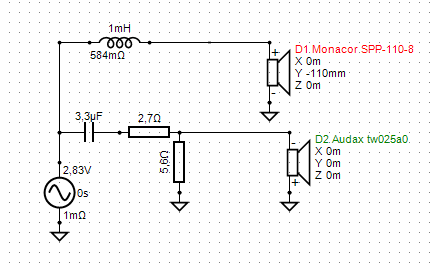

I do not know the Ciare but I own a mini speaker with the tw25a0 and a friend of mine has built and sold a lot of two-ways with it back in the '90s. They have a very neutral sound and you can listen to it for hours as they are not harsh at all.
@shadowplay62 do you know the details of crossover of those speaker? What is the woofer used for that speaker?
This is my mini speaker: note that I do not know the value of the coil because it was assembled some 30 years ago and I have never modified it, and it's still working.

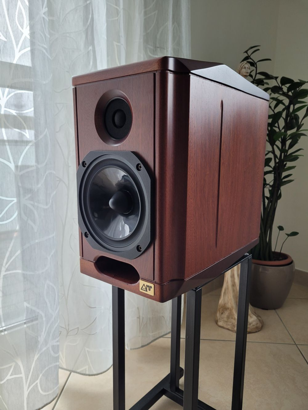

The other one was a real beauty with some interisting solutions: the tw has a kind of WG and is "isolated" from the cabinet by a layer of neoprene and is mounted without screws by means of a lock that presses the tw against the cabinet.
The woofer is a discontinued Audax HM170X0 (TPX cone with inverted surround), IMO the best 6,5" MW in that time.
The filter is similar to my mini speaker (as the designer is the same person...) but the woofer had a zobel to linearise the impedance.
The pic is taken from a website and is not mine.

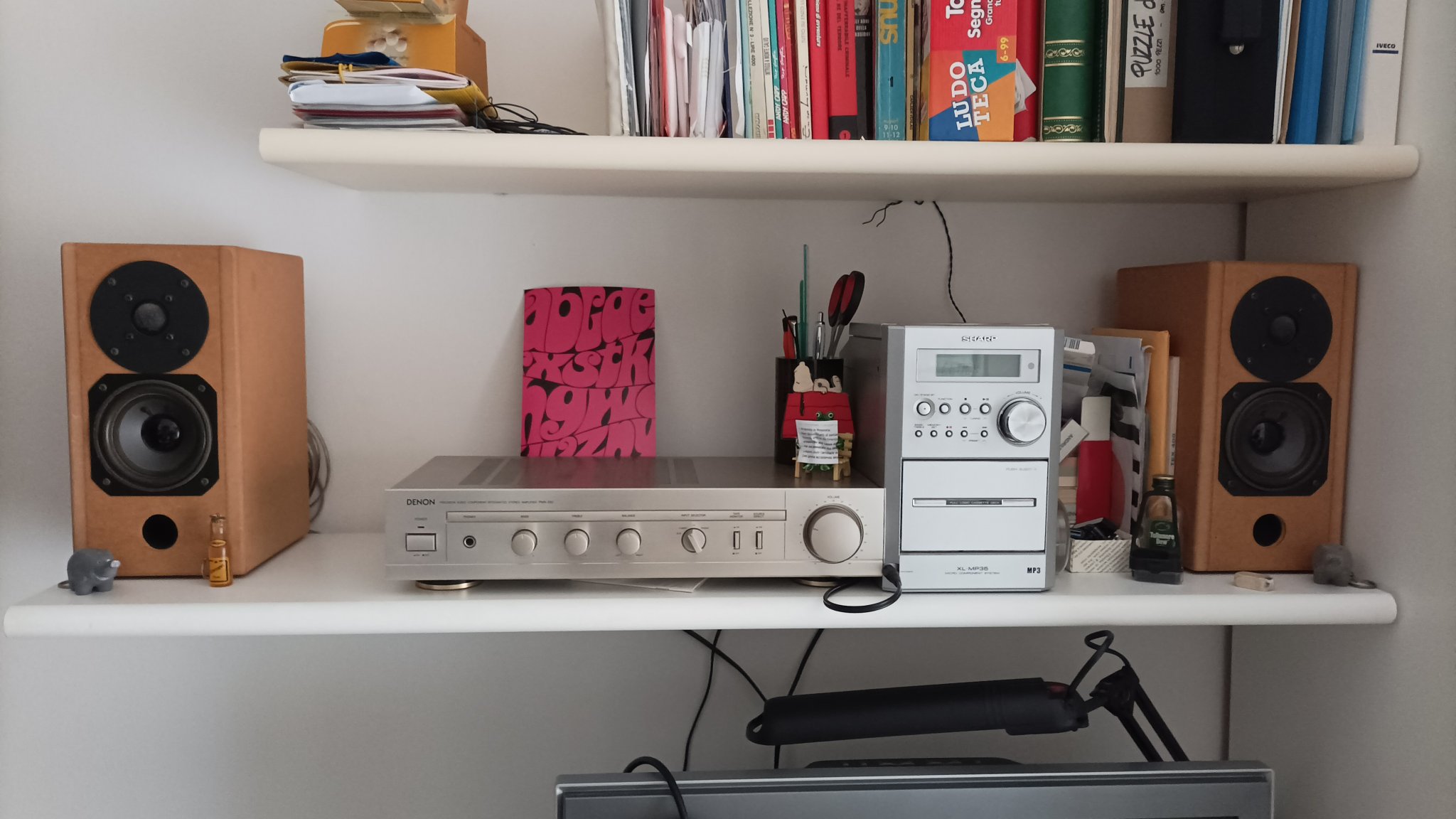

You mentioned in crossover design "Monacor" ~4,5inch woofer - are your speakers different to the Audax ones?
Yes, I use them with my computer/phone and a 20W Denon amp. A tiny 5L BR.
