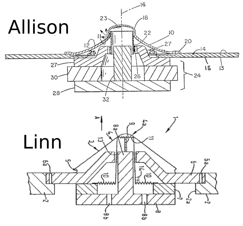

Linn "tweeter" is fundamentally different from Allison tweeter. A far as I can see, Linn tweeter has rigid inverted cone - not good for a high-frequency dispersion. Allison tweeter has flexible concave diaphragm around the 1/2" convex dome.

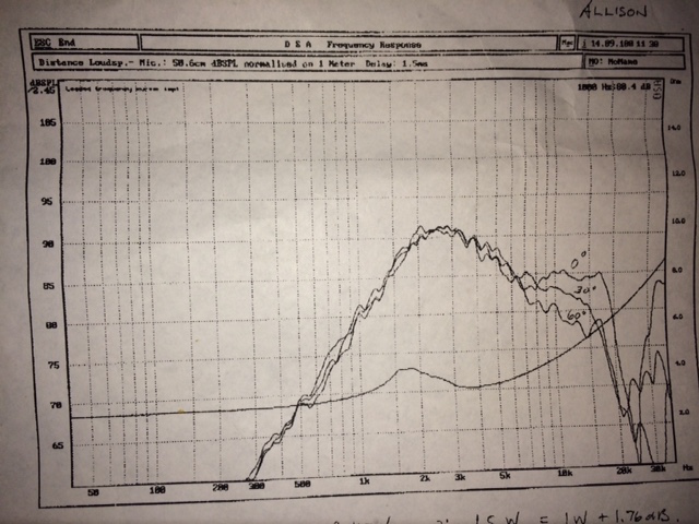

Many years back, a certain hi fi journalist and I had a long back and forth about the Allison tweeter on the r.a.o. newsgroup. He had to be the most loyal Allison groupie ever and claimed that the Allison tweeter was perfect. I think he and Roy were personal friends. Mind you, this was when the tweeter design was about 35 yrs old. So basically, according to this journalist, all the following efforts of the best Scandinavian engineers were for nought, because Roy Allison had perfected the tweeter, and everybody else was building inferior designs. At the time I was working for SEAS, and found this a rather bold claim. So I managed to get a pair of Allison tweeters (these were for the 2 ways, the only difference being that Allison put some silicone grease in the gaps, apparently to damp the larger excursions), and I sent them to Norway for evaluation. The response graph (which I'm amazed I still have) is shown below. We checked 2 units to make sure this wasn't an anomaly, and Roy Allison did confirm that the measurements were fairly representative. It indeed has wide dispersion at the top end above 10kHz. Certainly wider than a 1" or 3/4" dome. However, the overall response just makes it to 20kHz on axis. The overall response is also obviously not flat and therefore requires crossover compensation. Taking that into account, the on axis sensitivity is really very low. The impedance curve is also very ragged, indicating a lot of small resonances present in the moving system. And compared with a modern tweeter, a sine sweep sounds pretty "hashy". IMO, the design is a pretty mixed bag, once again confirming that there's no free lunch in driver design.
Well, all we need actually is to see a patent drawing from post #10 for a Linn tweeter: 3 is a inverted cone and 5 obviously is a flexible half-roll surround. Logicaly, flexible surround goes together with a rigid cone. Simply as that. I wouldn't even bother to read the Linn patent to verify this.@Sonce: without at least knowning the Youngs Modulus and Poissons ratio of the diaphragm material it is -unfortunately- near impossible to make any valid statement about the radiating properties of so called "rigid" materials. FEM is necessary to do it all in detail and with some accuracy.

Thank you for a very interesting graph and associated comments.
Looking at the SPL graph and the cross-section drawing of the Allison, I would not be surprised if it would appear from e.g. laser interferometry or similar measurements, the cone like assembly moves pistonic to about 6 kHz, and then is decoupled and the sort-of-dome/dustcap on top of the vc takes over.
But then again, this is only guesswork.
Eelco
