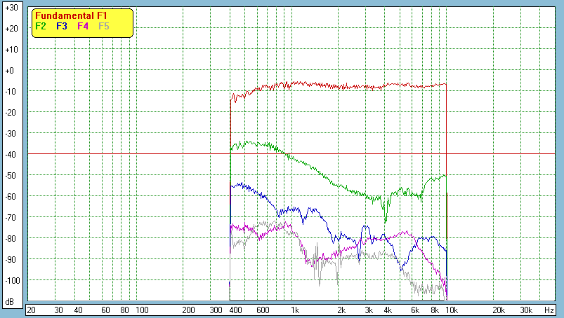

I just came across this tweeter. What caught my eye was a Fs of 425Hz!!! Looking at the frequency response, I noticed, the freq response is pretty much flat until 500Hz.
http://www.scan-speak.dk/datasheet/pdf/d3004-602010.pdf
I was wondering what your opinion would be about running this speaker crossed really low, say about 700Hz.

1" tweeters generally won't go below a ~ 1.5KHz x/o point without
serious excursion capability issues, and not many will go that low
(independent of Fs) without serious distortion issues, some do.
The scan-speak rolls off below 2KHz, it not flat to 500Hz.
The highish Qts levels off the roll-off around Fs.
rgds, sreten.

I concur with Sreten's comments. No circa 1" or 1-1/8" dome tweeter has enough volume displacement (Sd*Xmax) to cross over below 1kHz. As he mentions, even with a crossover point of 1.5kHz some will sound strained.

Looks like it doesn't settle down till 1100 Hz. I would think this value the absolute lowest I'd take this one...

If you go active, you can get around the wiggly impedance curve towards the bottom end of the useful range. You probably could use these down to Fs, or even below, but you'll get serious SPL limitations. I've a pair of 4" FR drivers that'll go to 40Hz sealed, but only just go loud enough for desktop listening.
So, compromise. If you'll only ever use them at your desk, you might be fine. Forget the occasional party, though - they'll never survive.

Hi, And the point of the post ? I can't see any, rgds, sreten.
Clearly not a tweeter you'd want to x/o much below 2KHz, with 0.25mm Xmax.

I think based on the frequency response curve by djk, it will go down to 700 Hz at -1 or 2 dB. As a normally full range guy, I would say it is still called flat....
However, I do agree with your thoughts on the xmax. I have tried crossing a tangband over at 1 KHz which has a fs of 700Hz and it sounds great. I find playing your mids with a tweeter sounds different from your woofer. Has a very airy quality about it.

I think I didn't make myself clear, why I posed this question. I am actually more of a full range guy and I have owned quite a few full range drivers from 2"to 15".
If you are a full range guy (allright so maybe a FAST), what you really want is a light cone and a powerful motor. In many ways, that is what a tweeter is. So now the question, I am trying to answer is, if you push the tweeter low, and if the tweeter is designed so it can handle it, can you make the mids sound better than a full range. For that to work, you should try and avoid the Fs, which in most tweeters happen at 1KHz. But off the late there has been tweeters that have Fs of 400Hz, Which could mean, we can now cross it lower than what was previously possible. If I get one that is really cheap, I could even make a line array....
I have been reveiwing a few drivers lately. The wavecor looks really interesting. It is 30mm driver with a xmax of +/- 0.4mm, And pretty much flat all the way to 500Hz. Most tweeters would only go 1KHz and a xmax of +/-0.2mm. At about $70, it could be worth a fun try... I get it that it won't go loud, but say, if you have 4pcs.....

Also 3dB more efficient, 2.34dB more output based on Sd and x-max, smoother too (especially off-axis).
