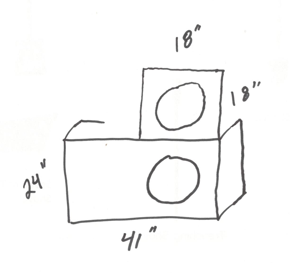

Have currently laid the cabinets I built on their side, with with 2nd Fane driver mounted on an 18"x18" open baffle. Looks odd and take up a lot of space, but I think it has some potential...

12" driver on a 18" wide open baffle ?
dip at 1khz, peak at 500hz, then rolling off below that (probably)...……………….
I couldn't tell you what will work.
I aimed the driver not quite at where you sit, then eq'ed down the 1-4khz range (that is still there 90 degrees off axis), sitting off axis will not knock that area down.
That way, you covered a larger area with "balanced" (to me) sound.
Otherwise, if 1 driver is directly aimed at 1 listening spot (and eq'd), you probably get 1 set of ears listening area 8' away, stand up and you will be upset at the sound quality (not driver's fault).
Might be you have to build and play and tell us.

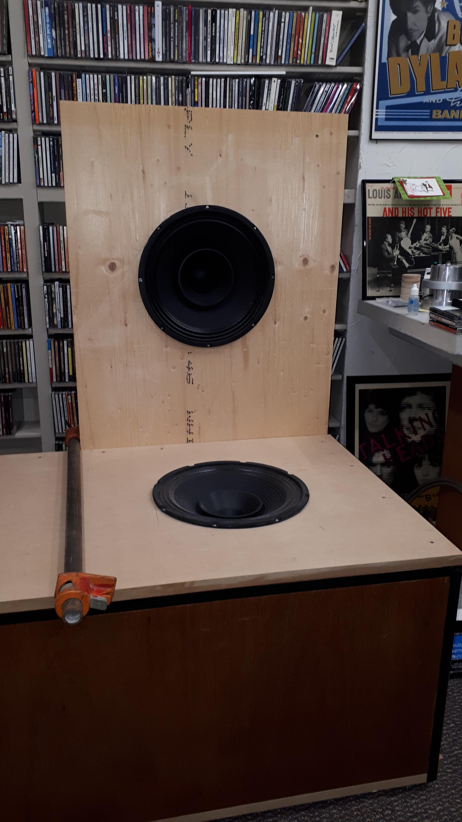

Just for fun, been listening to this configuration in the attached pic, with original speaker on its back and a 2x4 baffle clamped with second 12-250TC driver. Hopelessly unscientific, but lots of fun to try and experiment...

did this experiment ever go any further ? I have lots of ideas I'd like to try with the 15inch version mainly involving trying to improve the dispersion
There are certain limits in regards to what can be achieved with the off axis performance of these drivers.
Yes, there's a limited few tricks one can utilize to be reasonably happy, but there's no such thing as a majick potion to drench these drivers in.
In some settings it is a blessing (very nice in small rooms or rooms with a lot of reflective surfaces), in other settings it is a curse (not enough for wide area sweetspot or outdoors use IMO).

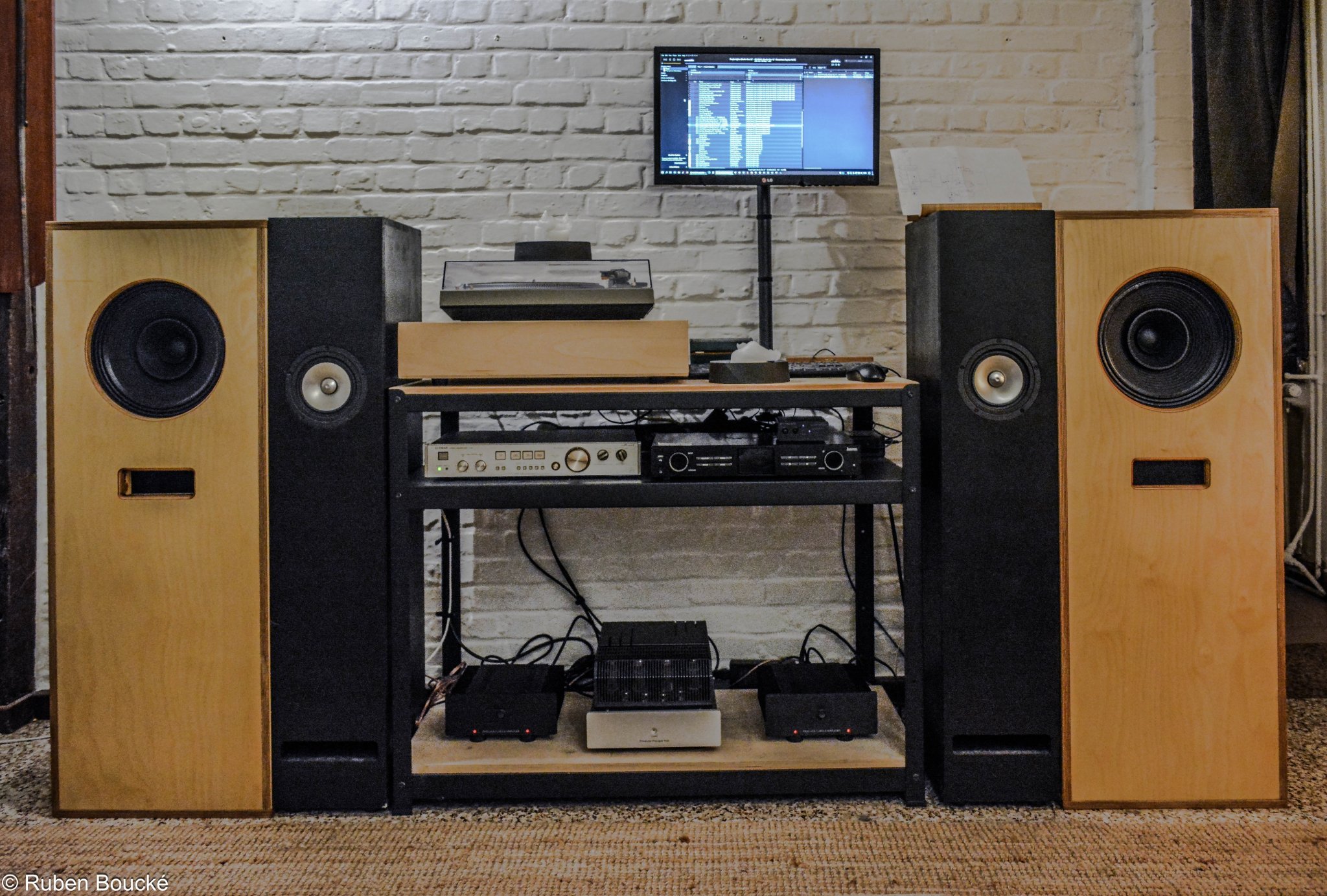

could we see you're build I'm interested in what people have done with these I think they have a lot of potentialThey are quiet ok untill about 40° off axis actually, which is exceptional good for such a big driver. Smaller drivers are better at this off course. But i like my build with these, in a room that is largely with relative thin drywall walls with a lot of isolation behind it (so not very reflective).

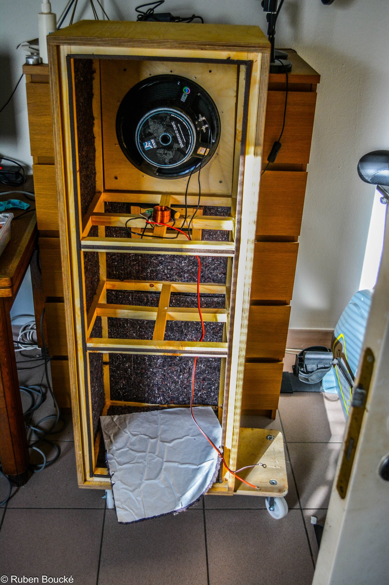

I posted it before but here it is. It's a 175L reflex tuned to 35Hz (but reasonable flat to 30Hz), build in a oldskool manner (inspired by the Altec Lansing 620 but with a fullranger in stead of a dual concentric).could we see you're build I'm interested in what people have done with these I think they have a lot of potential
Wood is 18mm birch ply, frame is from 27mm pine, the inside is lined with 10mm thick felt and the driver is mounted sandwiched between 2 plates. This setup is ment to be used with 20w or less (otherwise the bass response go up due to limited xmax) but at 98dB sensivity (measured myself) that is not an issue. I do use a filter to tame the highs a bit. The amp i use to drive it are the Pass ACA kits sold here on this site, but set to mono balanced (so 15w).
