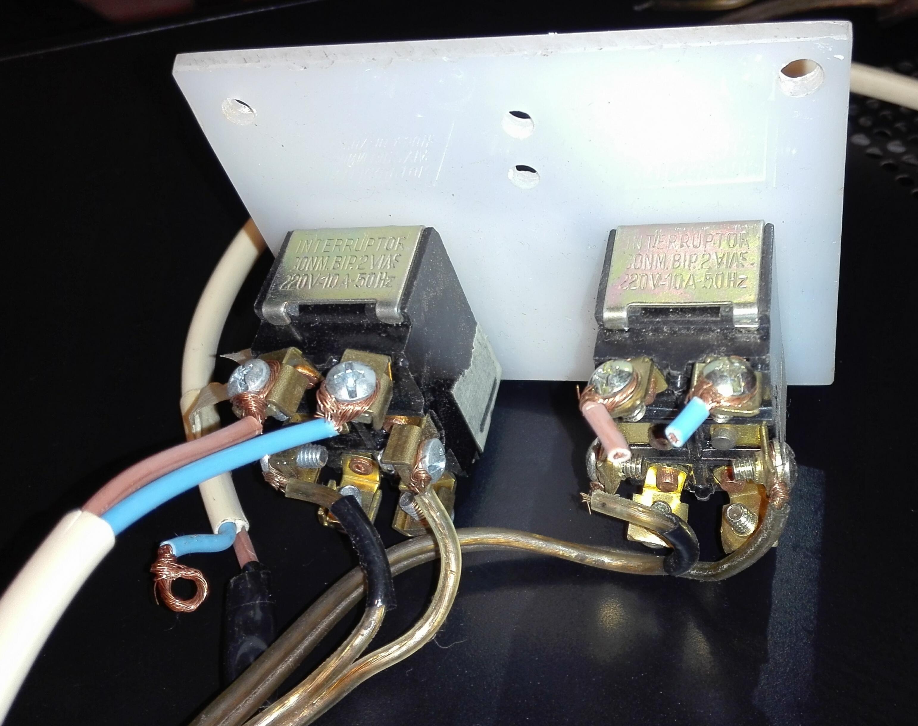

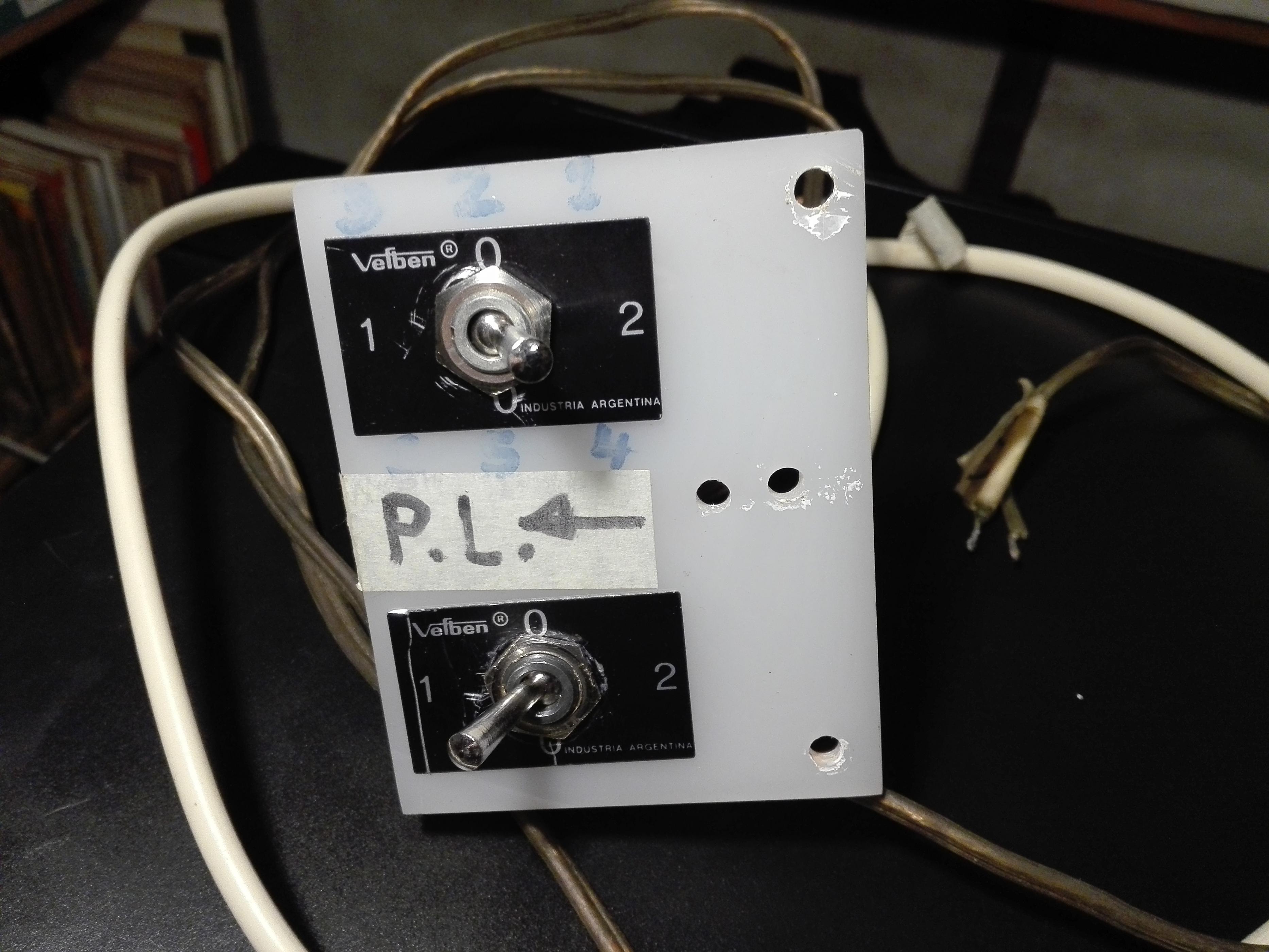

It is a situation that is easy to solve using a double inverter key, of good amperage, of the kind used for electricity.

JM, yes, that is in the event that the two amplifier outputs come together, but with the double inverter key they can never come together.
One amplifier remains connected and the other always disconnected at the speaker outputs.
I've used that setup for years, never a problem.

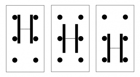

Two of these double inverters must be used, one for each channel, then the (+) and (-) of each speaker are disconnected and connected simultaneously.
I have searched the web and in my files, without result, I will make the sketch and upload it if necessary.

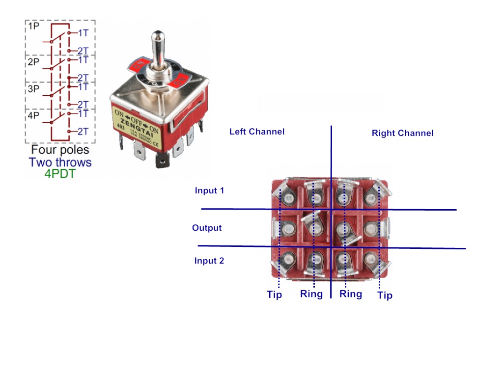

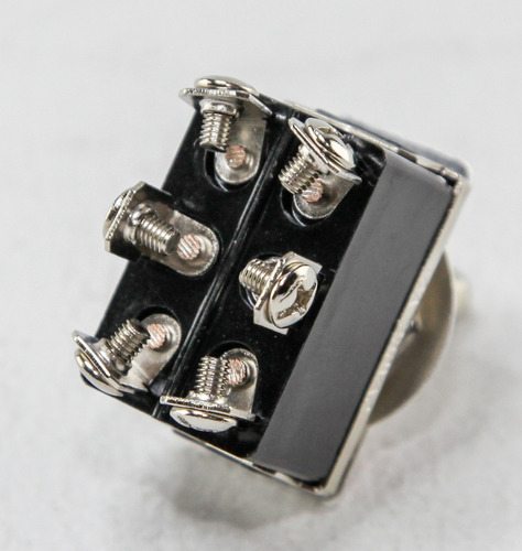

We call that a DPDT switch. The center-off feature is not needed.
If you use a 4PDT switch, you will only need one.
The attachment should help with the wiring.If you use a 4PDT switch, you will only need one.
" La función de centrado no es necesaria. "
Of course, it is the internal diagram of the double inverter that I found on the web.

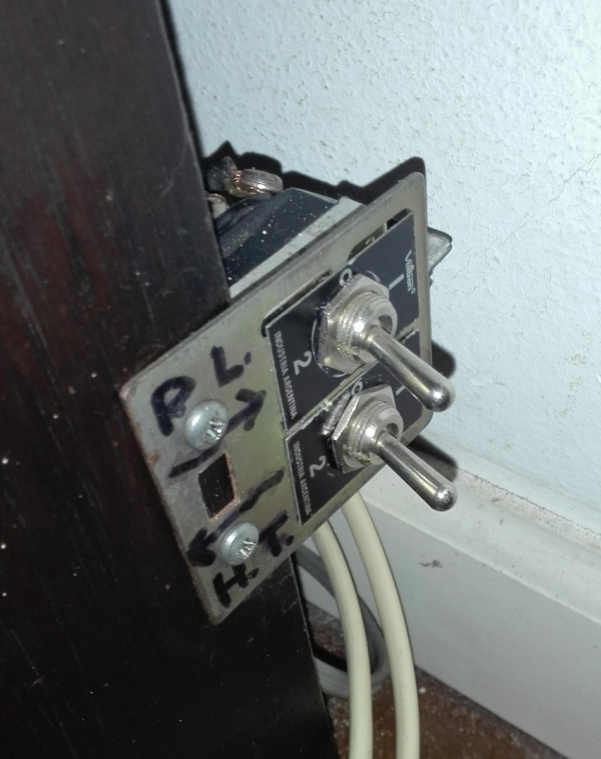

On one occasion I had two switches in use, one for the HT system that selected the front speakers, the rear speakers, and the subwoofer.
The other two speakers and two subwoofers dedicated to music exclusively.

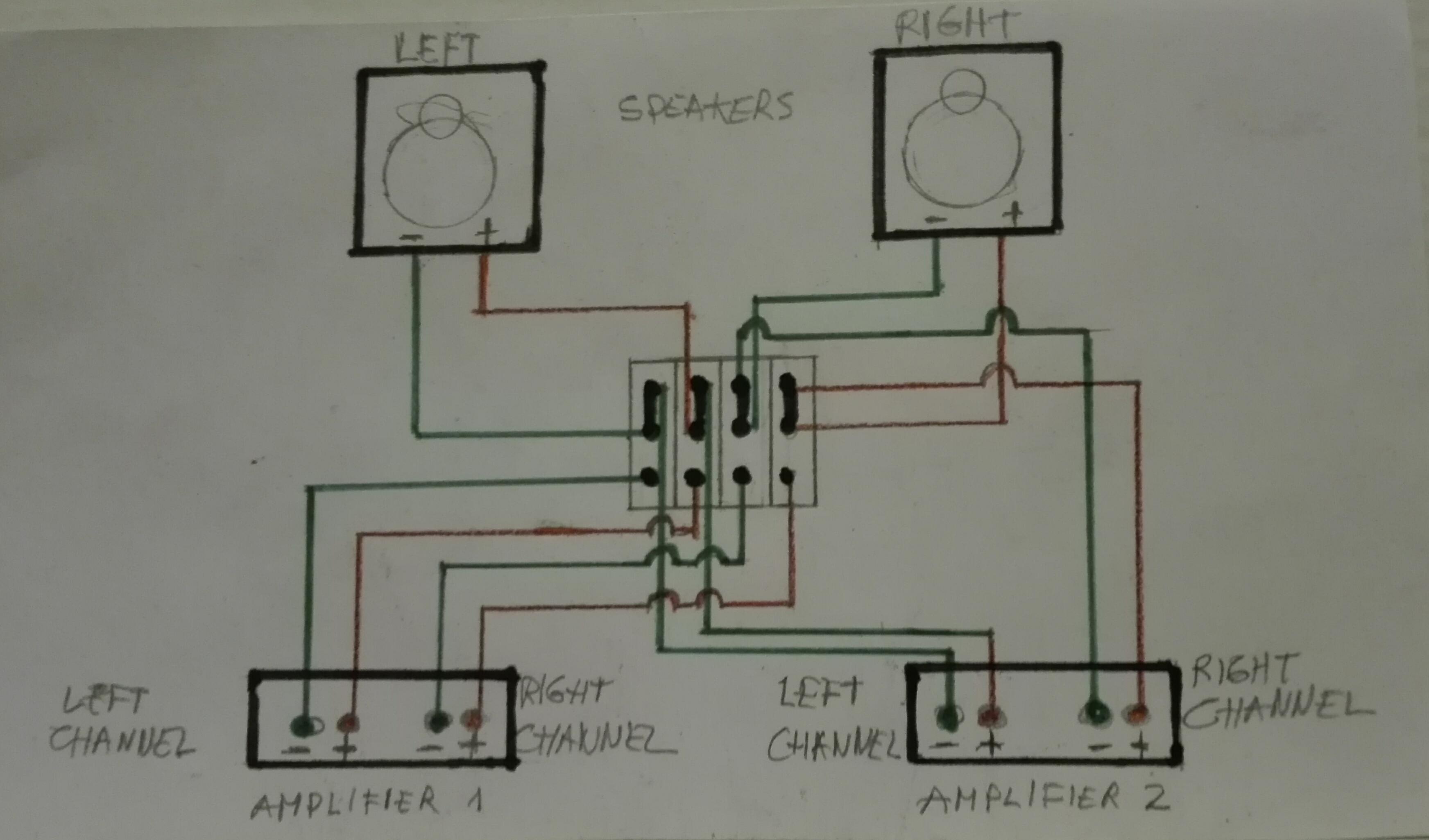

Here is the most basic and conventional diagram, the one the OP is interested in, a set of speakers and two amplifiers.
There is a color error in the positive of the left channel of amplifier 2, (red / green mix) but it does not change the connection that is correct.
Reversing keys are 10 Amps.
