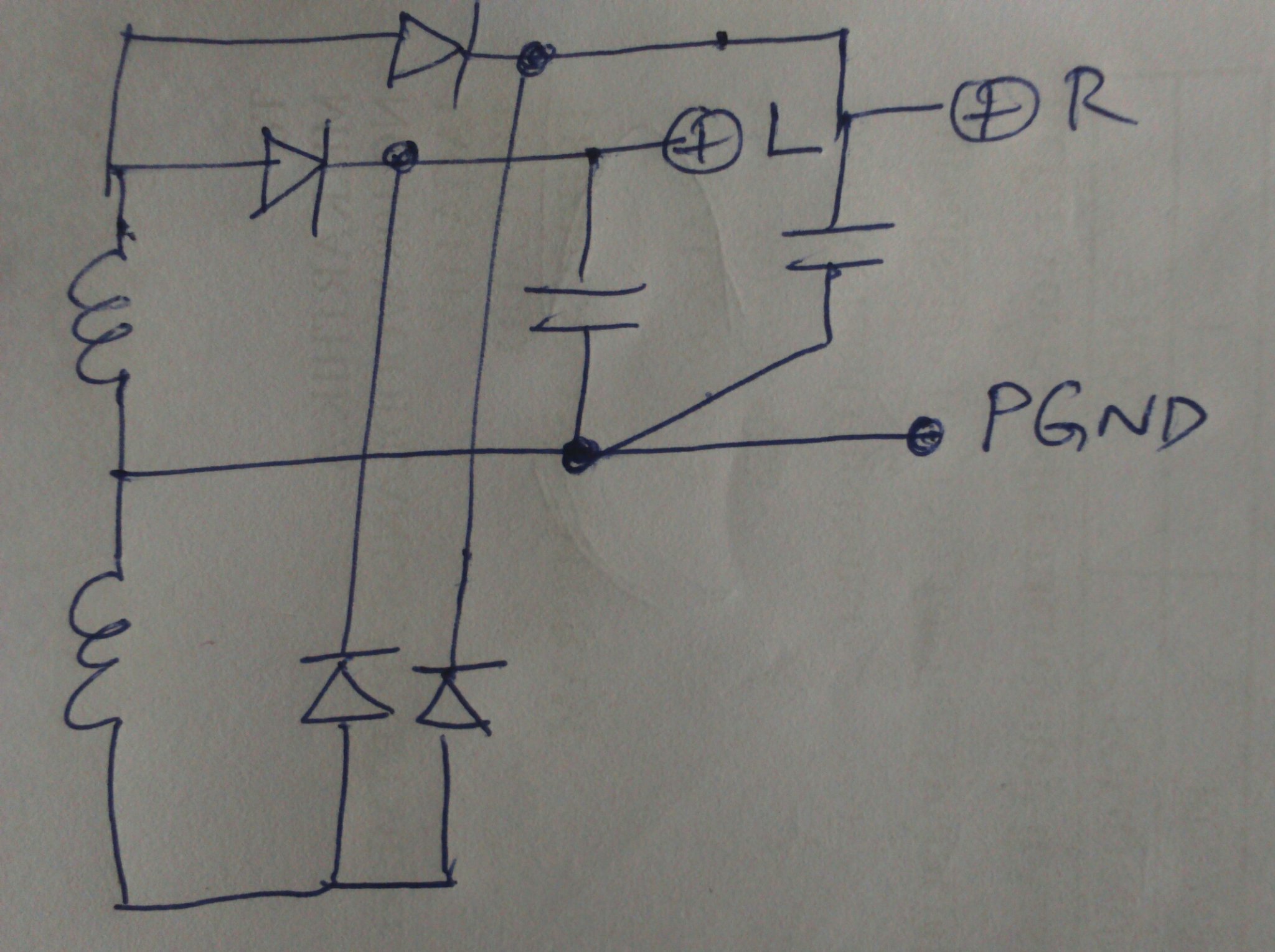

I meant something like shown in the attached schematic. While drawing it, I got a feeling in my stomach, that splitting those high charging current paths to the capacitors might do more harm than use. Combining it to one single supply and putting the focus on PSRR of the amp might be the better idea and would also ease the connection of the protection circuit.
I think you would have a stiffer supply if you just used 20,000 on each rail and pay attention to physical layout. Get additional caps closer to the draw.
Of course, good current mirrors and constant current sources in the IPS and VAS help. I have not studied the spreader and driver stage. In my last re-cap, I went from big cans ( I could not get in less than 1000 qty) to a bank of 6800's. Lower ESR, but I can't prove it matters much. Sounds wonderful, but it did when I first built it. Do be sure you select the bridge for the inrush current. Many are a bit small.
The common supply has also the advantage, that the area which is spanned by the capacitor charging pulse currents can be made smaller and this would avoid spreading 100Hz harmonics magnetically.

Edelbaster,
It looks like you're trying to block the path for circulating currents between the two channels. Some improvement in channel separation should result, at least in theory. In my opinion, this method could be more effective for switching amplifiers (rather than linear ones), as the bus pumping due to one Ch1 wouldn't affect Ch2, as their related rectifier diodes are facing each other. Then there's the contribution of the separate capacitor banks.
Hallo Edelbastler,your circuit can work, but as the two grounds have slightly different currents they differ in voltage. not much, but
it will have a bad influence at the input. You need to make a groundlift with ca 10 Ohms or so at both channels .

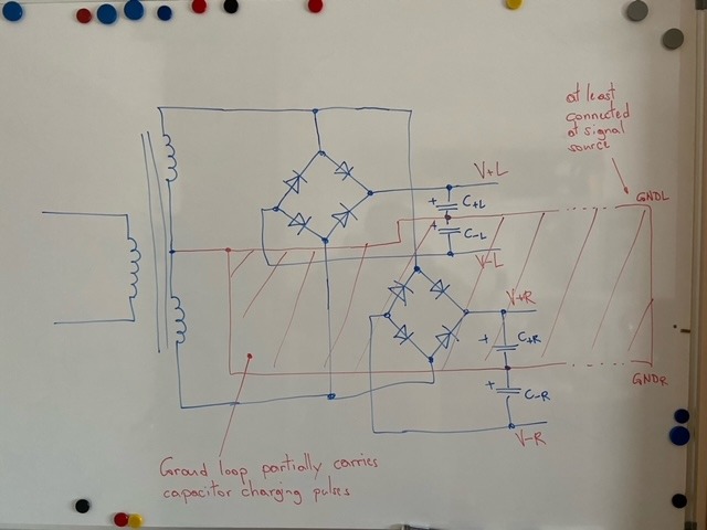

It is definitely not a good idea to use the two rectifiers. Using two rectifiers on one tapped secondary leads to a big ground loop, which starts at the transformer tap and ends (at least) at the signal source feeding the amplifier. This loop partially carries the capacitor charging spikes and because it is big enough, it will also show substancial inductive spikes induced by the magnetic field of the charging pulses. (see picture "two rectifiers.jpeg").

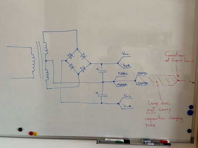

With a shared power supply, the loop starts at the signal starpoint and ends at the signal source. Assuming correct wiring, the loop will not carry charging pulses nor be inductively coupled to their magnetic fields (one rectifier.jpeg).
I will go for a shared supply with 2x2x10mF. Thank´s for reflecting upon my idea.

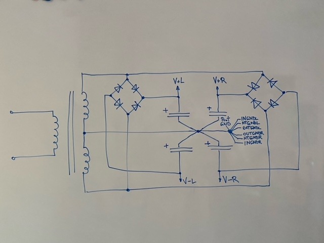

Edelbaster, I have redrawn your circuit (+ve supply only) and I still see no problems (picture). The pre-GND needs to connect to the power GND in such a way that the connection does not involve heavy currents, including the return currents from the speakers.
Your first layout in the above post looks incorrect to me, as there is an impedance between the LRGNDs and the centre tapping. The rectifiers and capacitors are supposed to be as close to the transformer as possible, in order to keep this impedance really close to zero.
Of course, your are right. I took the wrong start in my thoughts. My idea startet from a dual mono block with a single transformer 🙂
In fact there is no need to separate the capacitors physically.
Also, the power must enter the amplifier board from near the output, with an almost direct short between SPKGND and PGND. Pre-amplifier inputs may enter from the opposite side of the board. This way all the power is on one side, with all line-level on the other.

I guess, it should be right now 🙂
INGNDx ... GND for input and feedback
HTGNDx ... GND for the local bypass-capacitors on the amplifier board
OUTGNDx ... GND to Load-Connection
ProtGND ... GND for the protection circuit and the output relays. The protection circuit will have its own small power supply.
