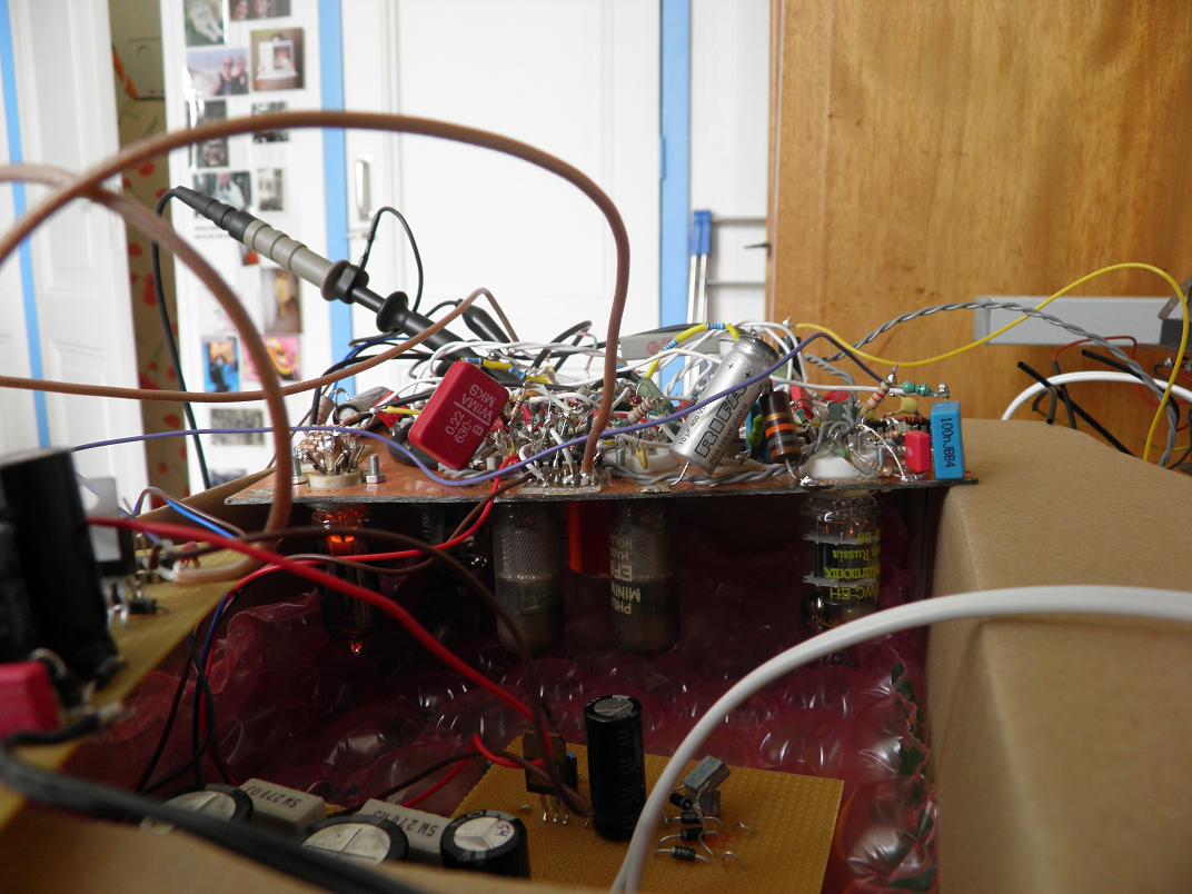

Just thinking aloud, even *single* layer (plus a few jumpers here and there) work very well in Power Amps.
Hey, power amps can sometimes be built point to point, no board involved!!!!
Just a little worried about important current going through hidden/buried tracks, and through vias connecting them to other planes.
And fully burnt tracks are a fact of life in power amps if accidents happen.
Often repaired with a piece of wire , not sure how could that be accomplished on a buried track.
On the other side, don´t see the real NEED for 4 layers, boards can´t be "too" compact anyway because parts are large and hot.
Again, just thinking aloud.
I'm sure they can. I've built many small test circuits, "dead bug" style.
