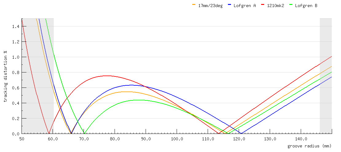

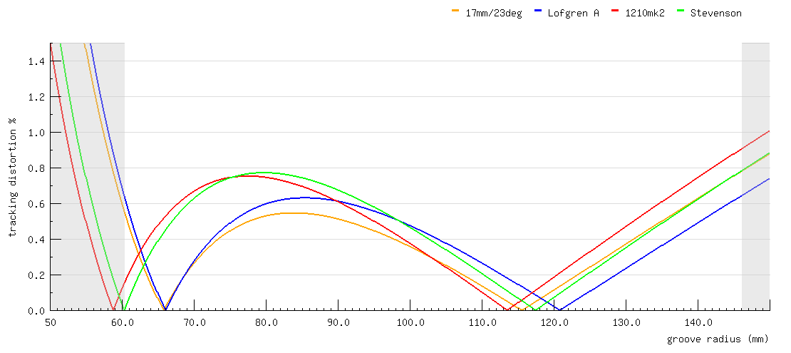

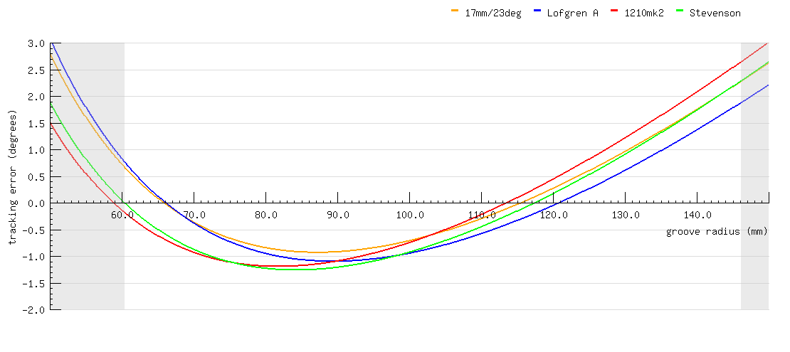

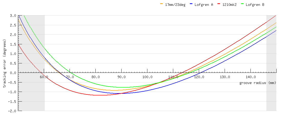

And this is second custom alignment I came up with. What if you like Lofgren A (Baerwald) on your 1210mk2, and you seek possibility to further reduce average rms distortion? You may try Lofgren B, but with inner null point at 70,29mm inner groove performance will be compromised. Lofgren B gives highest max. rms distortion among three standard alignments, 1,03% at worst location, inner groove. For comparison, Stevenson has 0,78% at outer groove, where traction is not a problem. For that reason I never tried Lofgren B myself.
This alignment has extra 2mm overhang and extra 1deg offset angle compared to factory setting, giving 17mm and 23deg total values. Null points are 65,78 and 115,52mm. It combines properties of three standard alignments, and it will work on all Technics TTs with arm pivot to spindle distance of 215mm. Inner null point is almost identical as Lofgren A, giving almost identical performance below that point, with marginal reduction of distortion. Between null points distortion is reduced giving some of Lofgren B flavor, and at outer groove distortion is increased, giving max. value of 0,78% which is same as Stevenson. Average rms distortion is 0,4% which is in between Lofgren A at 0,42% and Lofgren B at 0,37% So, it might be a nice alternative to Lofgren B, giving some benefits without compromising inner groove performance.
Other reasons to use this alignment might be: you dont like weird position of the cart in a headshell with Lofgren A so you wish to improve appearance, or you cant move the cart far enough in a headshell to achieve it. In both cases this setup might help, with closer geometric resemblance to Lofgren A then first custom alignment I showed in this thread.
Again, I made this setup with hand-drawn arc-protractor and tried it with Audio-Technica AT95E cart at 2gram vtf, antiskating 2,3 and arm heigt 1-1,5 for most of my records and original platter mat. Previously, this cart was set to Lofgren A, but with different speakers so I cant make direct comparison. Overal, sound seems a bit cleaner, less colorated, but that might be due to speakers as well. Regarding IGD, AT95E is not as good as Grado Prestige carts set with first custom alignment, but still very good and with no negative effects compared to Lofgren A setup. I mostly use it as my spare cart, for less than perfect records, so this is not a problem.
For end, I wish to point I dont want to re-invent the wheel here. Just to share some positive experience with this four year experiment. And I claim no magic properties. Differences in sound between alignments are subtle. Will you here them or not and how will they sound to you, depends on the whole system and your personal taste. Alignments wont cure shortcomings caused by other factors. I hope someone will find these alignments interesting, and try them with his Technics. I especially recommend the first one from previous post.
Here are the graphs, made with vynilengine Alignment Calculator Pro (many thanks again). First set showing custom 17mm/23deg alignment (yellow), Technics alignment (red), Lofgren A or Baerwald (blue) and Stephenson (green)
Second set of graphs with green line showing Lofgren B
