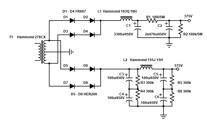

A full wave bridge and full wave center tap off the same winding is possible, with the bridge giving 2X the voltage. It’s just a standard split supply with the negative rail called “ground”. Works great with sweep tubes because you need the 1/2 B+ for the screens. Or if you run a “stupid high” B+ for transmitting tubes and want something lower available for everything else without wasting 50 watts in resistors and needing all the electrolytics to handle the full B+ for the start up surge.

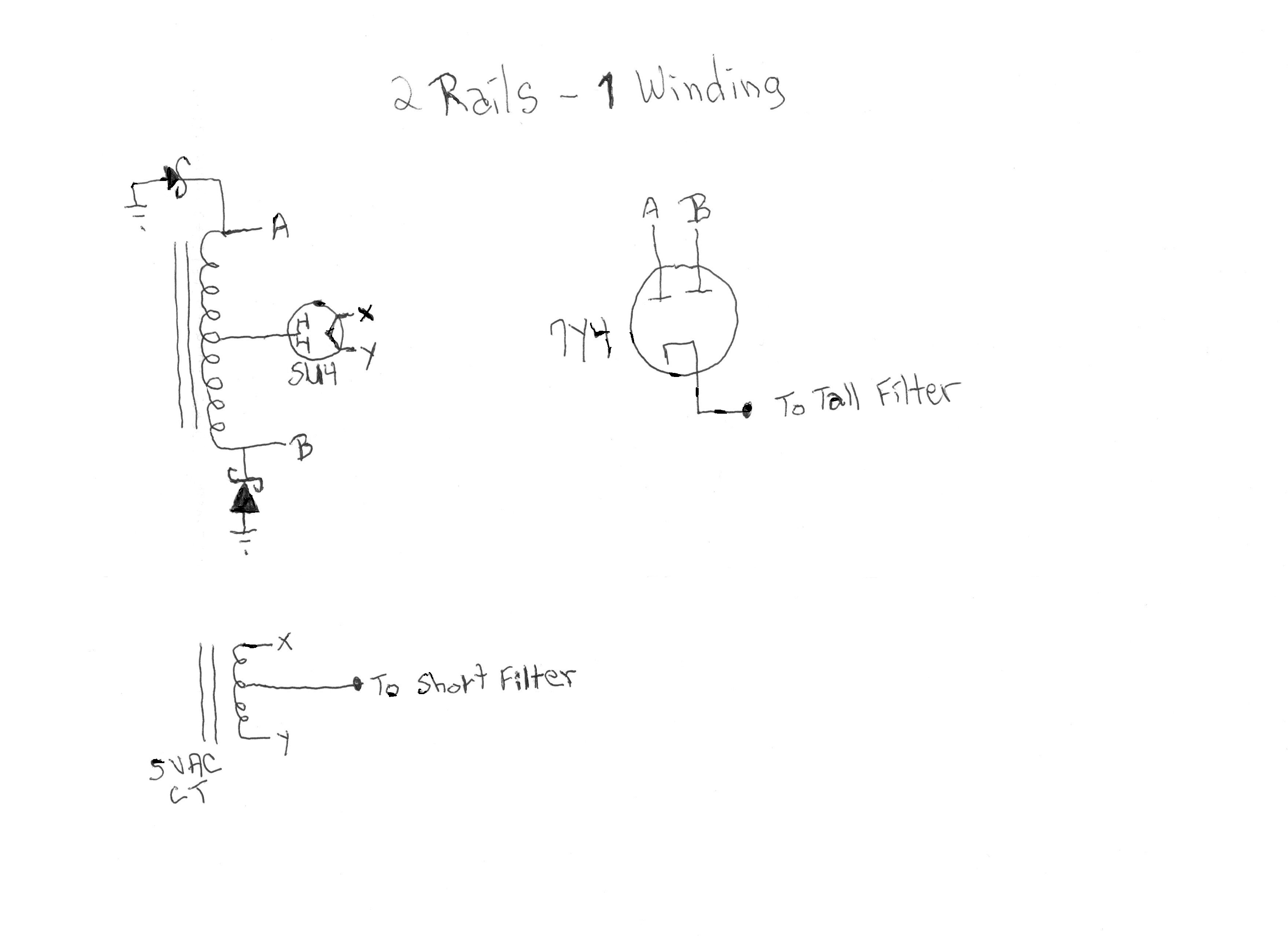

Some time ago, an idea for using 5 diodes to obtain 2 rails, 1 "tall" and 1 "short", from a single CT winding was presented. I'm providing an illustration of the technique.
The "tall" rail is bridge rectified and the "short" rail is FWCT. The OP can have what is desired by using 4X SS diodes and 1 vacuum rectifier.
