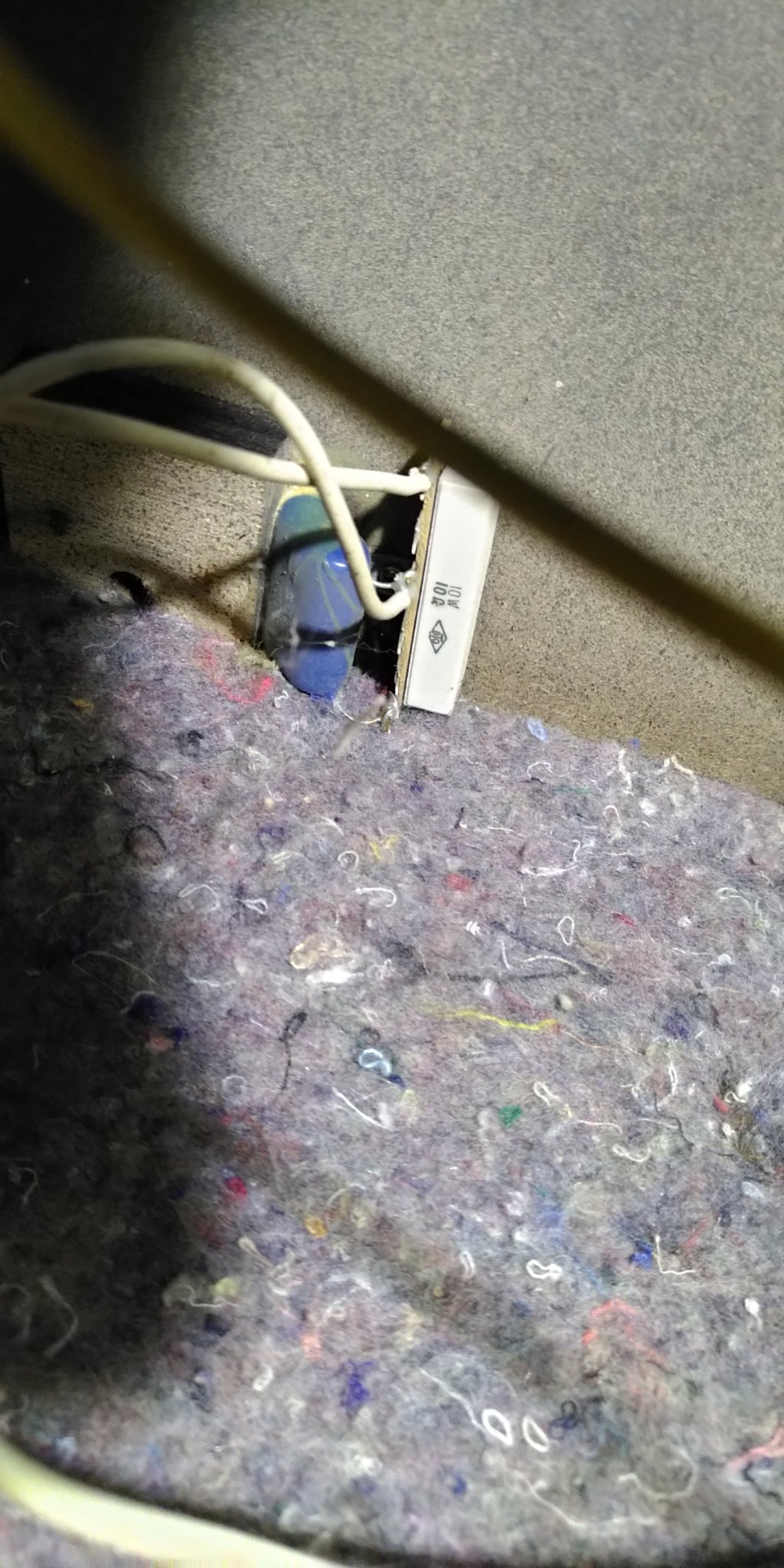

One year ago I discovered a pair of these PA small horn speakers in a recycling warehouse and took them home. It's a two way system with backloaded horn, a cone tweeter and 10" woofer. I hooked them up and they sound pretty good, although the subbass is lacking (obviously with such a small horn). Nevertheless they sound punchy and clear, with good resolution. A good find in my opinion. Now, the question: does anyone has some info on these speakers? I have browsed the internet for details, but there is nothing to be found, not even pictures or data sheets. Also the Pearl website does not mention them. On the back, a sticker only states: 50W @8 ohm, no type- or model number.

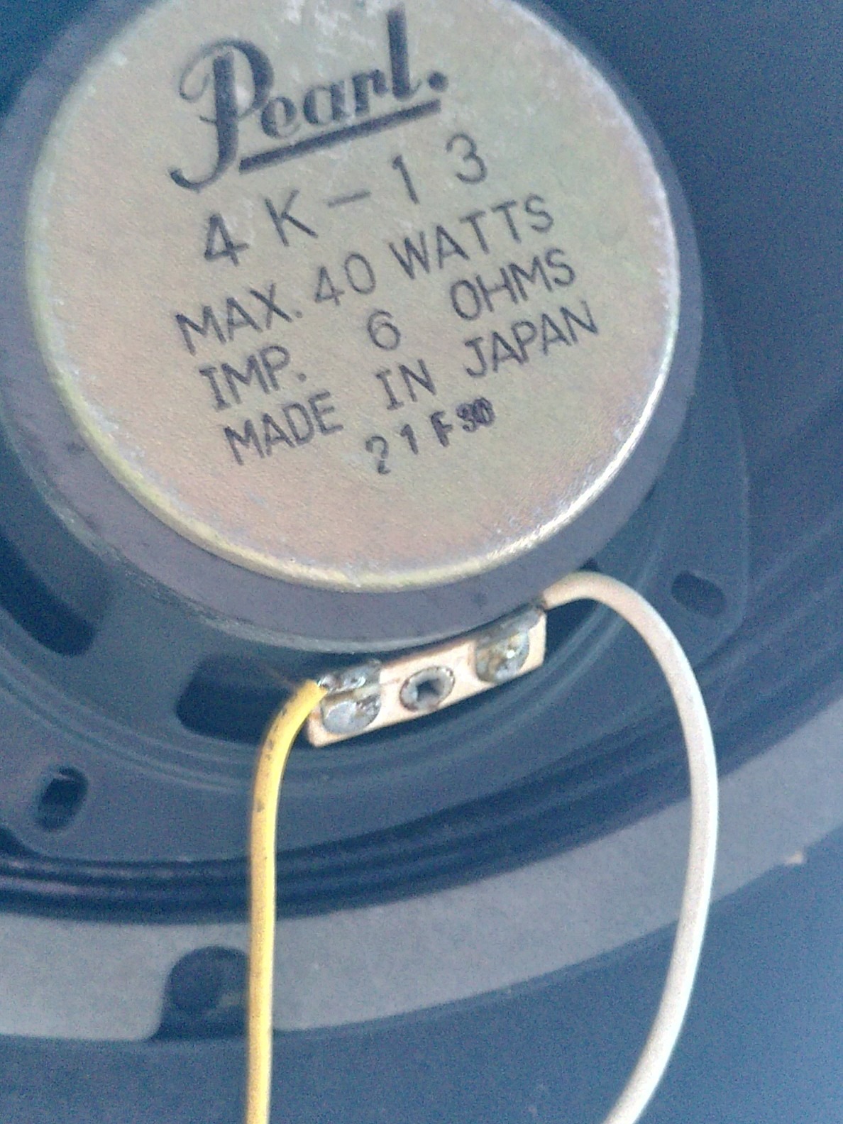

That tweeter looks suspiciously like a 4” wide range unit of years past, perhaps from Foster. Their use in combo with woofers is not as old as that speaker appears. I would pull it and have a look.

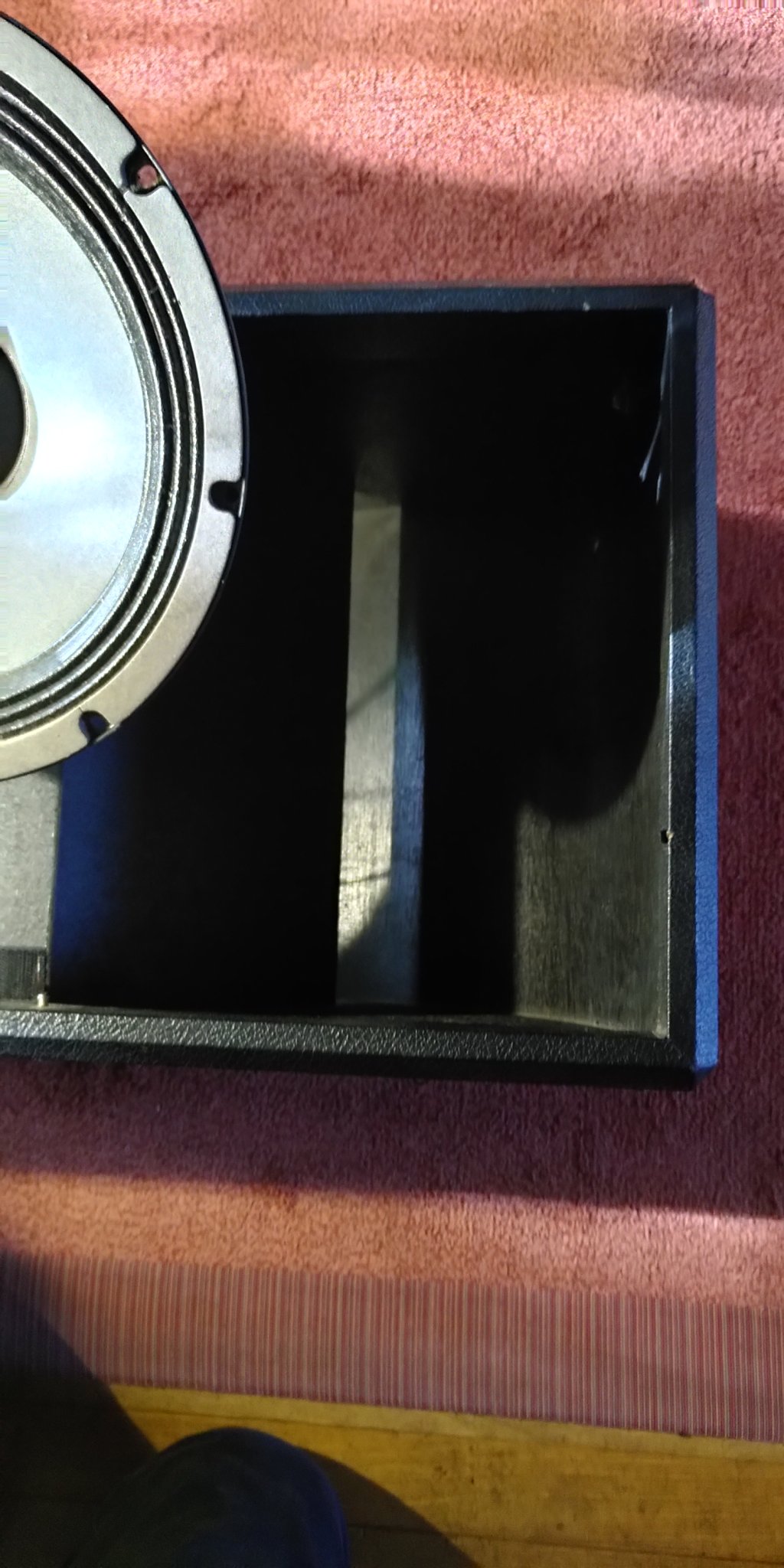

Yes, I will and check, tnx Cal. A bit of reverse engineering should be fun. Btw that "horn" is more like some bassreflex kind of tuning appearing like a horn.
It has the appearance of a scoop from this side of the screen. You may tell more once you pull the small driver.
Yeah, that or again considering the woofer, thinking it might be a 1/8 WL stub horn vent popular in the '50s - '60s.

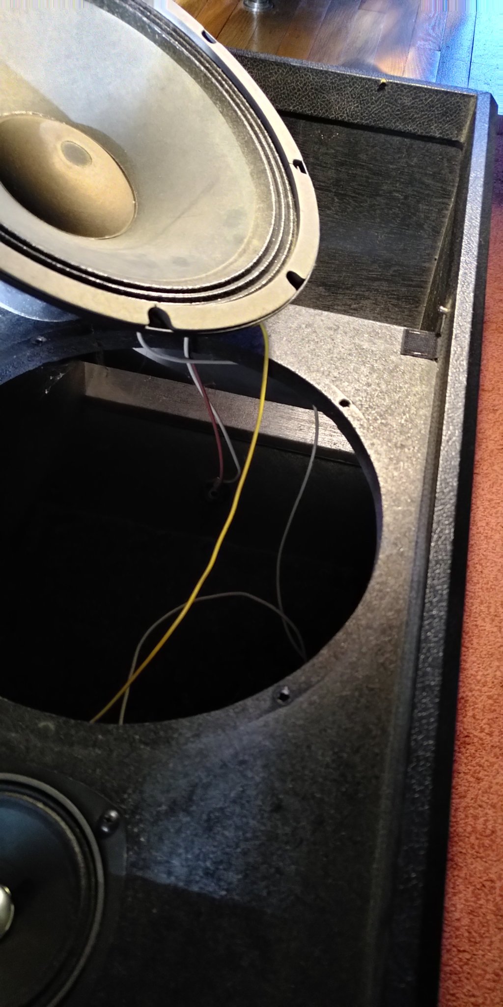

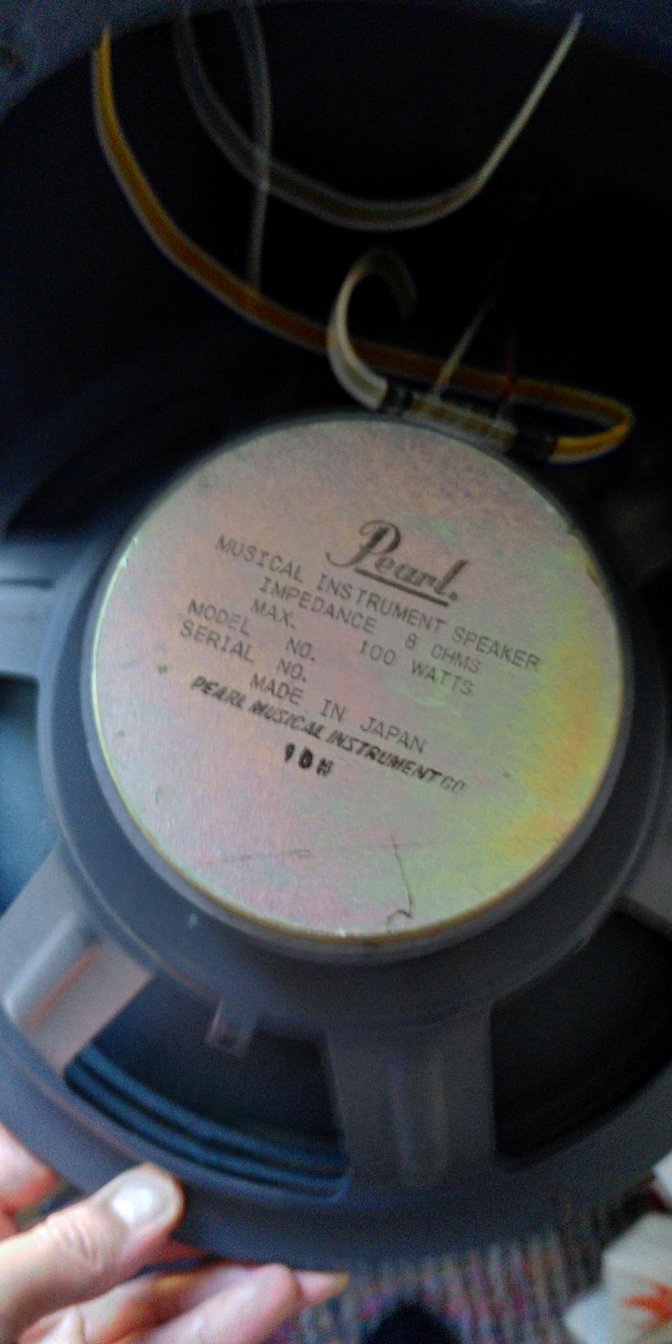

Well, hold your pants... I took one of the speakers apart to have a peek inside. I really like this concept because of it's bare bones design. The tweeter is a 4" cone with first order high-pass filter (10 ohm resistor and 3,3 microF). The woofer has no filter at all, just parallel connected to the input jack. The tweeter is in parallel with the woofer. That's why this speaker has a wide soundstage, great punch and dynamics, detailed with good stereo separation -among other virtues as it has virtually no crossover (wink). Drivers made in Japan as a bonus.
What I learned from this design is, assuming that it sounds "correct" -and to my ears it does to a certain degree- that, to make this simple design work, the tuning of this loudspeaker has been done in a non-electrical way. There is only a first order filter and no other correction networks, so the characteristics of the drivers and the housing themselves must have been tweaked to complement each other. F.e. the 10" driver has to operate full range, so how the woofer breaks up and behaves at high frequencies becomes important.
