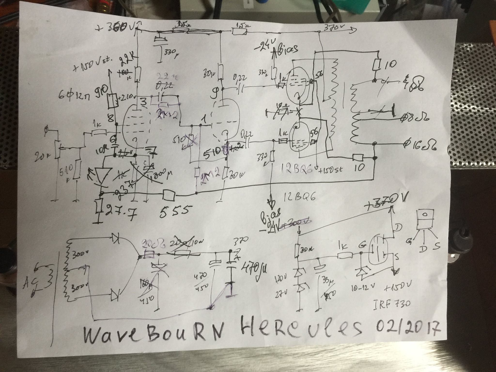

Forget about UL, it was a fashion. Instead of UL you need to bootstrap screen grids to cathodes for lower distortions. Even 0-16 Ohm secondary taps with grounded 4 Ohm tap make a huge sonic difference, but 10-20% should be better.

Wavebourn, I see only secondary to cathode type of ncfb connection, while g2 seem to be directly connected to the power supply rail. Are you talking about the input tube connection between g2 and the cathode?
Wavebourn I like your inputs. Me too have got a large stash of PL36. The schematics reflects this post (#8105) of November 2017, right ?
I plan a similar amp, long-term work, nothing urgent, I have 20 more years to build it 🙂 My question is, what was the input impedance of the OPT ?
I was talking about output tubes; I meant that UL is contrary to what is better, to bypass G2 to cathode. However, in that particular amp I just powered G2 from MOSFET voltage regulator, is is still better than UL.

I used 4k P-P transformers made by Schumakher for ADA Depot.

Alex, the fact that g2 has its own supply and is not connected to the OPT it doesn't mean that it automatically works in pentode mode once you connect the CFB. In the latter case it is UL operation indeed which Crowhurst used to call modified UL an it definitely is better than the traditional one. You need to refer g2 directly to cathode in AC if you want pentode by means of a capacitor for example.
So you can have UL but a different and more convenient g2 supply without an OPT with tertiary winding.
I have never tried the bootstrapping suggest by Wavebourne but it looks very interesting. I think I' ll give it a go as soon as I have time.
g2 swinging together with the cathode? That's clever! I guess you have to power g2 using a current source?
What about coupling it AC using a transformer to have different cathode to g2 swings?

The schematic for your Hercules amp is of great interest and you have posted it several times. I would like to build it, but your scratchy drawing is so hard to read and understand that I’m hesitant to try follow it. Would you kindly point me to a better drawn schematic of Hercules?

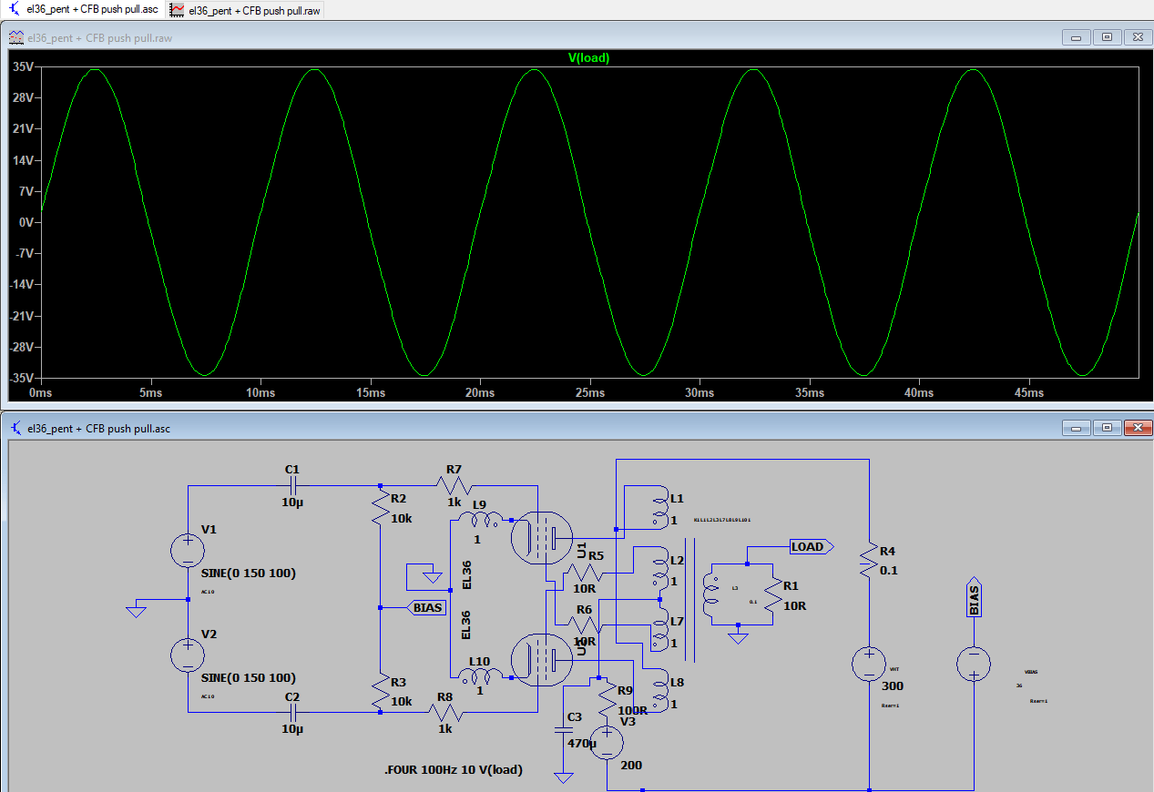

Hi folks,
I've been pecking on LTSpice for a few hours, simulating different conditions on different ways to try EL36 / 6CM5 into a PP class AB output stage.
For example, swinging 35V into 10R secondary load (61W), 1.6k p-p load 50% to 50% shared between anode and cathode (CFB), inluding separate 50% UL windings, cross-coupled to the screen grids, separately biased for g2 at 200V
I'm monitoring g2 peaks, watching for g1 current,
However, at such low loads, the tube's cathode current is peaking at 600mA, whereas 200mA absolute max are mentioned within the datasheets. What would happen when cathode current is exceeded?
I'm also experimenting with triode mode, or still pentode mode with no separated UL windings, with a higher load such as 6.6-7k, B+ of 440V and 200V g2 voltage, similar to the conditions member @Parafeed813 recommended
I'm kind of attempting to explore the limitations of this tube, hence needing your advice on this one.
I'm aware 60W output power would melt these tubes, but I'm curious of sweet tuning a good operation headroom with little crossover distortion as possible. In reality, I'm in need of 30W output power,
G2 peaks are rated at 21mA Rms, so that stands for 0.08W Pdiss
What kind of regulator would you recommend for g2? Could a series voltage regulator work out just fine? I'm not pretencious over tube regulators, it could be a solid state one.

The Philips (and others) datasheet mentiones an output power of 45 W, albeit at a plate to plate load of 3k5, 300 V plate voltage and 150 V screen voltage. Hence, 60 W aren't that utopic. The issue is the lower plate load. Increase both the load and voltage to achieve 60 W output power.
Best regards!
Yes, Kay, your answer is quite reciprocal. However, I'm also puzzled by the numbers of anode voltage and g2 voltage limitations, so you see, from this point of view I'm looking for the best load possible.
The alternative option already successing in simulating is the 6.6k a-a primary load, with 20% CFB instead of 50%, just like @Parafeed813 recommended, only that a higher g2 voltage was needed.
Not necessarily. I drew close to 70W from a pair with a 3,5k plate to plate load a couple of years ago. I can't say how long they would last but there was no red plating or anything. That was a prototype output stage for a bass guitar amp but one of the amps I use frequently in my hifi system is also a PL36 PP with CFB, though only 6W or so as it runs in class A with triode-wired output tubes.

70W! Dat gona rock da haus! :rofl:Okay! It is definitely a tank tube, can be abused. Judging by your findings, cathode current matter should not be needed for discussion then.
