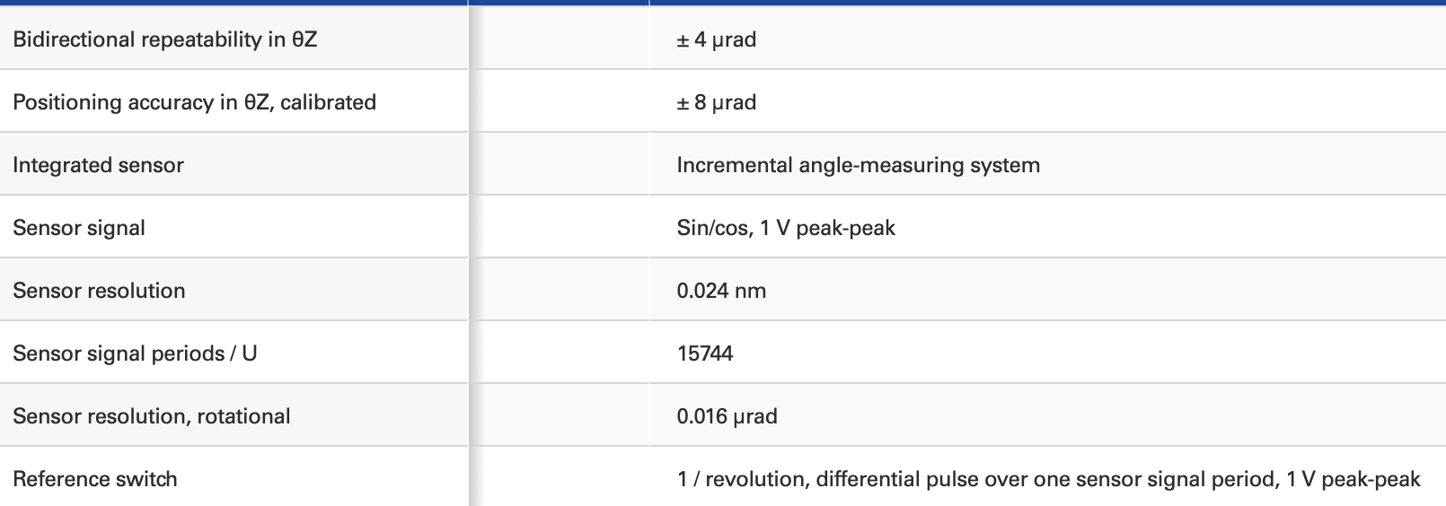

Here are some specification for the world class technology that we might apply to our theoretical ultimate turntable:
thrust bearing stiffness: 34N/um
Permissible torque in θx: 4.52 N·m
Moment of inertia in θZ, unloaded: 1780 kg·mm²
Drive torque clockwise in θZ: 0.86 N·m
Sensor signal: Sin/cos, 1 V peak-peak
Positioning accuracy in θZ: ± 8 µrad
Sensor resolution: 0.024 nm
The downside to this solution is that it is not simple. Air compressors, clean air purifiers add complexity while air bearings themselves are sensitive mechanical devices.

Airbearing stiffness is 34N/um. Once the air bearing is loaded with the platter, the vertical stiffness of the air bearing should be sufficient to counter any up/down forces caused by the tonearm/stylus. Also, IF the air bearing does have any vertical displacement, wouldn't the air bearing displacement be significantly less than the displacement caused by vibration with a conventional, mechanical thrust bearing?
Is that a misprint? 2.4 x 10-11 meters? That's a factor of 20X better resolution than the smallest linewidth on Intel's newest integrated circuit . . . ??
Sensor resolution is 0.024 nm, see attachment for specs.
So, maybe we should reconsider state-of-the-art direct drive rotary systems with sub-micron accuracy, resolution. Remember, cost no object and therefore, a direct drive rotary solution with ample control/drive would be state-of-the-art turntable drive capabilities, correct?

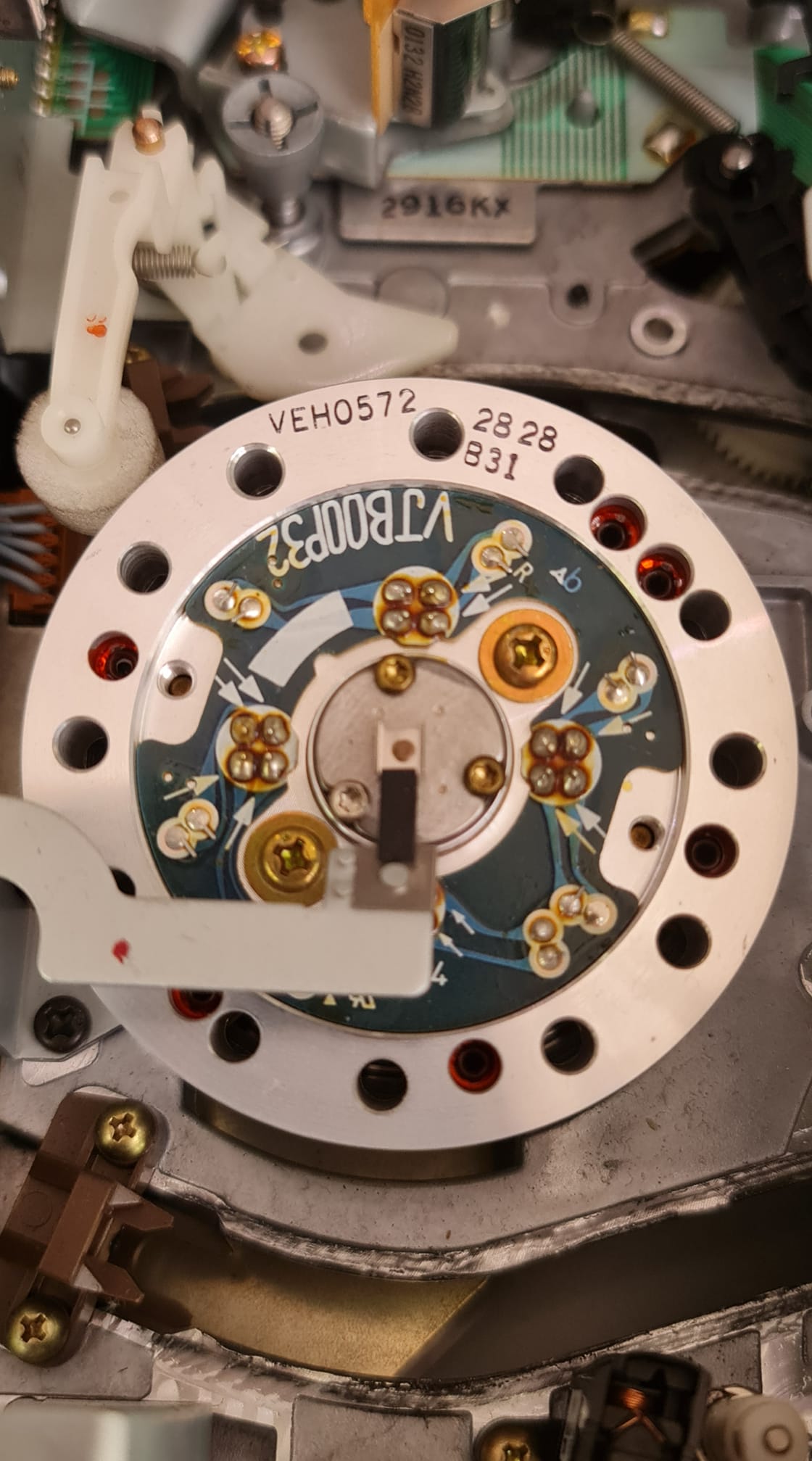

If i'd be to consider the best driving system , most probably there would be two of them:
1. a Dual EDS-1000 motor with the least amount of feedback and you can find it what it means when touching the 3.4kg platter with the least amount of force
2.a regular capstan motor found in any VHS player that's able to keep a very steady and low speed whyle dealing with a lot of friction using a very tight and complex feedback system that's still based on the DUAL EDS-1000 principles.
