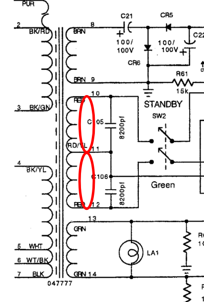

I have a Fender Vibro-King, I love its sound but I'm always disappoint about it's noise floor comparing to my other amps. The noise it's like a 100hz hum, maybe it's part of its design... yes I can live with it (I play it since 2012) but recently I read some posts here regarding UF diode vs standard and the UF seem from what I've read less noisy especially if paired with a snubber circuit.
I read that the best result is using four UF4007 in the full wave rectifier, and before it, on the secondary of the PT the snubber (47ohm resistor and 22nf 1500V cap between secondary).
I would like to try it, but I have a question watching the schematic. Here I attached it...
The best place for the snubber is right before the full wave rectifier before the standby switch? Before the 8200uf caps? Or 2 snubber circuits from both the secondary leads to the Central Tap?
What do you think? And do you think it's a good idea?

Hi MM, each secondary winding needs a snubber and each snubber needs to be as close to the transformer as possible.
Snubbers are needed to damp (over damped or critically damped is fine) the oscillation that can occur between the inductance of the transformer secondary and the internal leakage capacitance of the winding. That ringing at many MHz radiates into the amplifier circuit at short bursts twice every mains cycle (ie at 100Hz for 50Hz mains). This sounds like 100Hz hum.
Diode type makes no difference and bypassing diodes with a small capacitor simply couples the noise more readily into your amp and can make the effect worse.
Thank you very much! So you say I need 2 snubber... here and here

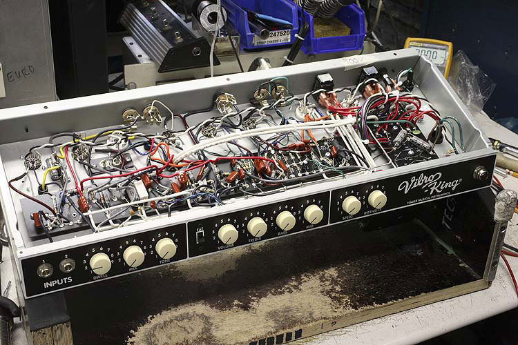

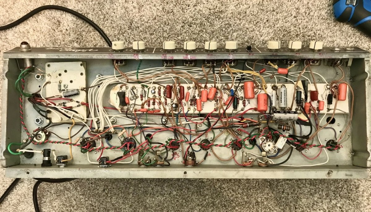

Hi Rayma, this is not the inside of a Fender Vibro-King, the one in your picture look like a heavy modded Vibro-King... this is the inside

Somebody wanted to finish the spool.Layout and wiring are awe inspiring. 😱
I would suggest tearing every single wire out and rewiring it properly.
Serious.

Yes I'm agree with you, also my other amps don't have snubbers and they have tube rectifier, but this amp have more noise, so I'm trying everything for make it quieter. Everything that can reduce noise especially the 100hz that are prominent will be a good upgrade.
Those 8200 pF caps are supposed to BE the snubbers. If you’ve changed the rectifiers and replaced them with a fast type, they may now be ineffective. They are really supposed to have resistors in series with them - I typically use 15 ohm. This will make them more effective over a broader range of conditions.
Of course a “hum” might be caused by something else, rectifier “noise” usually sounds more like a “bizzzzzzz” than a “hummmmm”. More high frequency harmonics and less low frequency content.
