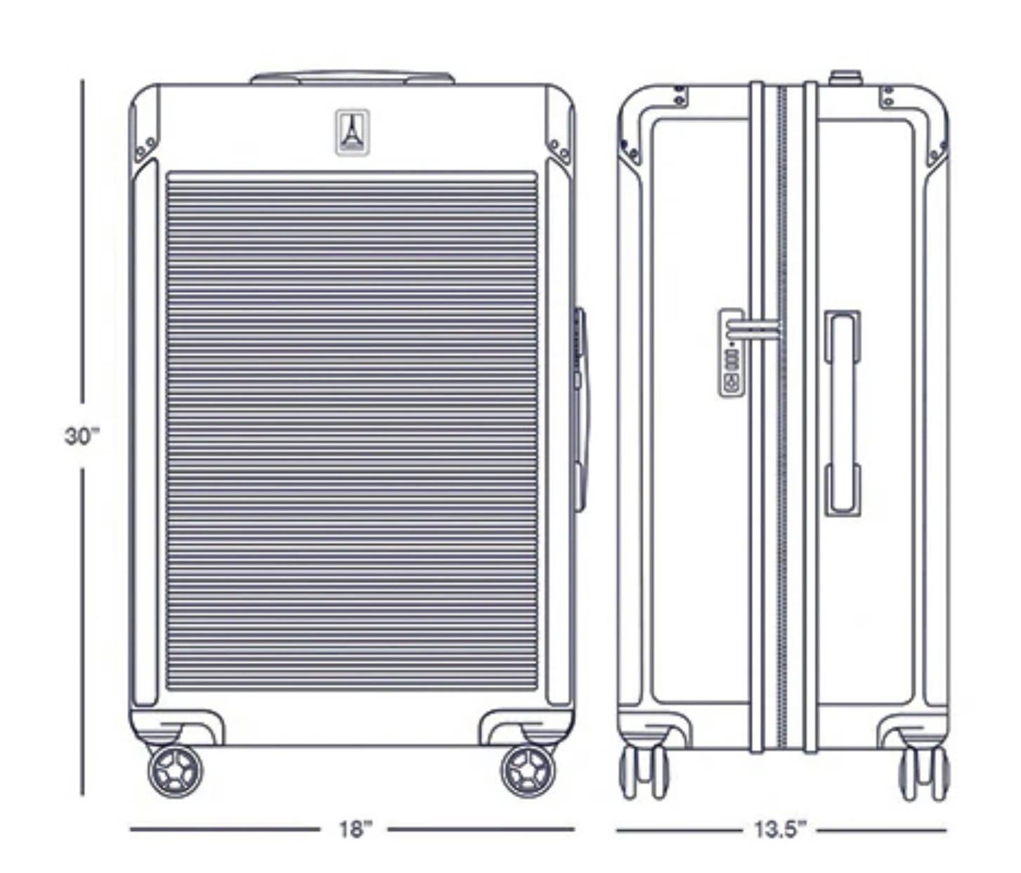

Totally. I wrote a thread somewhere about designing a standard suitcase size speaker; complete with handles and wheels. I can’t recall where that thread is. Anyway: it’s doable. Totally doable.
Set the limits at standard industry size large suitcase (62” total dimensions) and weight (40lbs) complete with handle, wheel, and built in li-po battery.
Can’t believe it hasn’t been done already.
