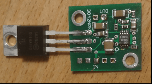

LDOVR TPS7A4700 modules are so affordable that I can't make them myself for a lower price. Very low noise and LDO so working perfectly with a 6V 10VA transformer. Small, low heat, green, the works. I suggest to use a larger heatsink though.

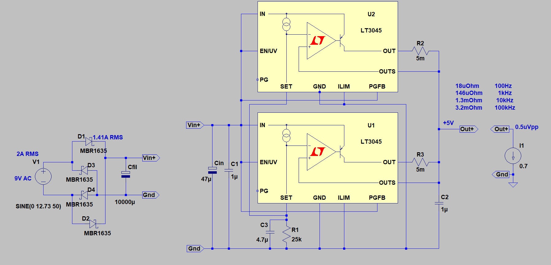

LT3045 - 20V 1.5A / 500mA
Lt3080 - 37V 1.5A
Depends on the package. Those do well targetting mains hum with their PSRR curves. You may want switching noise filters targetting incoming noise for differential/common mode noise.

Page 27Almost verbatim copy from the LT3042 data sheet , page +/-17 IIRC.
Hi Jean-Paul,I can't make them myself for a lower price
It is hard to find part now (for reasonable price)

Isn't choosing a modern low noise LDO regulator and small single PCB 5V 1A design for a 5V 0.7A HPA a more obvious choice? OP also needs mains AC to 5V DC so a complete PSU. It is not for a lab instrument, it is meant for a probably relatively small sized HPA.

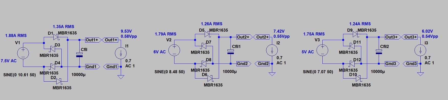

A lower AC voltage would be optimal when a modern LDO would be used. 10VA is more than enough unless one listens to headphones at maximum volume 24/7. Tip: don't do that.10VA transformer isn't enough for this.
The power requirement of source is 9VAC 2A, so must to use at least 40VA transformer, else it will be too hot.
Are you sure?A lower AC voltage would be optimal when a modern LDO would be used. 10VA is more than enough ...
No such option (even 5VAC transformer), when 10VA transformer enough (not burn out) at 0.7A continuos load.
The first capacitor in the PSU loading the transformer more, than static load.
If you decrease this capacitor, the noise (sawtooth "hum") will be growing.

If you build stuff in real life you would know this is nonsense. It is also not 0.7A continuous load but if it would be then it would just work ok.Are you sure?
