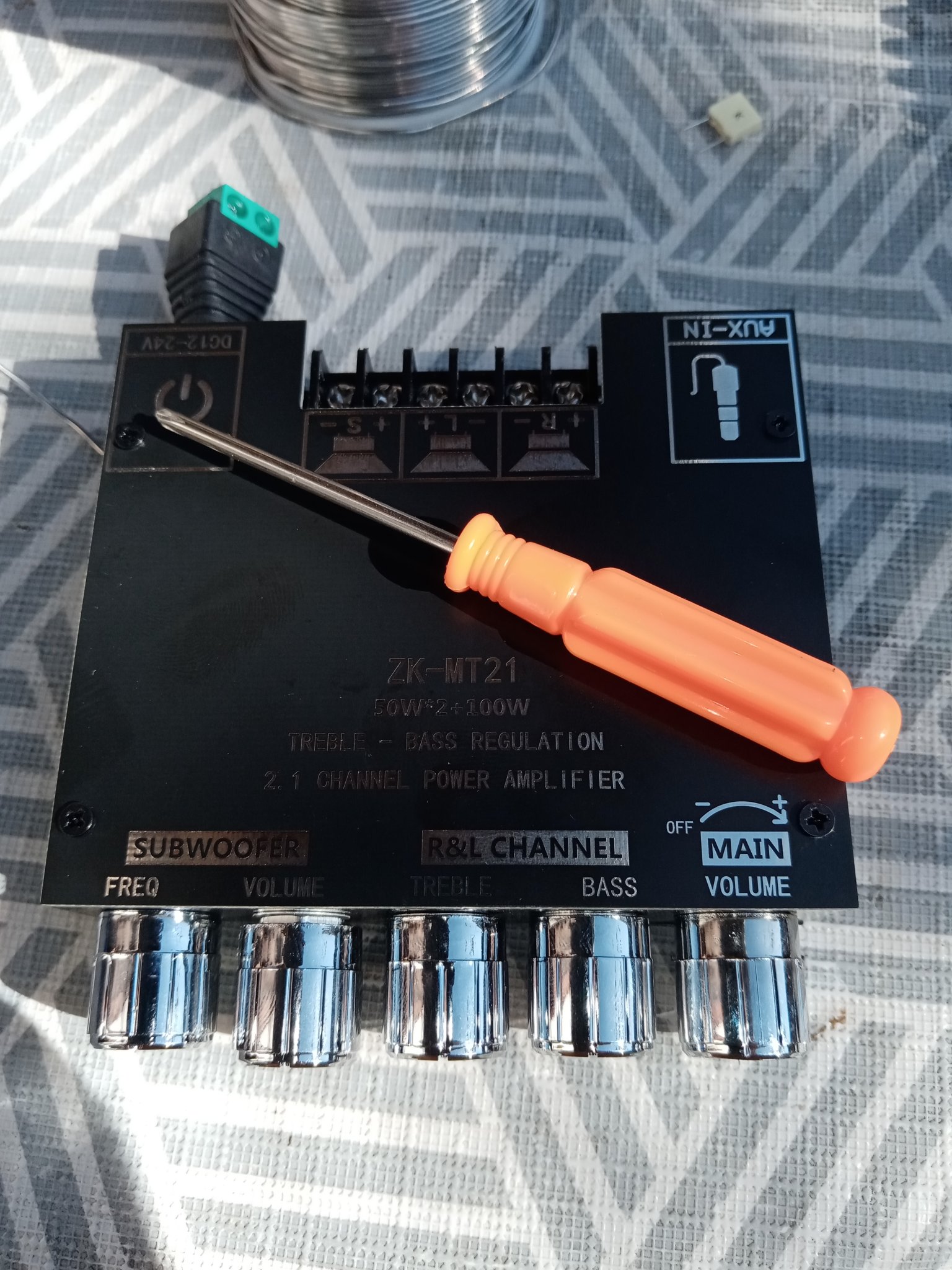

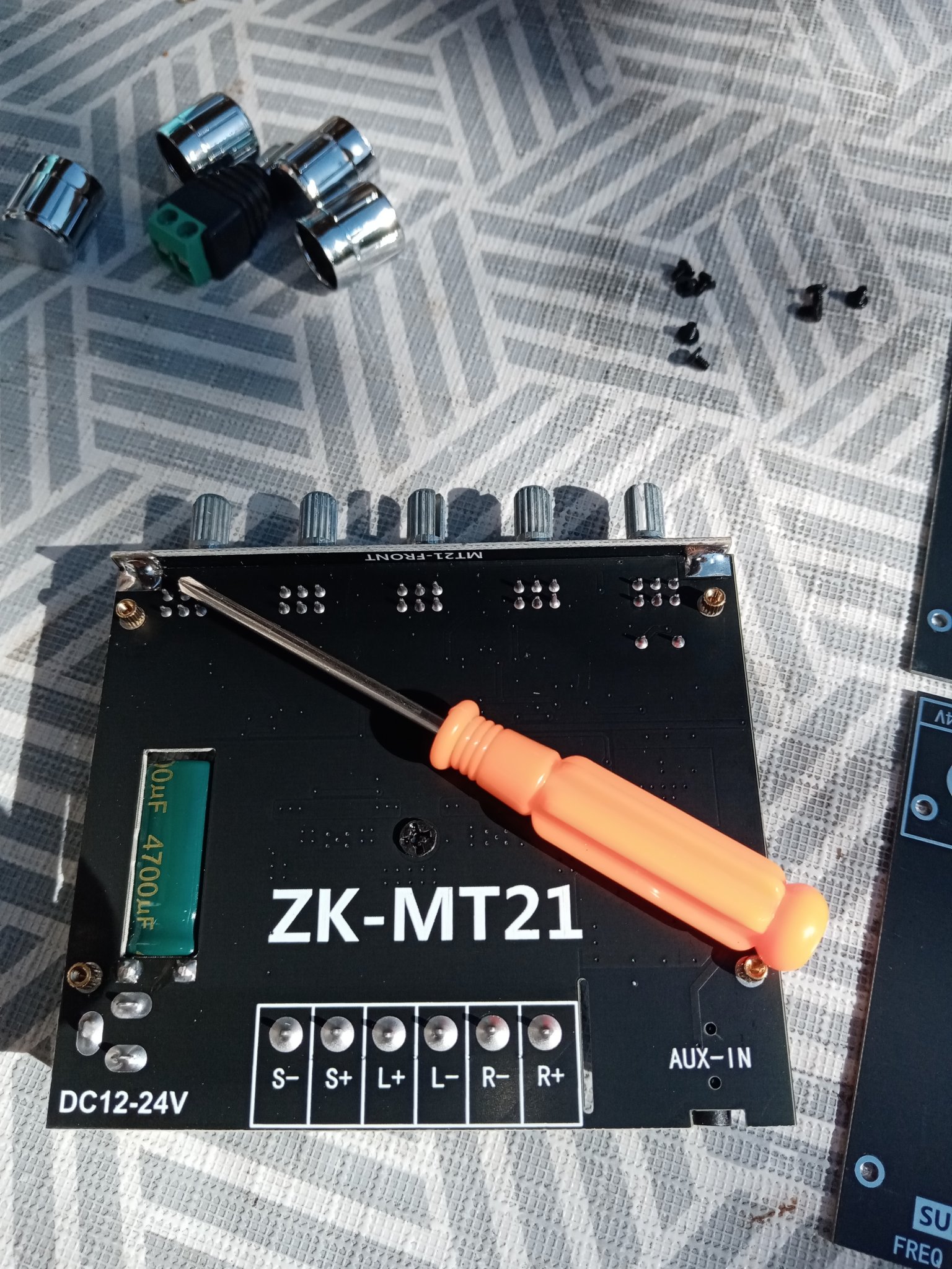

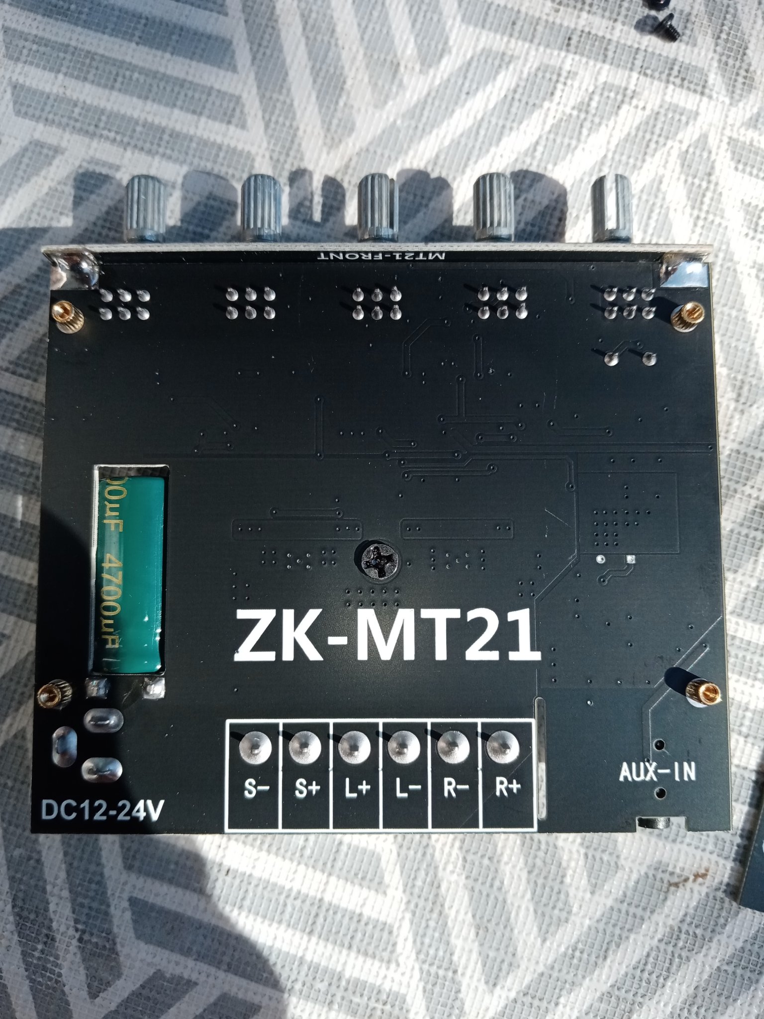

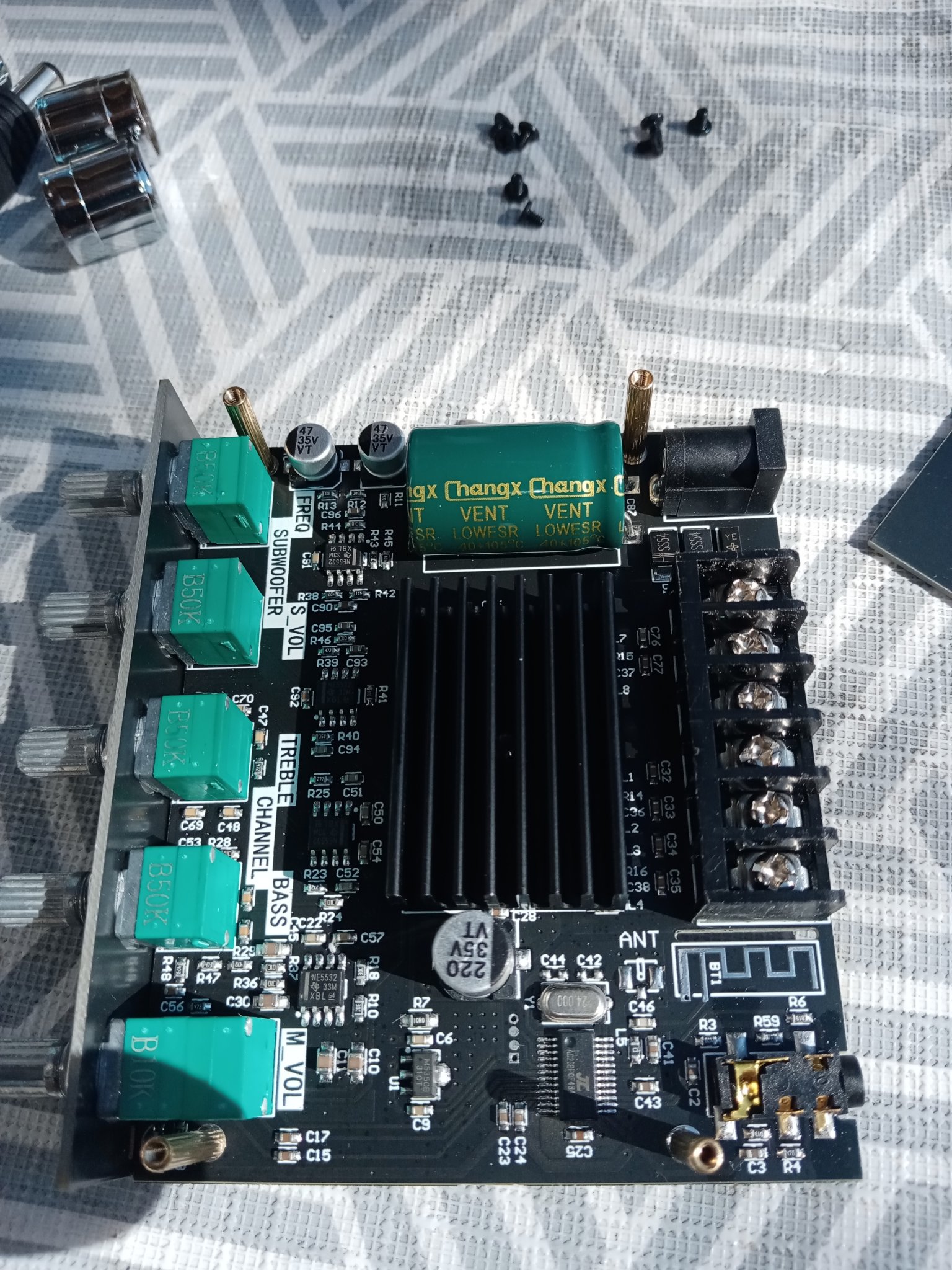

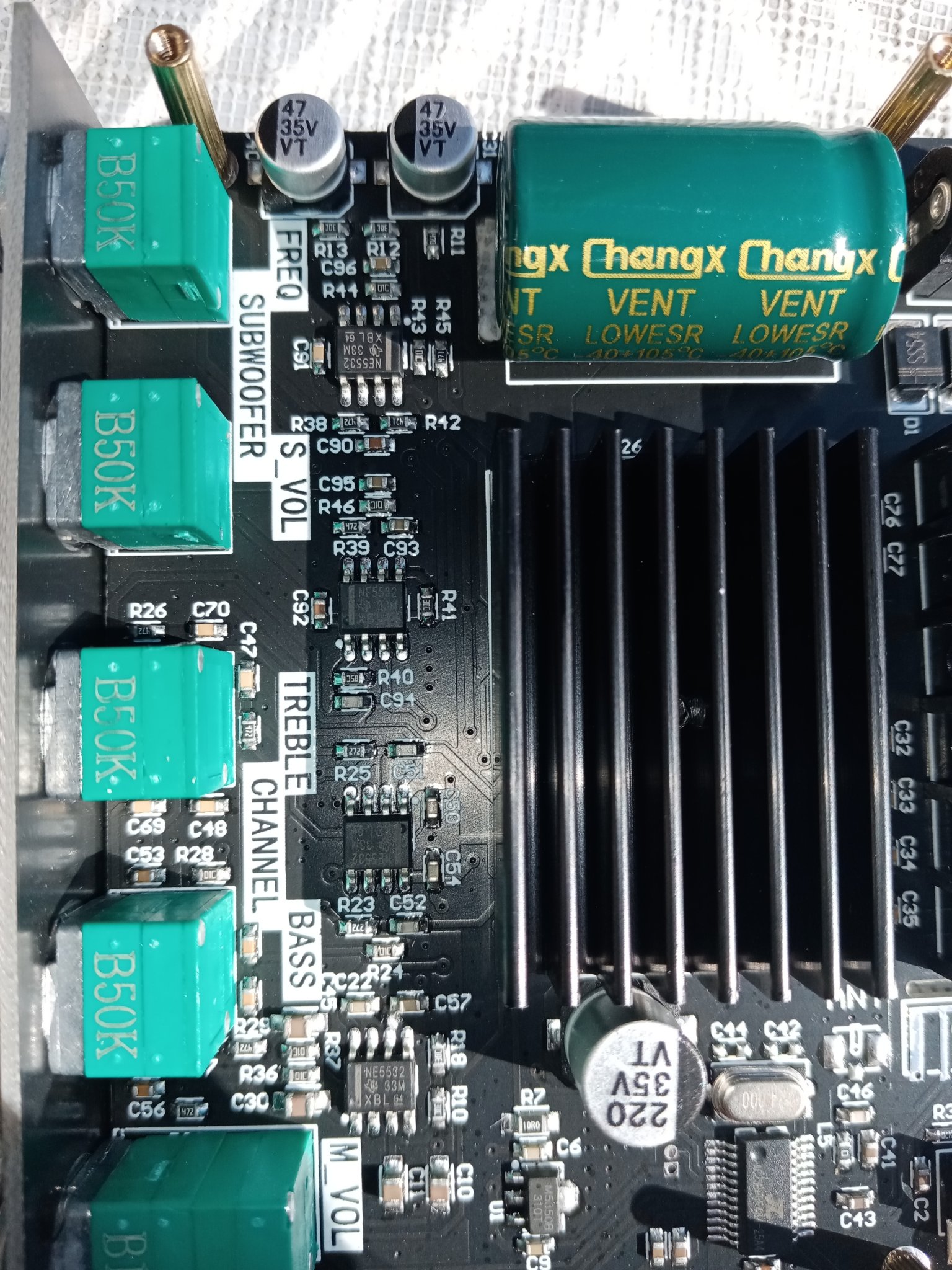

OK. Just tell me what I will find. I will not remove it. I do not know how to fix it again. Some heat conducting glue or not?
It's not going to be a 3116, more likely it's a CS8673.
It's a 16-pin configuration, as opposed to the usual 32-pin TPA3116. That's why there's no inductors.
There's no heat-conducting glue, just normal thermal paste.

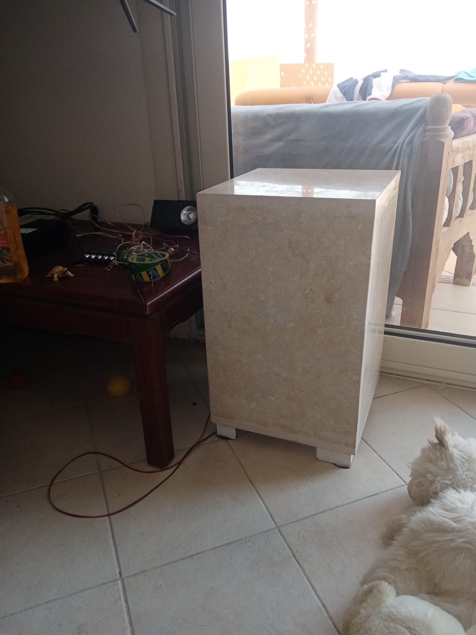

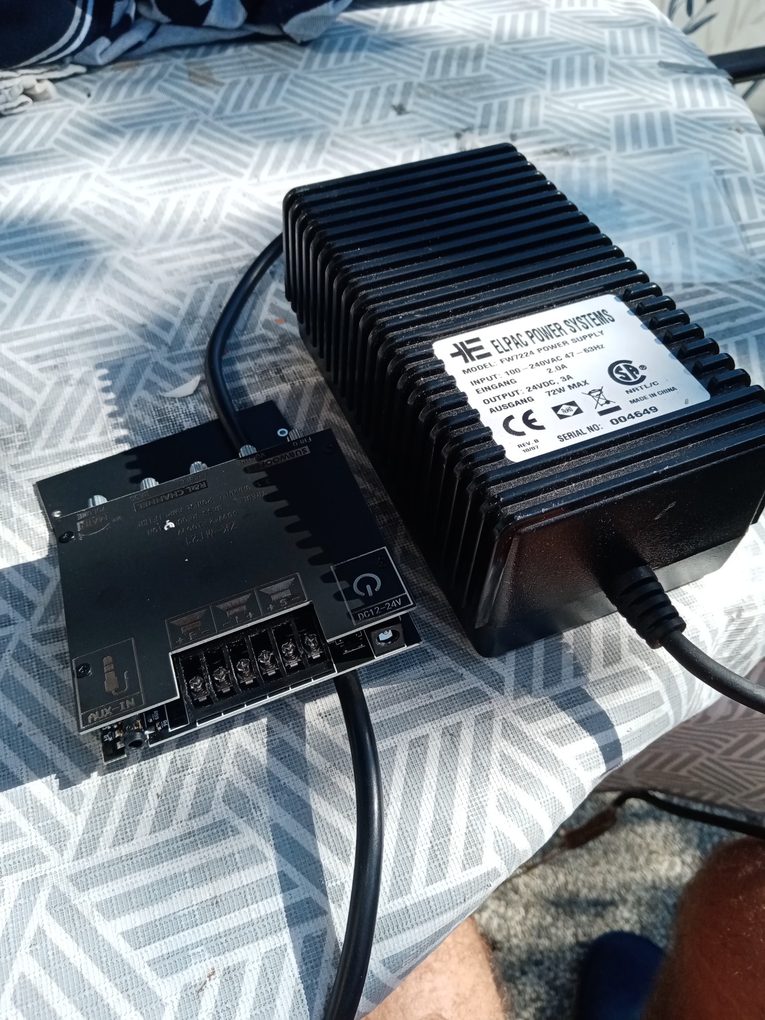

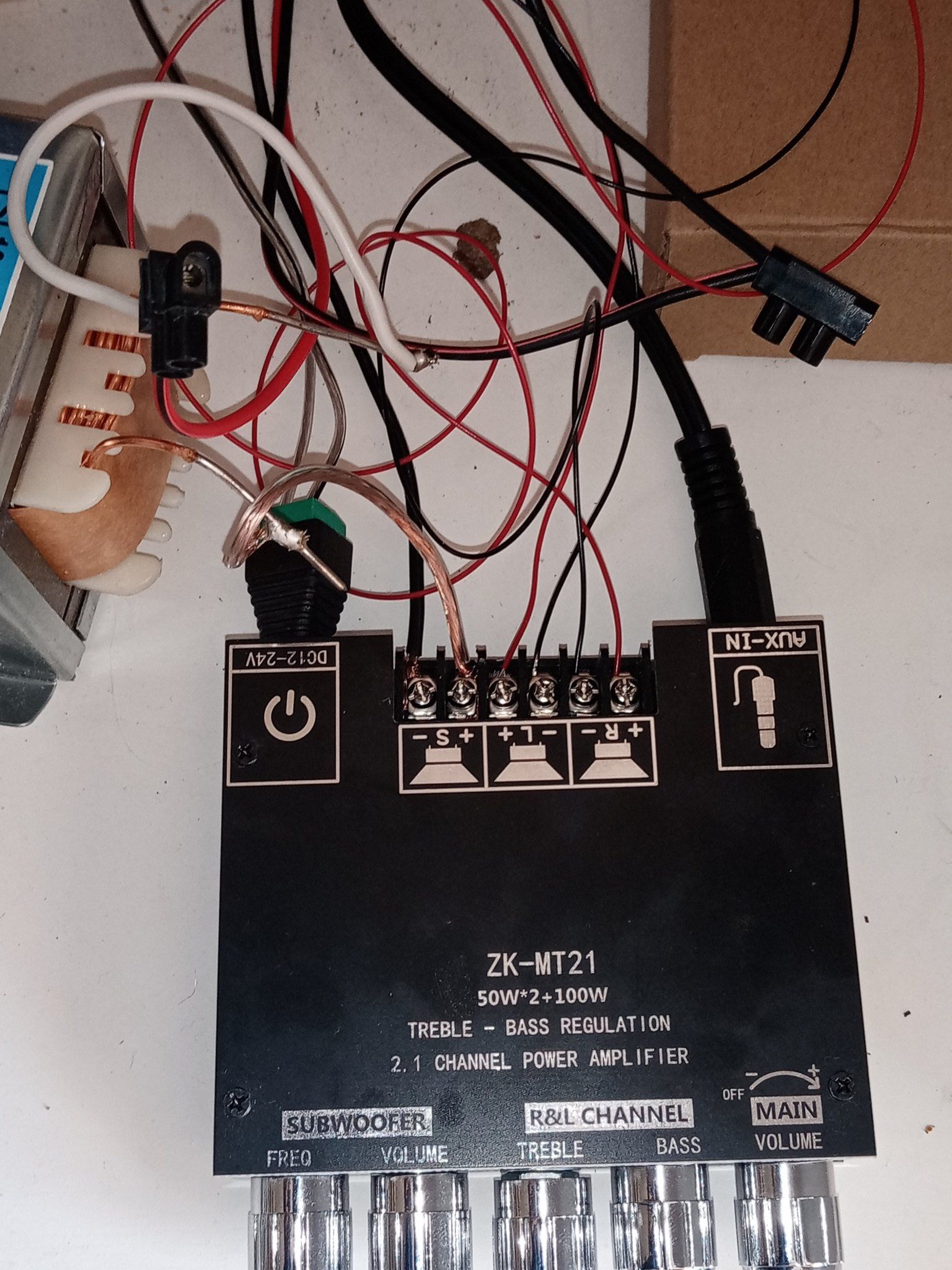

This amp zk mt21 works now in a similar setup like this:
https://www.diyaudio.com/community/...ription-subwoofer-gallery.207217/post-7494416
And it sounds correct with 22volt 2.5 ampere smps.
No hum, noise or popping sounds.
Good quality sound not limiting the good loudspeakers I use.
They must be crazy selling this quality at this price. Or you can say the new small D amp chips offer crazy quality.

ZK mt21 sounds not much different than zk tb21 with the same speakers (in a different room). Absolute quality of sound is good enough for me.
Wondered myself because zk tb21 has some inductors on the output. It's a bit bigger and has 6800 microfarad on the power supply input. Zk mt21 a bit less with 4700 microfarad.

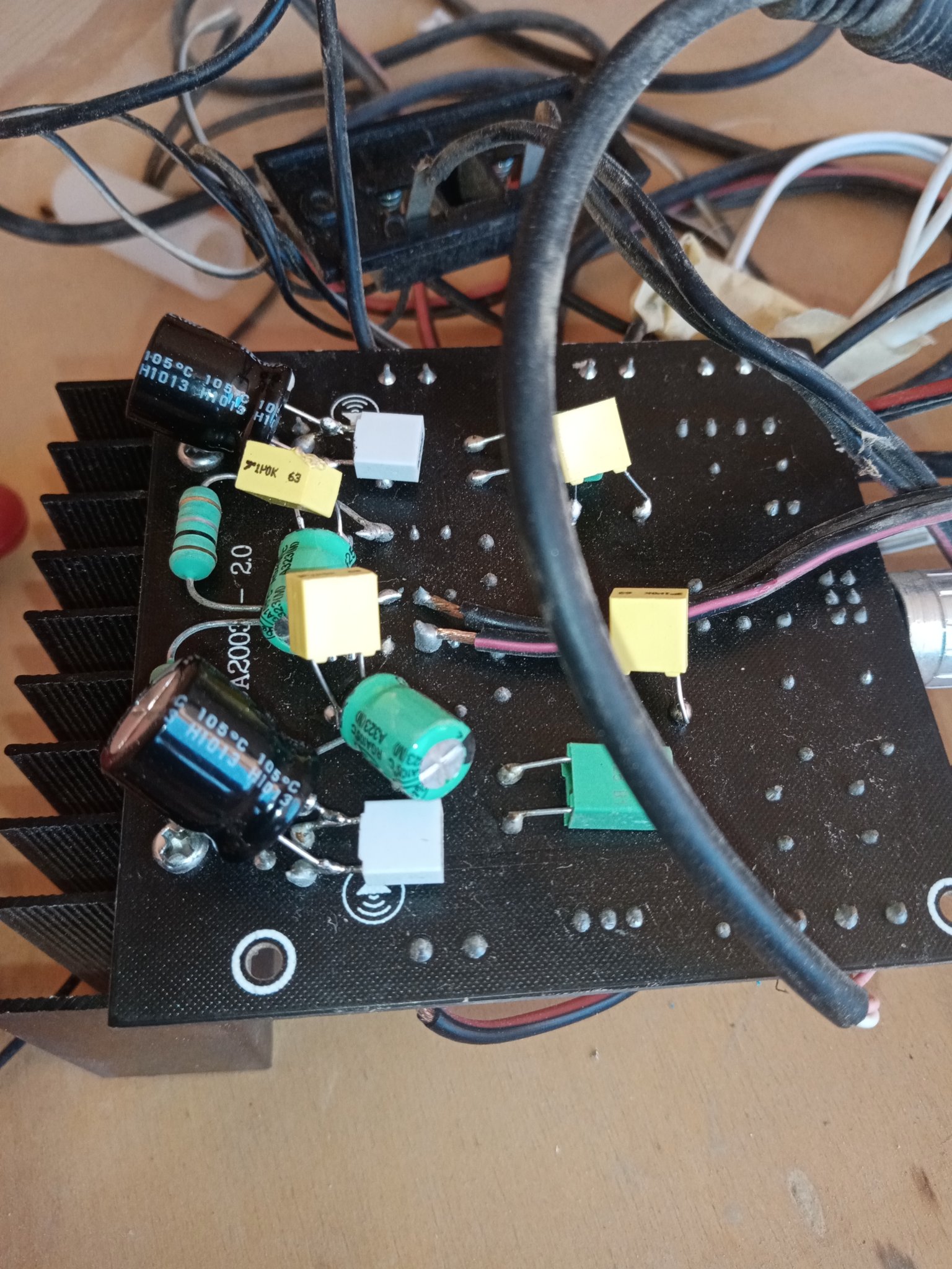

In comparison with a TDA2003 chip amp it's better working right out of the box.
With the tda chip amp however you can change it to current drive and get other sonic benefits with loudspeakers which have no copper Faraday ring on the pole piece. 99% of all loudspeakers in the world have no distortion reducing Faraday rings.
https://www.diyaudio.com/community/threads/corner-horn-meets-open-baffle-cfa.398842/
Chip amp modded to basic current drive a la Esa Merilainen

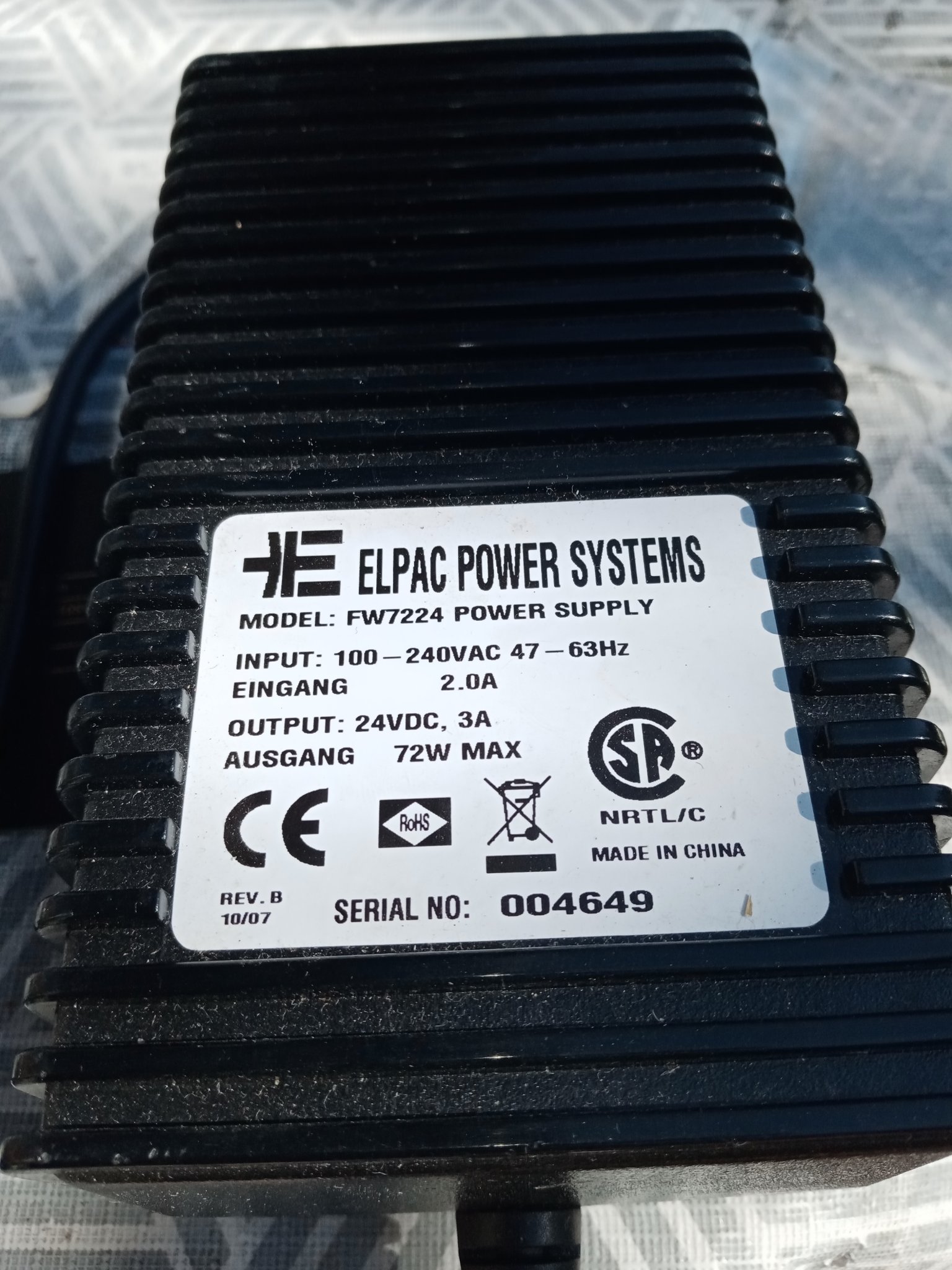

I have both in use zk tb 21 and zk Mt 21 both are dead quiet and sound perfect. And they can play loud and undistorted.
I guess I have good smps one 24v 3a and the other 22v 2.5a.
Maybe you have low wattage bad/noisy power supplies?
I am really content with my 3116 amps
Got them cheap from Aliexpress as initial offer, each for 10/12 euro

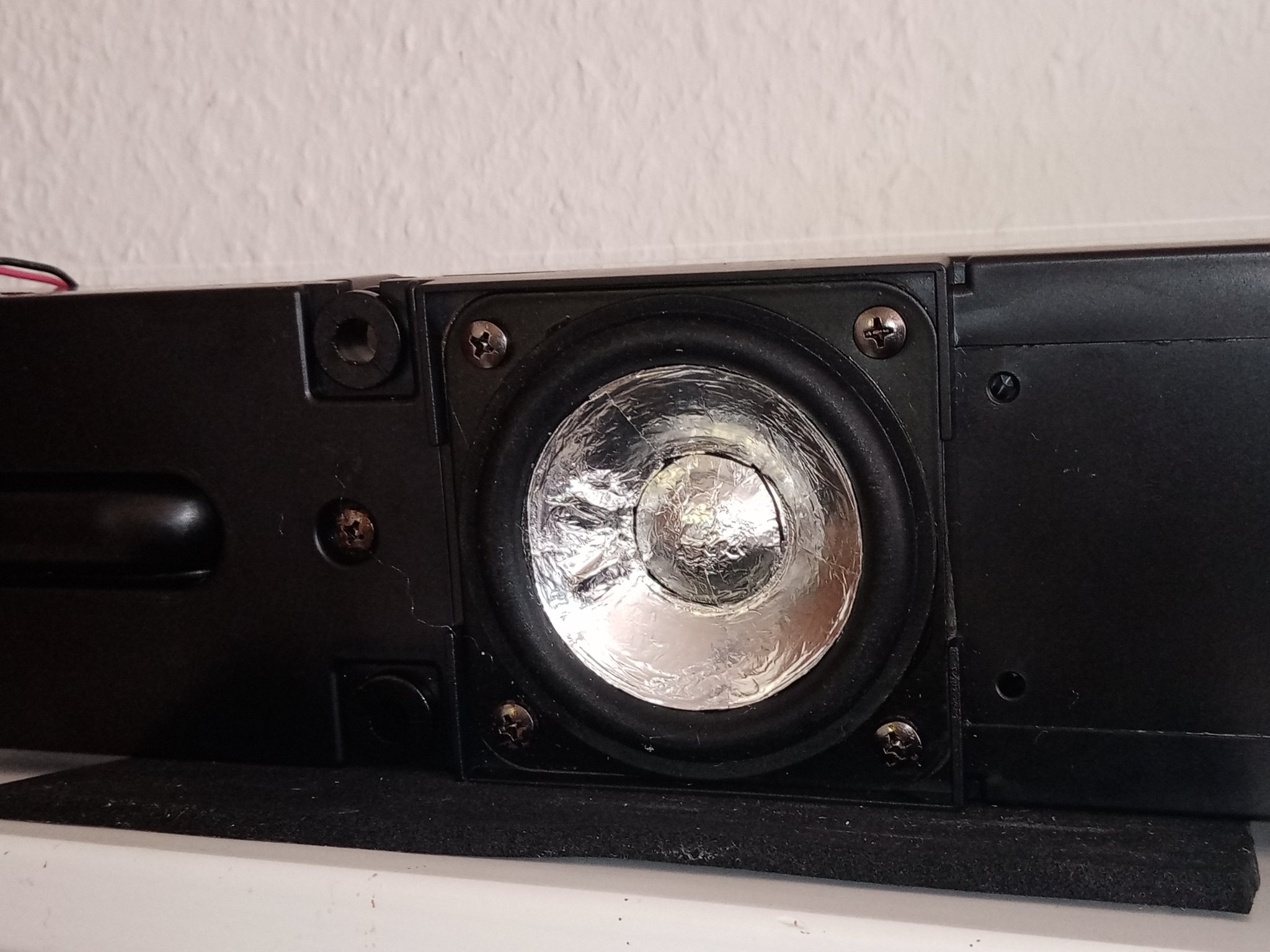

The small 8cm paper cone drivers have a Faraday ring and are sandwiched with aluminum foil. They reach in original state with nearly no faults from 70 hz to 18khz (measured them years ago). They have a 6db 340 uF filter and a well damped box with a controlled loss due to damped reflex canal with foam. Placed against the back wall to eliminate baffle step. The sub is adjusted by ear.

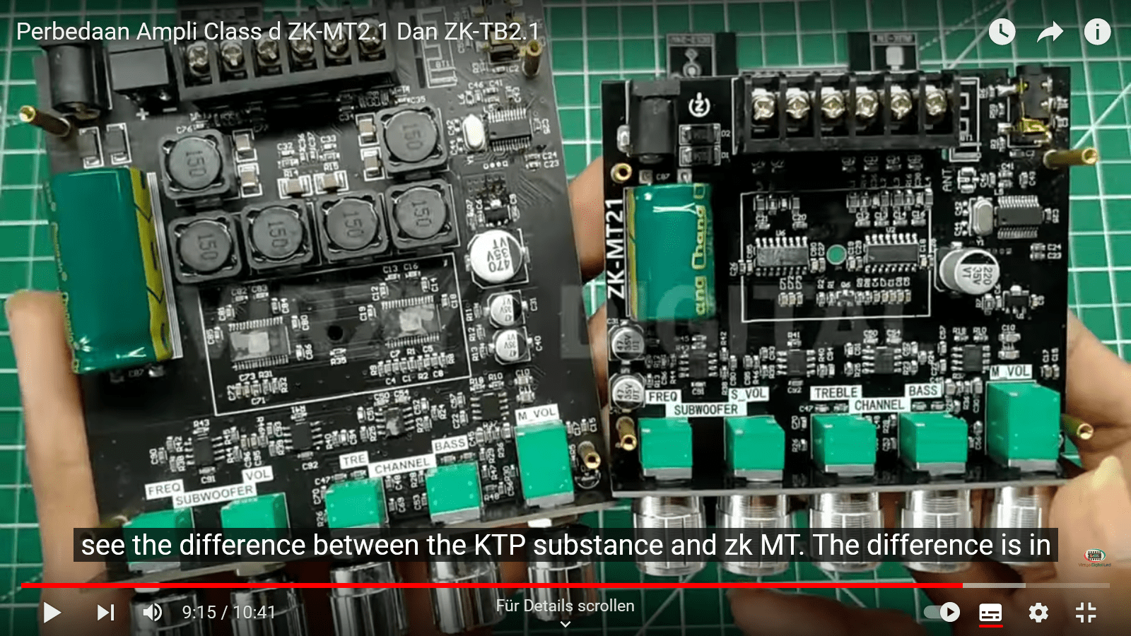

ZK MT21 (CS8673) and ZK TB21 (TPA3116) in comparison
Here the ZK MT21 is technically examined:
As the output filter was dimensioned too weak it has noise on the output.
What is the effect of this noise?

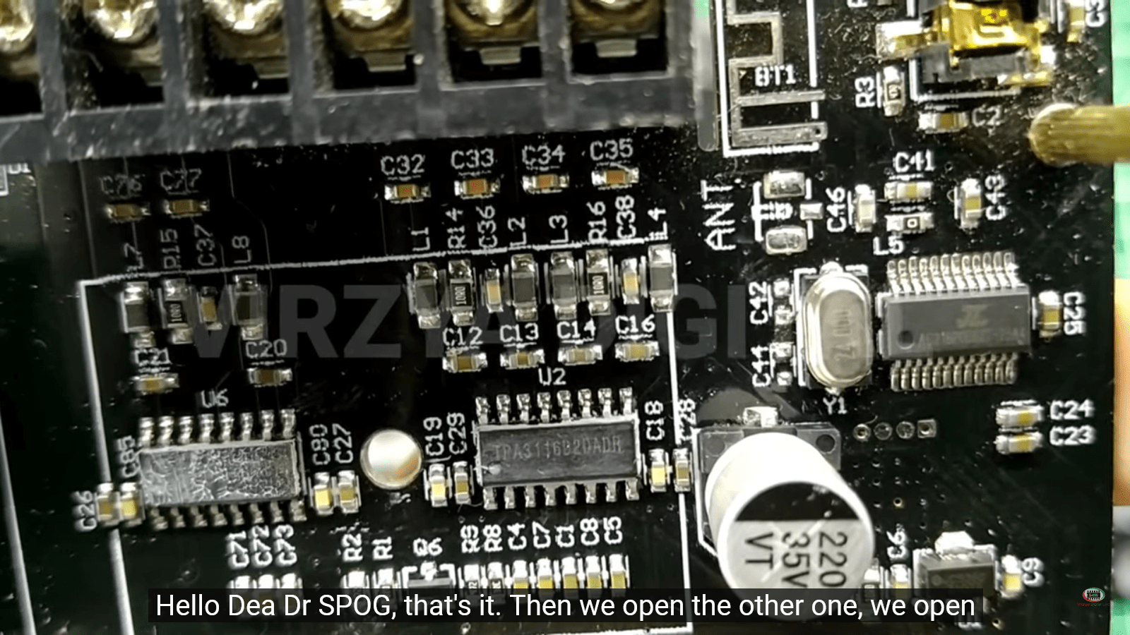

Here its opened and the CS8673s are to be seen on the ZK MT21, its written 3116 on it but its obvious that its the CS8673

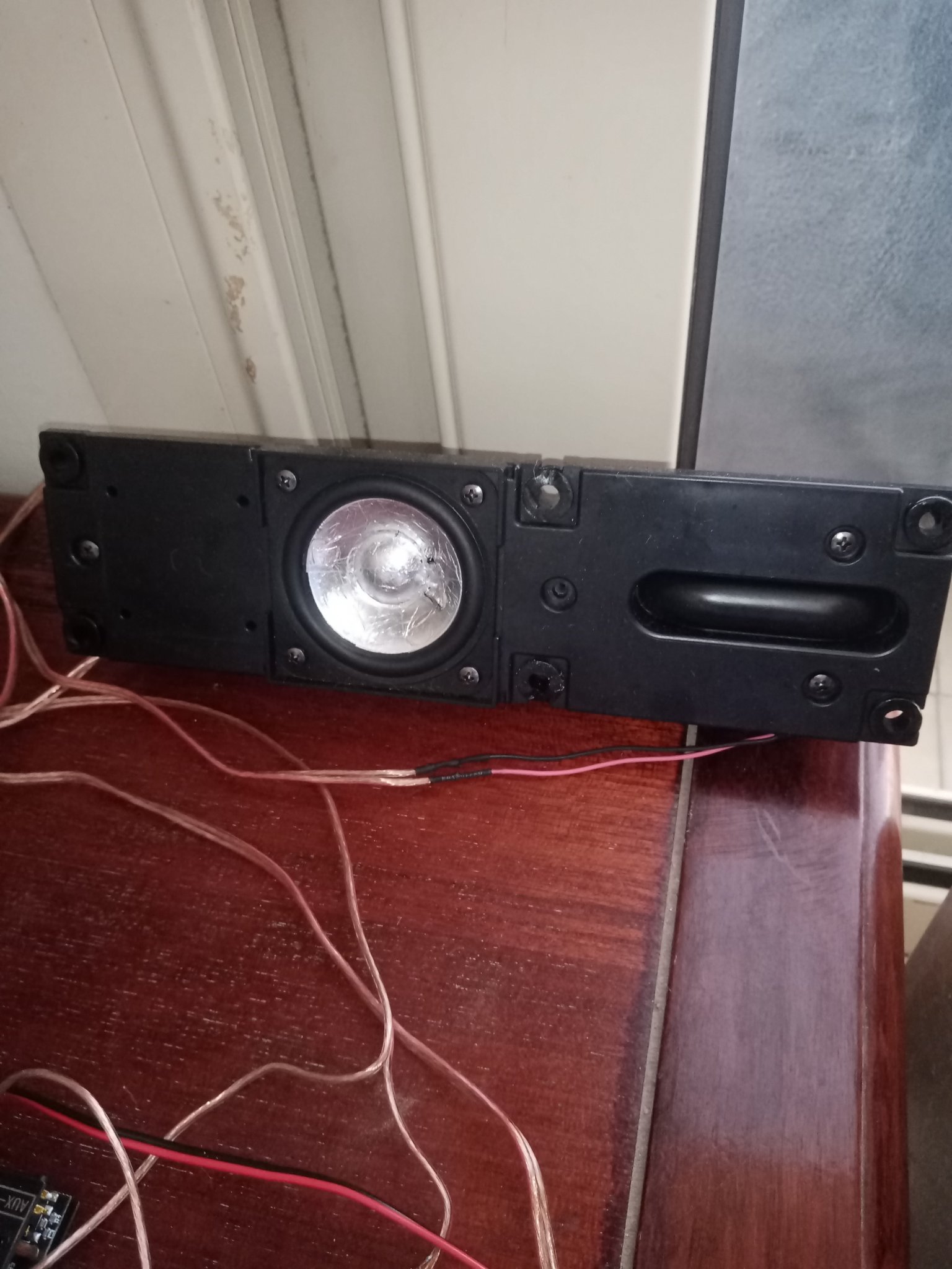

Converted a pair of Mauhorn 5 to subwoofers, added ten millihenry inductivity and put them in series for 12 ohm operation.
Two four ohm fulrange loudspeakers which are naturally linear close to back wall with aluminium tweak of the paper cone for my televison set. The 8cm JVC fullrange drivers (kapton former, faraday ring on pole piece) come in with an enclosure made for TV sets. With the right damping they go pretty linear with 6db filtering down to 100 Hertz (measured).
The amplifier has a clean, controlled and impulsive sound. Source is a meanwell 6.5 ampere 24 volt Smps.
It certainly is not the best sounding amplifier with a class D chip but does a decent job.
I wonder if the lack of proper output filtering is really a drawback, see post 15 in this thread.
Amplifier works well without causing any strange artefacts.
