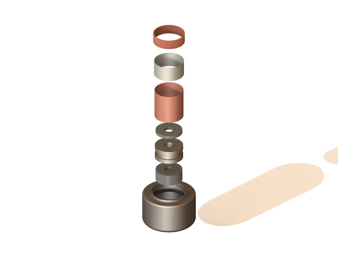

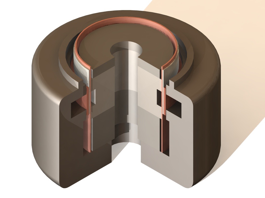

EDIT: Zaphs site says the Adire Extremis 6.8 uses a shorting sleeve right through the motor. Ooh pictures here! https://aranmaracoustics.com.au/extremis.html

Inductance management via shorting rings is the same in both overhung and underhung motors. There are plenty of overhung motors that have shorting rings through the gap, not just above and below the gap. An overhung motor that has a full pole sleeve has a shorting ring in the gap.
It is very beneficial even in an underhung design. For some data on this, take a peek at my underhung neo radial subwoofer project that employs a full aluminum shorting ring throughout the entire motor: https://www.diymobileaudio.com/threads/aurasound-ns15-ns18.455165/page-4#post-6100900
