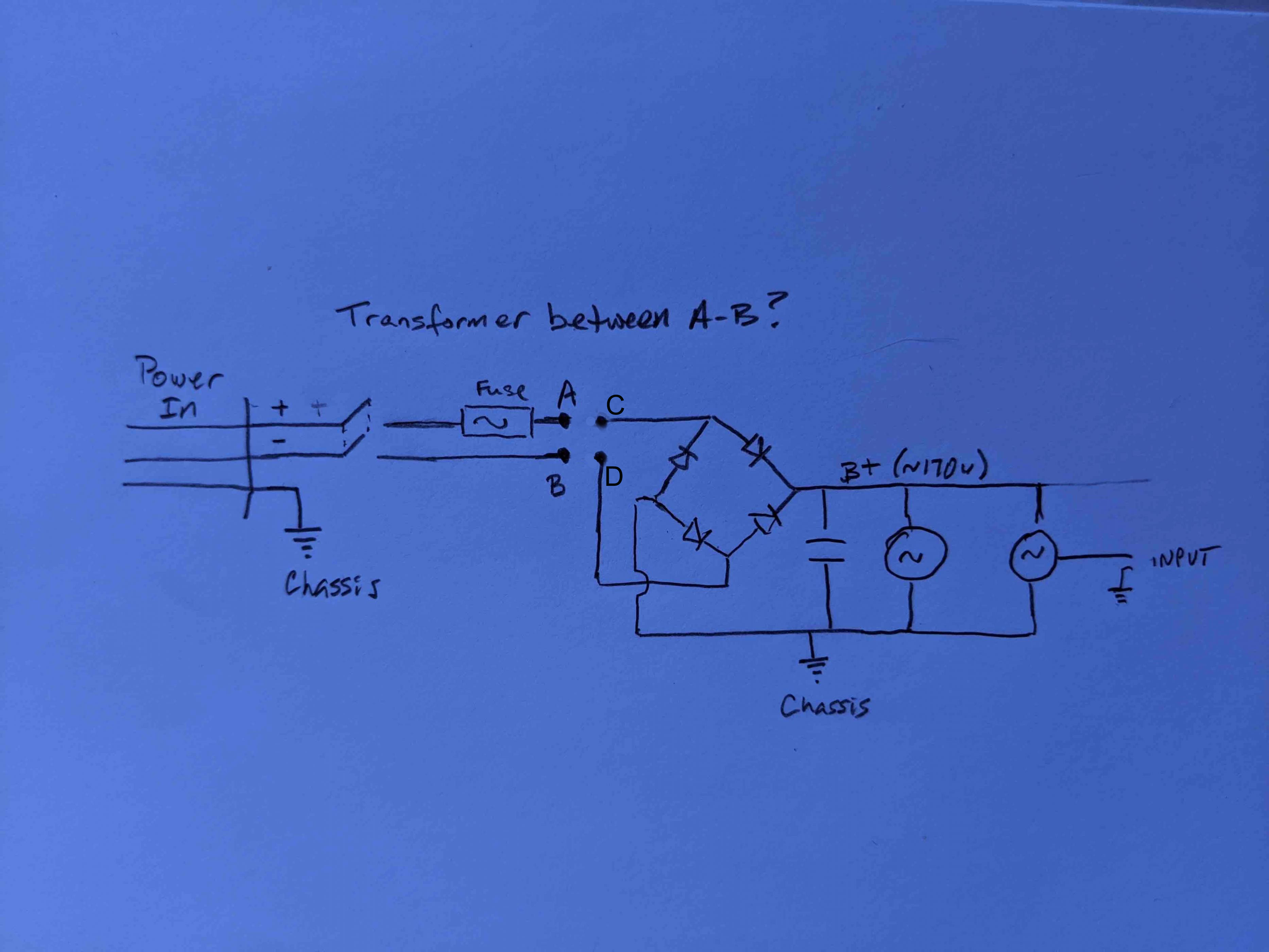

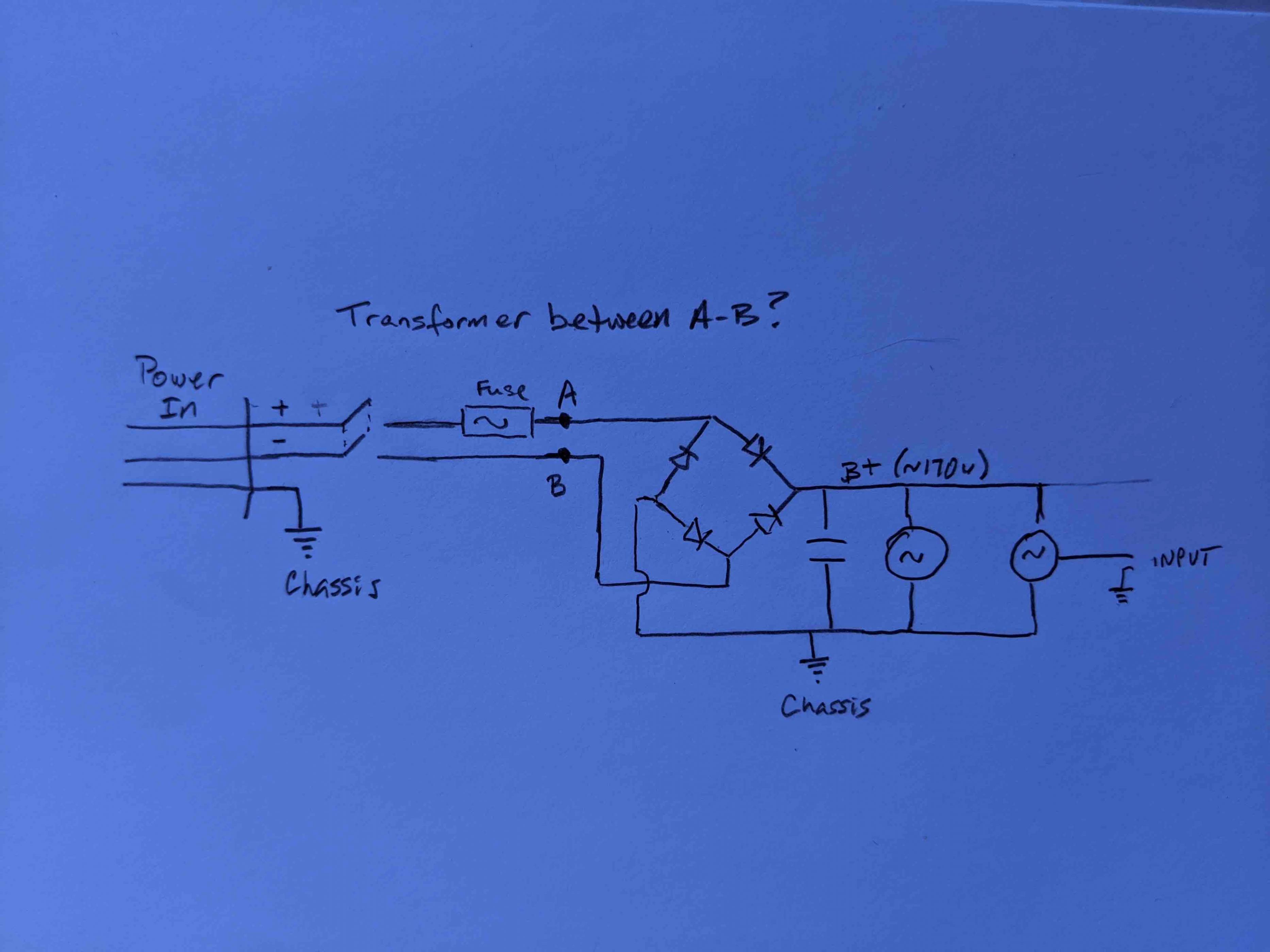

I bought a bunch of All American Five radios with the idea of gutting them, essentially just keeping the vintage shell and the chassis. And then building a small 1 or 2 tube amp with bluetooth input. Basically a vintag-y tabletop bluetooth player for gifts. (Yes I realize that it would be cheaper, easier, and probably sound better if I bought a bunch of Chinese class-d amp boards, but my friends all know I build tube guitar amps, and I can't go around giving them all guitar amps!). I don't need more than 170v so I can use an admittedly-inexpensive 120/120 transformer and a solid state rectifier, but then I got thinking....
First of all, I totally get why the AA5 design was a safety disaster, and I get why iso transformers protect the against the situation where the presumed-neutral wire shares a common ground with the circuit (because it may in fact be hot). But...
If the picture below represents my design without a transformer, what is the advantage of putting a transformer between A-B? I'm trying to understand the scenario where the transformerless design is less safe. Are there other considerations (noise, etc).

So, I'm getting close to understanding this. My question is: why does the same problem not exist on the primary side of the transformer? I had thought the isolation issue was primarily one of a potentially hot chassis, but I'm coming to understand the risk is larger than that.
Wall current should flow from live to neutral, which it does through the transformer primary. You are not allowed to let current flow from live to earth! That only happens when something is faulty, and you have home circuit breakers that sniff out when this happens. Your bridge rectifier would break the rule. (Notice that transformerless vintage appliances only use half-wave rectifiers).
You can get a 'hot' chassis with a transformer, but it's the difference between 'hot' meaning you are accidentally connected to the AC wall supply, and 'hot' meaning you are accidentally connected to the amp's DC power rail. The wall supply is 'trying' to get to earth and can supply many amps. You are earth. The DC power rail, on the other hand, is only trying to return to the transformer, not necessarily through your body. Also, it is much more current limited.

One last question: you say line voltage can't come into contact with earth, but aren't the neutral ground and the ground wire connected at the service panel? I thought that electrically they were identical, except that the ground wire was reserved for ground faults.
Frank, that's actually what I meant, I was just too lazy to show both sets of connections. But thanks.

I'm getting closer. (Not to believing you, only to understanding). Here's where I'm still struggling. In an amplifier, we attach the ground/earth wire from the wall voltage to the chassis, which also effectively attaches the neutral wire to the chassis. We also attach the center tap of the transformer secondary to the chassis, as well as our circuit ground(s). So it seems like the circuit is not really isolated at all, except that the voltage risk has been reduced to half the secondary voltage, since the fault will now return to the secondary through the center tap (assuming there is one). So doesn't the grounding scheme in the traditional amplifier design undermine the isolating properties of the transformer?
Yes and yes. Yes in a general sense both neutral and earth are electrically the same. And yes, the ground wire is reserved for faults. Which is precisely why a transformerless supply is forbidden, because you're allowing current that isn't fault current to flow from live to earth. Why? It is inevitable because in normal audio appliances the 'audio circuit ground' is also connected to mains earth as standard, and the user can touch circuit ground during normal handling, which means he can become part of the live circuit. It's different for a double-insulated appliance where the 'circuit ground' is not connected to mains earth and the user cannot touch any part of the operating circuit.
When you use a transformer, live current can only flow back through the neutral wire, except during a genuine fault. When the user touches circuit ground he is merely touching mains earth; no ordinary current is trying to find it's way to earth through his body.

You show a fuse inline with active (hot), but not neutral. This way you shouldn't have a situation where only the neutral fuse blows and you have an apparently dead circuit which is still at active potential.
With this proper fusing and an isolation transformer, if active and neutral were accidentally swapped then the transformer would give galvanic isolation. Current wouldn't flow through just one side of the primary to the secondary due to the insulation between them. (Mount the transformer and the fuse close to each other, securely, and near the mains input.)
I didn't read all the replies in detail to see if this has been said already in another way, but if you look at the top left-hand diode in your schematic it will have its cathode connected to mains live, and its anode connected to mains ground, which is essential the equivalent of mains neutral. In other words that top left-hand diode is connected directly across the mains supply.
That's not the only thing bad about your schematic, of course, but it's a start!
Any connection between the protective earth wire and the neutral wire (which an amp connects to via the wall socket), is the regulated domain of the electric utility and is covered by the country electric codes.
The protective earth and the neutral may well be connected at some point in the supply, but that is not for you to 'utilise'. You can't alter that part of the electricity supply, but if you are concerned then call an electrician to confirm your house and internal wiring is acceptable.
The only common way your equipment is allowed to connect a device between Active/neutral and earth is when that device is specified and approved for such a connection, as exampled by EMI filter devices.
It is often illegal in countries to alter mains ac connected appliances without getting the appliance inspected and tested to allow it to then be connected to the supply. This is typically a very regulated domain in many countries, and why purchasing equipment should come with an approved tested sticker or marking, and why people risk their lives when buying second hand equipment or equipment built or modified by diyers or semi-professional sellers if the mains cord hasn't been cut off or a sticker applied stating that the equipment should be tested by a competent person first.
