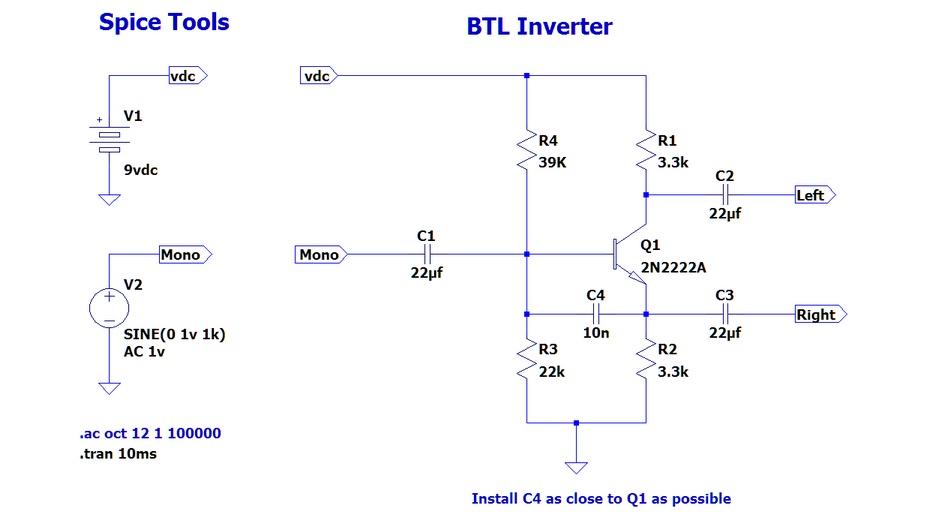

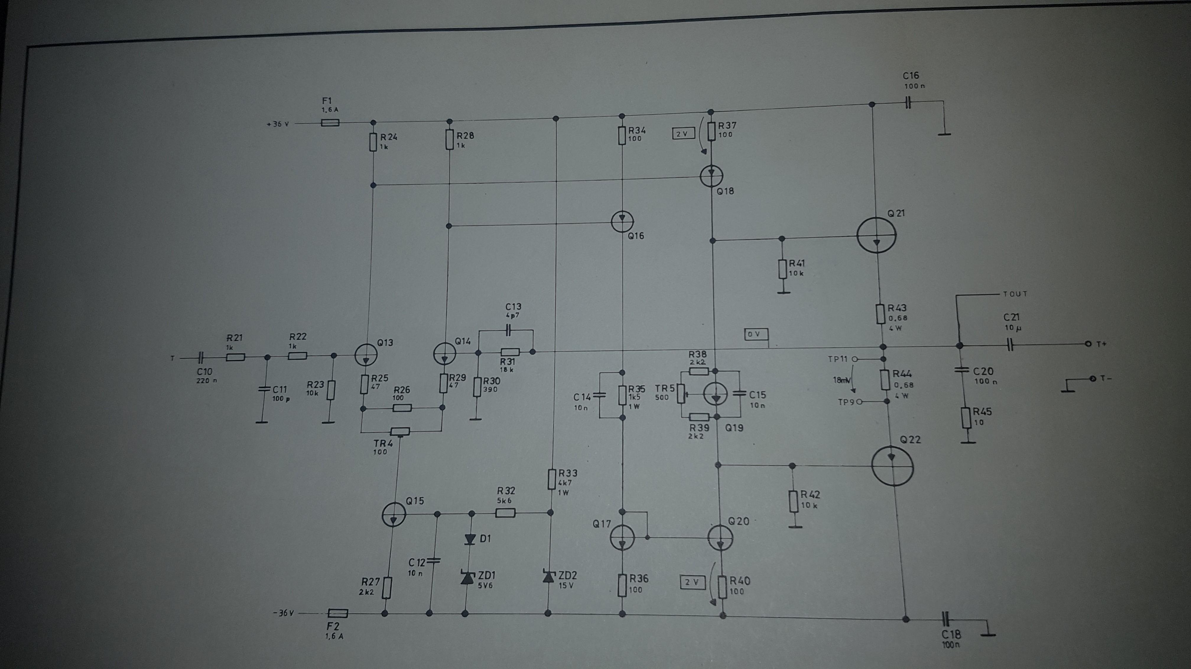

I have two examples of schemantics,
First is the input from Xlr to 10k input potentiometer &12db buffer IC
Second is a tweeter amp
I have located the c10 from the plate, the "entrance" to the amp.
First question:
Is it at the c10 tweeter signal + and the ground is tweeter -??
So wires from these two points to the new amp gives me signal i need?

Yes the input to C10 and ground are the signal to that power amp.
You can created an unbalanced differential signal on XLR by connecting the cold pin to ground, hot pin to single-ended signal. Its not great, but it will work. Otherwise you'll need an opamp inverting stage to produced balanced outputs.
The 2N2222 isn't the best choice in that circuit, a nice high gain transistor would be better at being balanced (assuming matched resistors). Alas a simple transistor circuit introduces some distortion compared to the opamp circuits.
I've used that circuit with a variety of transistors over the years and it seems to work well enough.
And that C4 bootstrapping cap doesn't do a good job as it loads the input with the output.
Actually C4 is there to shunt RF off the base-emitter junction to prevent audio rectification. The value is probably a bit high, 47p might be more appropriate.
Couple of more questions:
Will i have some phase issues by putting new/different amps in? ( i am a noob, remember reading somewhere that all the amps change phase)
In the first schema, is it so that i get full signal before crossover from the IC pin1 (to j2 - 1) .. so pin 1 + ground -?
I have 10 pcs of these plate boards broken, so i could make stereo amps, using input&power from the broken boards
