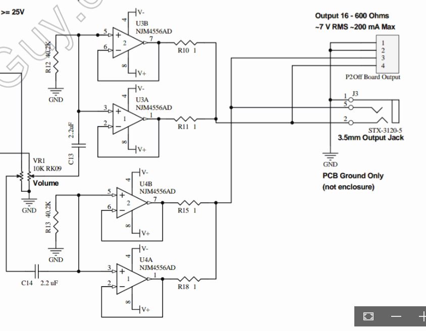

A unit gain buffer consisting of a couple of opamps would drive 300 ohms and have an output impedance close to zero over the audio band. All circuitry has limitations on frequency response but suitable opamps would easily extend way over the audio band and also go down to DC (if you wanted that). Cost for parts for a buffer could be around $10-15, say two opamps and a decent volume control. Then you need sockets for input and output.
You also need a power supply which could even be battery for this. Or there is discrete using separate transistors. That could be very simple too.
Its one thing coming up with a simple and suitable audio circuit... the harder part is designing it properly so that there are no switch on/off thumps and noises etc. All doable but it adds to the complexity and cost a little.

For an opamp buffer all you really need is the output stage of this... and its just classic opamp text book design. Two dual opamps and a few other resistors and a volume control. It would accept a line level input directly.

So you really just need something like the opamp buffer I posted. Two dual opamps, 2 caps and 6 resistors. You could easily build that and test it using batteries to see what you thought of it.

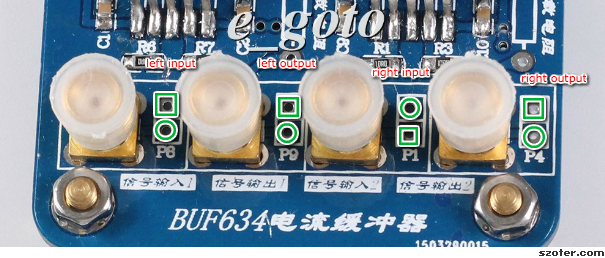

I'm attaching two pictures of the BUF634 module to resolve another unknown. My intuition tells me the circled areas are points where I can solder my own L+R inputs and outputs:
But if you'll notice the square and circle pads are inverted on the right input:
What do I make out of that?

After several inspections I finally realized the 4 golden elements at the bottom end of the PCB are SMP connectors, so I now understand where the signal goes in and where it comes out

I don't know why the pads are as they are on the board. It might be just to do with the board layout of the copper traces. It would become more obvious when you actually examine one I think.
