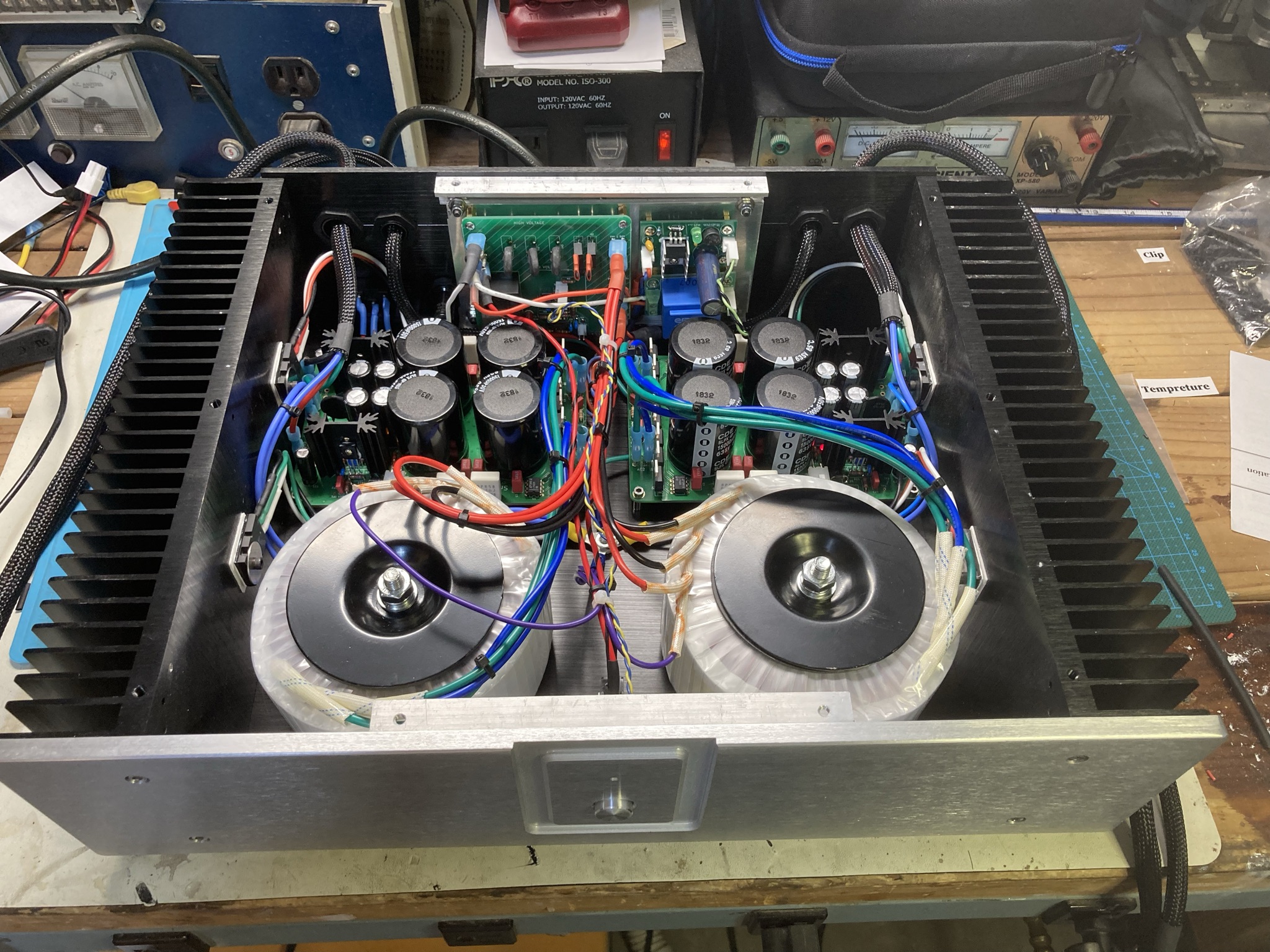

Planning to build an outboard power supply (dual mono, 2x 400 or 500va trafo) to power various projects - Aleph J, F5, F6, etc. and beyond. Logically, a +/- 24V output is the ideal.
I had thought originally to put 2x UPS boards within the power chassis and send umbilicals up. They would sit close to each other the two, but the idea is a modular pass system so we can enjoy various builds without having to invest in redundant parts, larger chassis, etc. etc.

done before by several Greedy Boyz around
incidentally, rumor sez that Modushop Boyz are preparing Monoblock cases, not just case with heatsink but also adequate heatsinkless case, for outboard PSU
if you want stereo option - simple to choose from already existing cases - for amp use Dissipante 4U/400 , for PSU use Slimline 3U/350 or 4U/350
do not forget that amp need to have local cap bank ......... so you can arrange your PSU as CRC, where first C is in PSU case, R is umbilical, last C is with amp

Thank you Zen Mod - those are some tasty rumors indeed.
My thoughts exactly - work off the existing cases they have, tempted to make a mini dissipante work for the amp stages. I have some small fans for most of the amp locations since its relatively poorly ventilated, the quiet fans work out beautifully.
Thanks for the note on the PSU - I assume that means bread boarding it Rectifiers, C stage + R - umbilicals out; and local Cap banks to V +/-

That is what I was currently planning/building. My amps are in a 4U 330mm x 300 mm enclosure. Power supply is in a Galaxy 330 x 280 enclosure below. Set up as a pair of monoblocks since I had two heat sinks. I am starting off with the M2x and the F6. Since the amp chassis is fairly open it should make it easier to remove the heat sinks.

This is the same thing I did with the external PSU for my VFET amp.Just get your grounding scheme correct. I grounded my amps to the chassis, my power supply to their chassis and then tied the two chassis together amps are dead quiet.

My M2x monoblocks are in 2 deluxe 4u modushop chasses with nice XRK SLB PSU boards. There is enough room to easily change amp boards.
If I were starting over, I would welcome 1/2 width boxes with 1 heat sink each, employing a central box with dual PSU sets. Moving half the cap bank to the amp boxes would allow bigger cap physical sizes. Then, it would be easy to keep the heavy PSU box located on the rack, and have sets of the 1/2 size cases with different amp boards for easy changing, with less back pain. Dual PSUs are a very expensive, and heavy, part of this fun.
