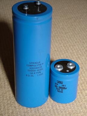

I have a choice of using one of two different types of capacitor. The larger is a spague compulytic made in 1982 - it was bought a few years back as NOS. I have charged a few up and they seem to hold a big charge OK, i've not checked for current leakage, but the capacitors have not leaked electrolyte and all seem to work as you would expect. I am happy to have a go at reforming them if need be.
The other is one of the "stubbies" bought in the UK Aleph-X group buy - they were made in 2000 so should have had far less time to deteriorate - there is obviously a huge difference in size for similar uf and voltage ratings.
What is the difference in use going to be between these capacitors and which should i use in my amplifiers?
Sprague made some damn good caps back then. I used a few 25,000µf 75V NOS caps in an amp I built last year. The date code was like Feb of '82 or thereabouts. I brought them up very slowly with rather large resistors to allow them to reform, and they work just peachy.
