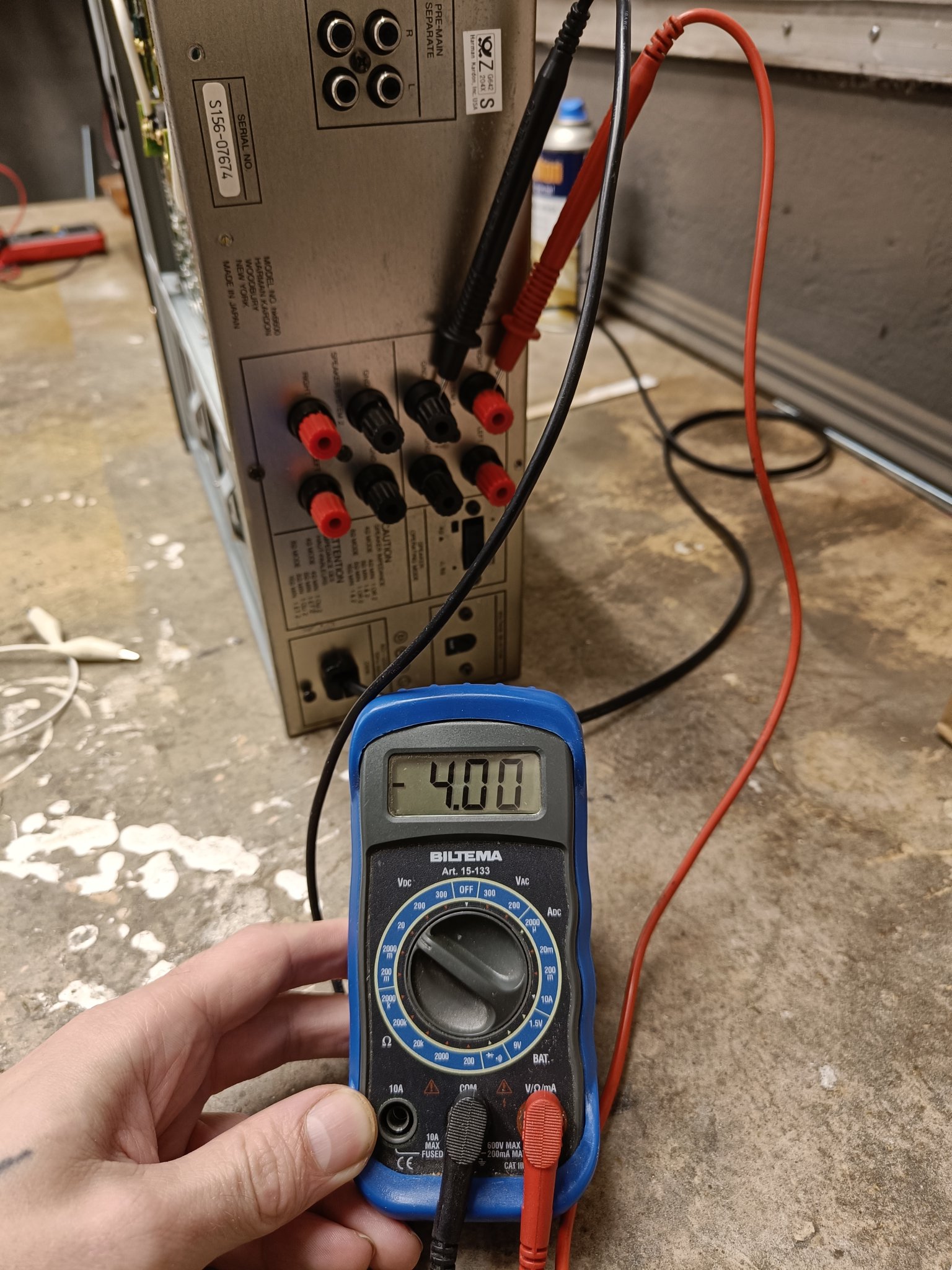

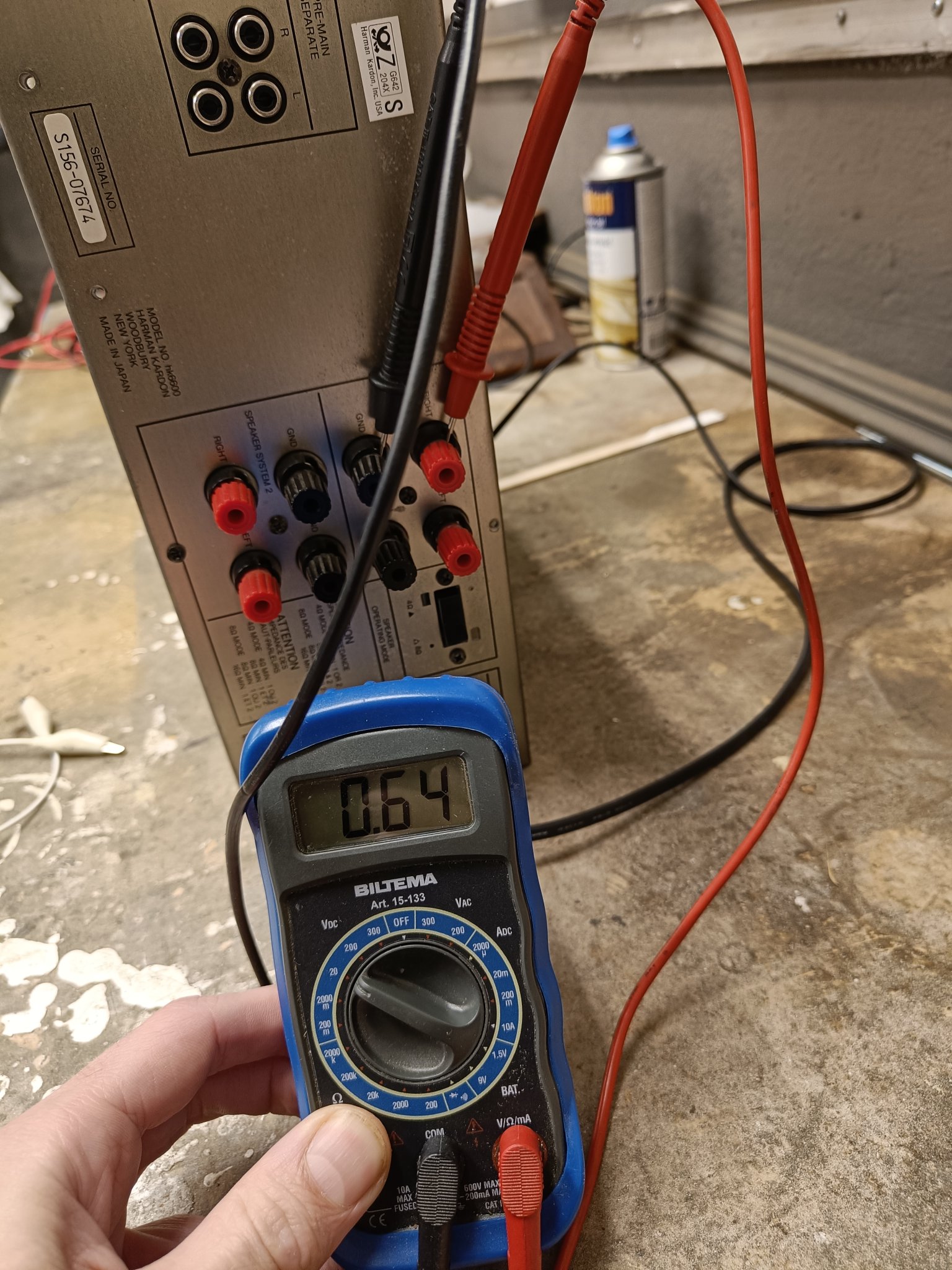

The multimeter reads + 4.5vDC on right speaker Channel - 4.5vDC on left speaker Channel.
it should read 10mv in 8 ohm and 60mv in 4ohm....
I have compared left channel with right channel with ohm meter they read exactly the same...
i have changed capacitors with incorrect value
leaky transistor maby??
anny ide whats wrong ? 🙂

Are you sure about the +4.5v on the right and -4.5v on the left, have you not reversed the touchpoints of your DMM ?
I'm sure 🙂 it's reads good for a few seconds when I start the amplifier then it goes up to 4.5v. I was looking for the differential pair transistors ore some transistors that's controls the voltage to the amp but no success yet

Are you certain the black ground meter probe is actually connected to ground?
Use the ground post on the back of the amplifier.
Post a photo of how you are connecting the DVM to measure the output DC voltage.
