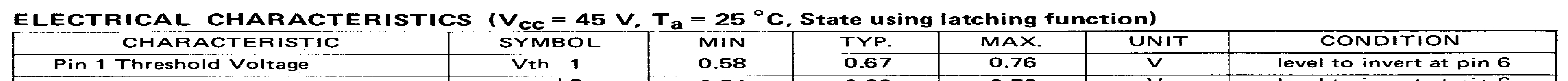

What they mean is that the overload detection circuitry is proprietory so they can't show it.
Pin one is a switching input that will switch off the relay when it is taken high. It's up to you to design a circuit that will make pin 1 high when there is an overload condition.

thank janneman,
Now what will happen if I connect pin 1 directly to the ground.
Pin 1 will be zero volts. The data sheet shows what will happen depending on the pin 1 voltage 😉
See attachment. What does it telll you? Do you know what pin 6 does? (Hint: look at the application schematic...).
