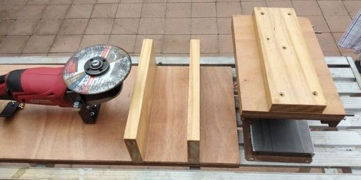

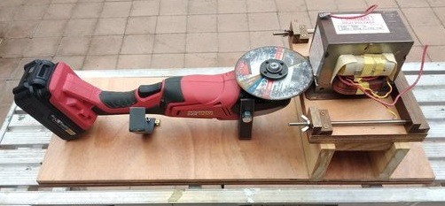

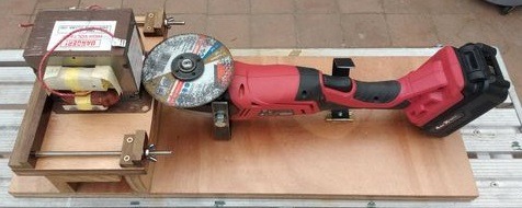

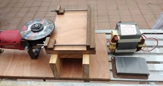

I to have been interested in recycling microwave oven transformers. I had trouble accurately separating the "I's" from the "E's" so I made a jig. The idea is to place the MWO transformer on the jig and then with the angle grinder not running adjust the wing nuts such that the cutting disk just kisses the transformer at both ends of the proposed cut, the grinder was started the wing nuts turned < 1/4 turn and a fine cut made, the wing nuts adjusted the same amount again and another fine cut made, this was repeated until the desired depth of cut is obtained.
It was found the weld depth of penetration is a fraction of a mm, except for the ends of the weld where the weld folds around the end and the penetration is much deeper.
My first transformer was cut much too deep before it came apart, the idea is to notch the ends of the weld before attempting to remove the "I's" .
The I's are often welded to a back plate that is easily removed.
Fine cuts ensure no heating of the laminations.
I cut a few transformers apart and have not yet made any transformers or chokes with them.
A dry lubricant is used on the wooden rails for smooth operation.

The iron on these is laminated, and it is indeed shallowly welded in several places. I only cut the two welds that were holding the "I" on though. I cut all welds on two other transformers so that I could separate all of the laminations though. I intend to try making power transformers with those at some point in the future, and I'll need to interleave the laminations on those. They're also coated in some kind of hard wax/varnish which can be burned off if desired. So they're not technically metal-on-metal when placed against each other, at least with the trafos that I have on hand.
Cutting these with a grinder is indeed tricky. One false move and you'll cut a gash where you don't want it. I have cut several others with a hacksaw though. It's prettier, but it's some decent work to undertake. I like the idea of a jig for the grinder though. I may have to look into that for when I'm ready to make one for real.

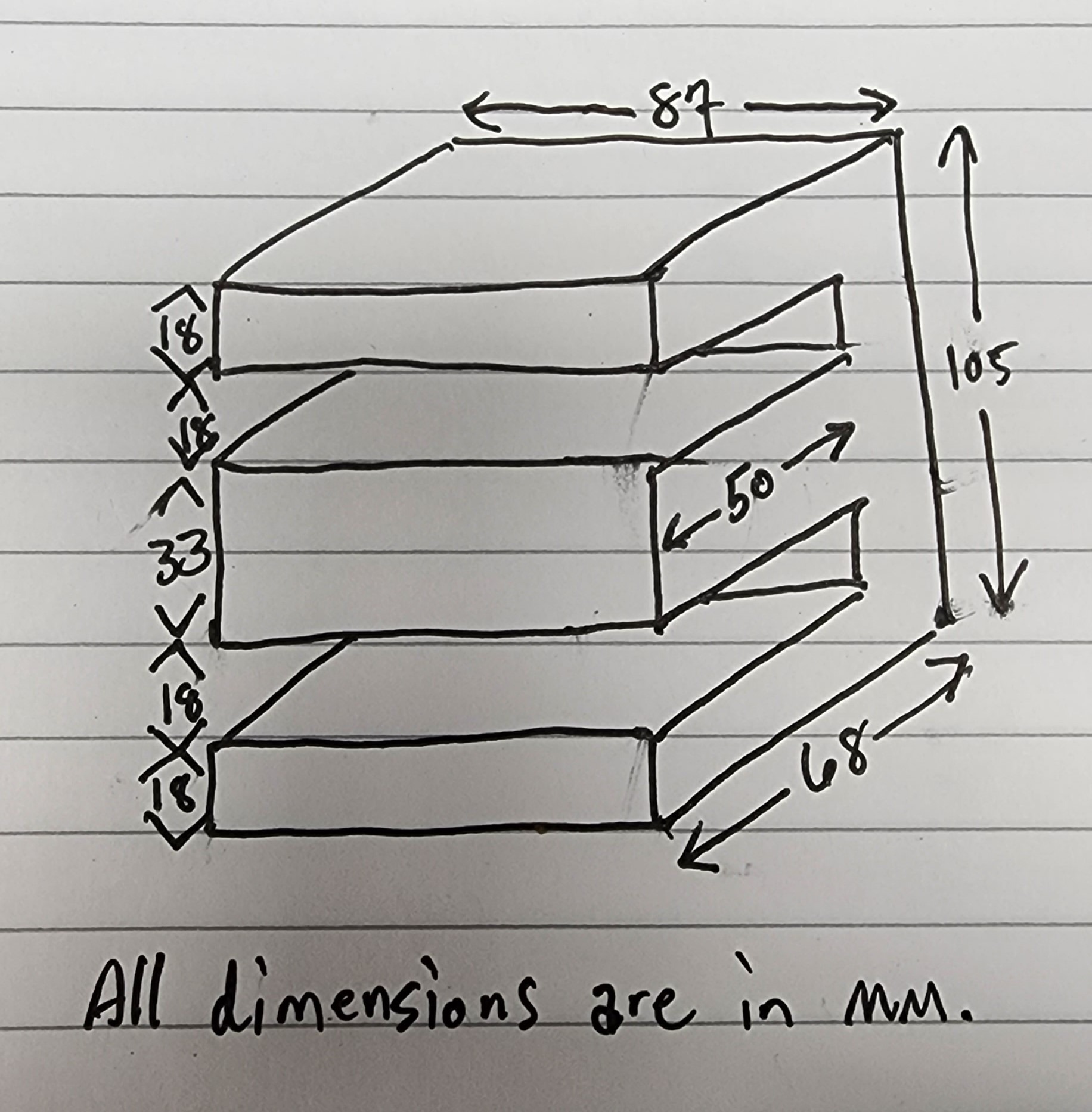

As for dimensions, I've seen several different versions. The one that I modified has the dimensions below. I don't know what standard size that it translates to though.

@JasonWatkins: Either you did some error in your measurements, or your laminations aren't standardized ones. Standard »lossless« EI laminations are stamped by a pair the same time or multiples of a pair. The two E parts are facing each other by their open sides, the I parts come from the winding windows. Hence, in a standard core of, say, 105 mm width (= height in your drawing), the window should be 52.5 mm deep instead of 50 mm.

It is 52mm. 52.62 to be exact. I thought you just wanted the rough size so I didn't get too precise. The only example that I have with me to measure ATM still has the original winding in it too, complicating the process.
