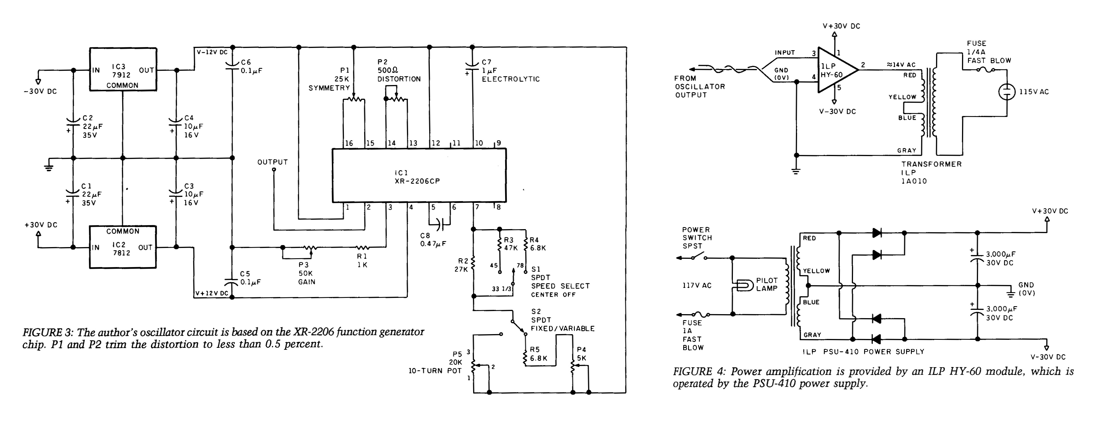

I also found the Gary Galo article from '86, and that project sounds very simple and affordable. I'm not so sure if those others do that.
Galo used an XP-2206 to generate 60Hz and 81Hz, fed into a 30W power amp, and the output into a 6 + 6/110v toroidal. Adjustment was quite straightforward and relatively simple.

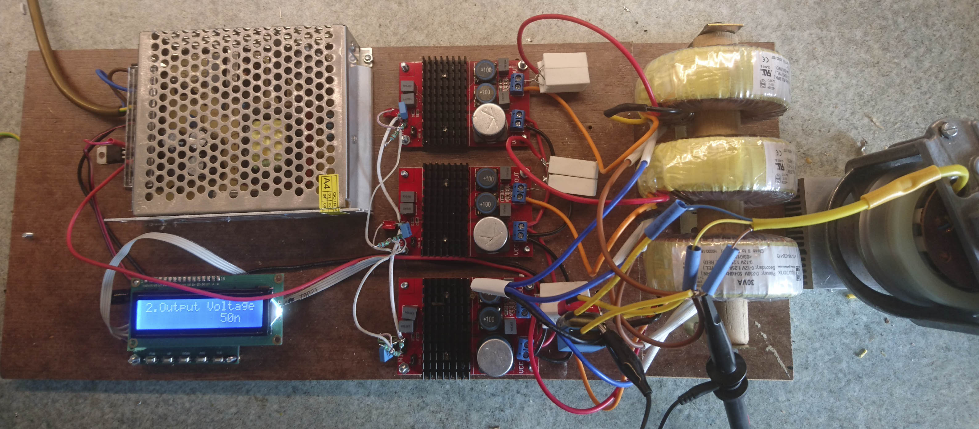

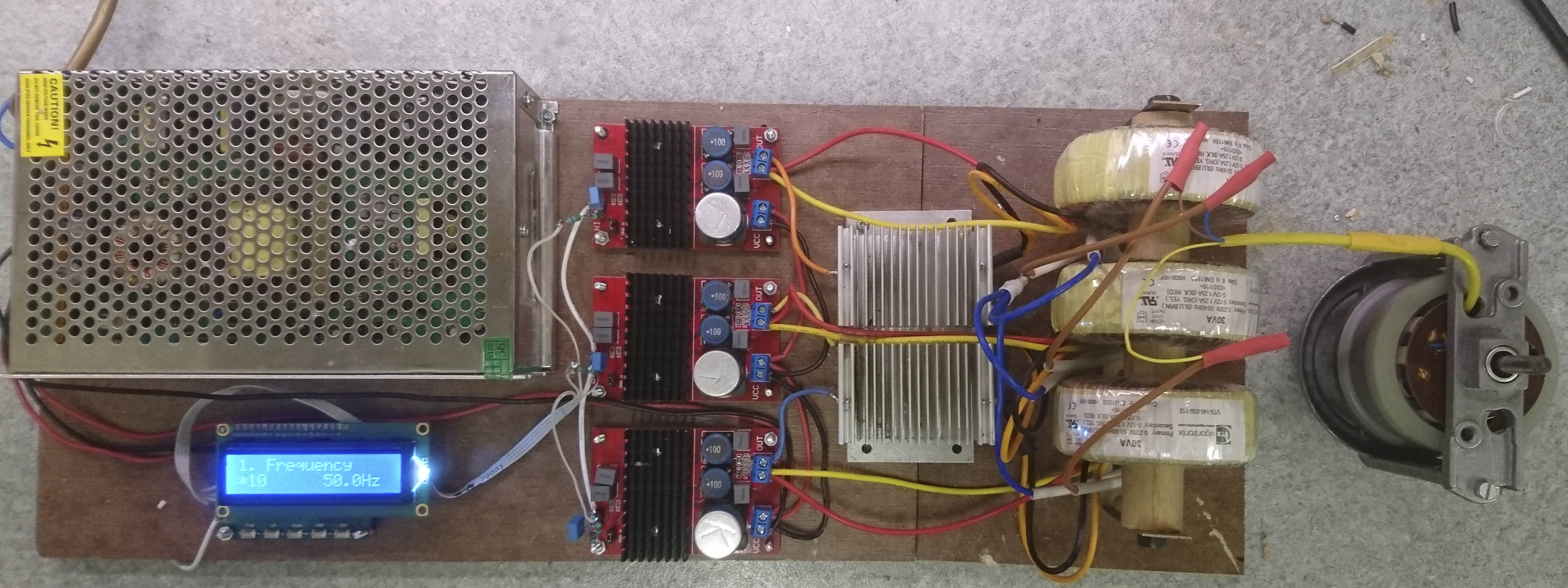

Yes, but only as a test bed at the moment, as soon as I get the latest firmware version of 'Pyramid's' chip I shall replace the E50 motor in my TD124 with a Papst 3 phase motor driven by his DDS generator, 3 x 100W amplifiers and toroidal transformers. (the generator in the pictures does not have the required resolution).
Here are a couple of pictures of earlier test setups
http://www.diyaudio.com/forums/atta...-vpi-synchronous-turntable-motor-dsc_0114.jpg
http://www.diyaudio.com/forums/atta...-vpi-synchronous-turntable-motor-dsc_0122.jpg

This is the schematic of Gary Galo's '86 supply. There might be better generators to try. I already found some analog ones, which seem to have better distortion specs. Also found some DAC chip based ones, but they all seem to need programming.
