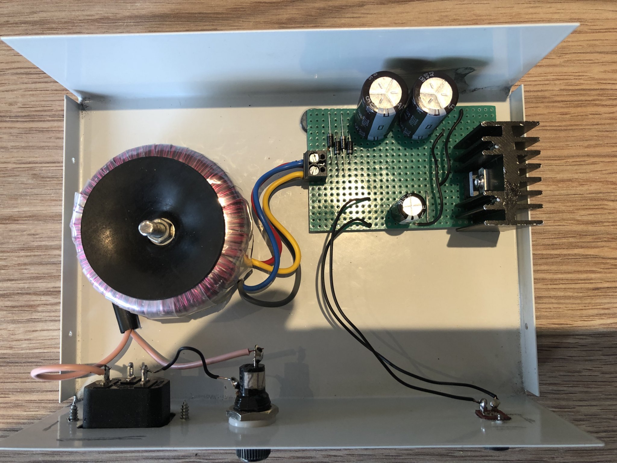

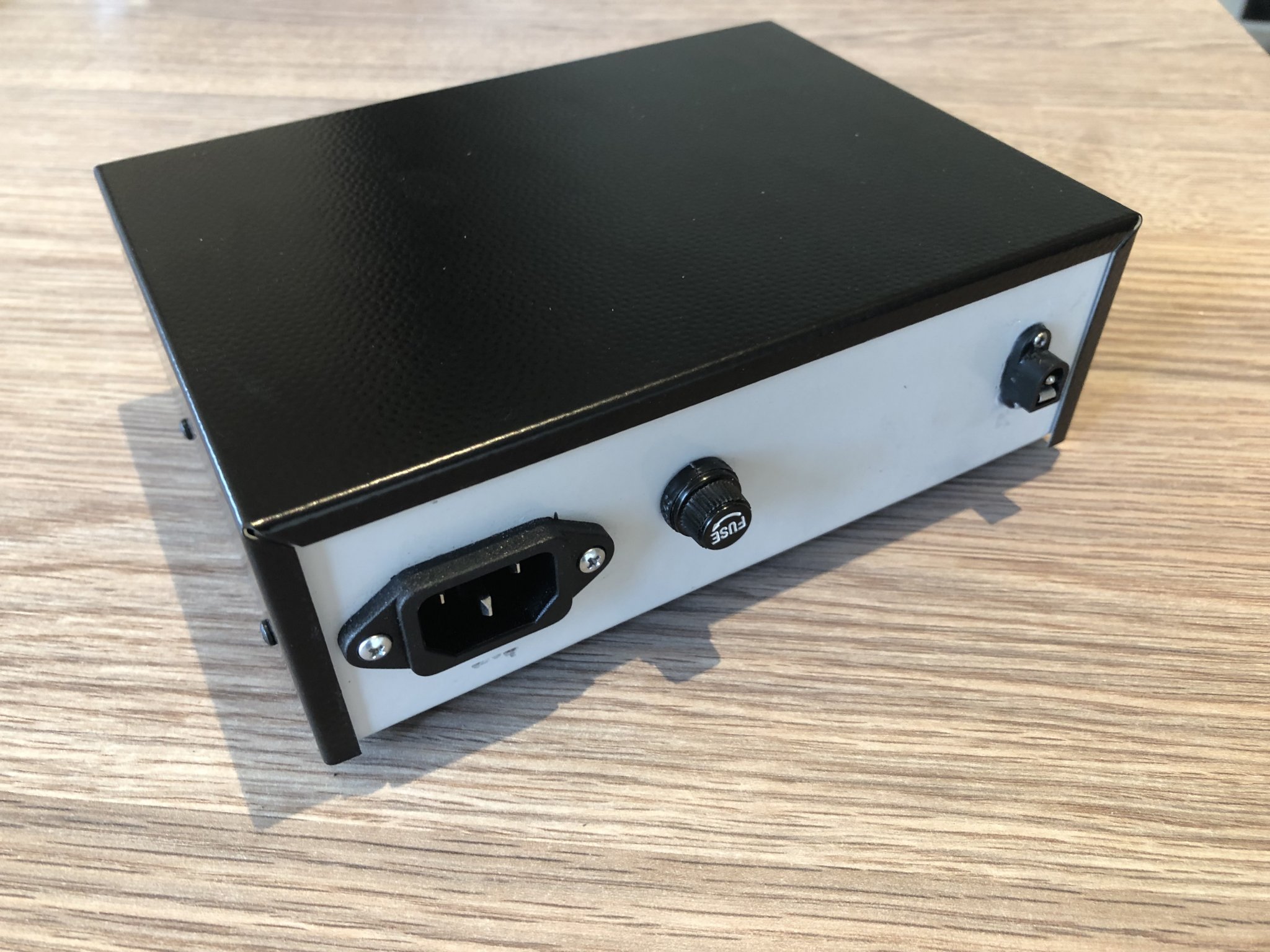

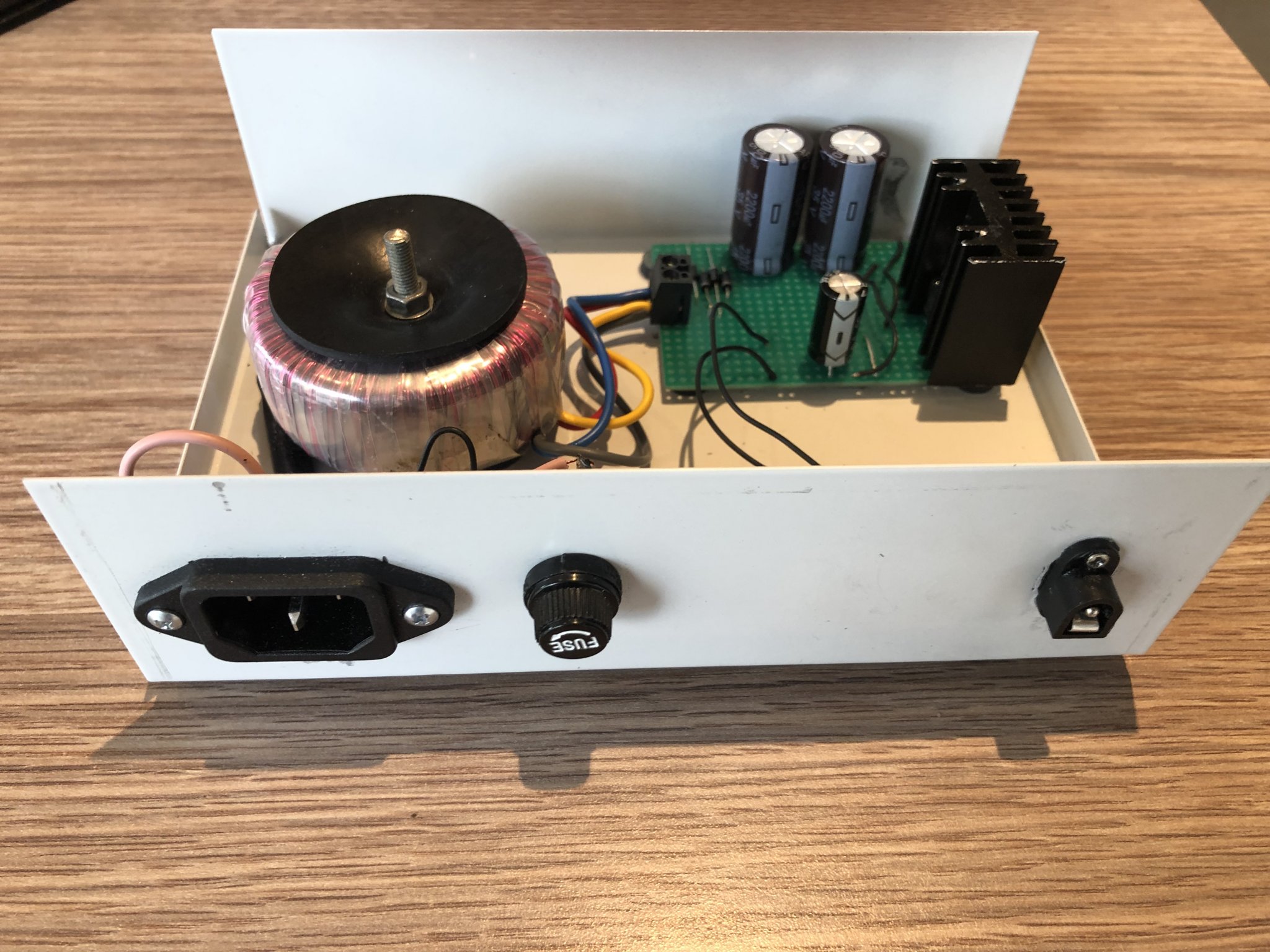

After reading a lot about to change the standard Power supply Build in into a seperate supply external i Build after searching And trying a lot this unit (see pictures)
As they said that it will make a hugh difference and peoples talked over the internet about a audiophile high-end dac i was sceptical about it
So I wanted to use the Apple IPad charger as L.P.S. with very low ripple and noise, regulated on the entrance (220) as it work well as a low cost power supply 5V
In the AirPort express I took out the original power supply and build a print with the LM1117 voltage regulator to regulate 3,3v needed for the AE to work
2 ceramic condensators of 100nF at in and out for distortion filtering a cap (normal Panasonic) of 10uF at the in and I had in my collection from an old tv a cap from Philips 100uF (audio appl) with low ESR for the output
So I was very curious and do the test ..
Well, i must say that this is a releave for me … the sound is superb with everything i ever wanted in it!!
Depth, detail, warm and clear sounding together what I hadn’t got in the paste!
Everything can change and also can be better but for know I must say that I am a happy guy 😁😁😁
Anyone with remarks? Anyone who did also changements to an Airport Express?
Please share

An interesting upgrade, though I wonder if it wouldn't be better to use an LT1963 or TPS7A4700 regulator.

The LM1117 is one of the more noisier regulators available. It is way better than a switcher but please note there are many LDO regulators with less noise and better specifications.
You have experienced the joy of linear regulation, now find out the finesse 🙂

I just looked at the specs of the 2 regulators you mentioned
Here is the result of the output generated noise for the 3 regulators:
LT1963 : 40 uV RMS
TPS7A4700 : 4,17 uV RMS
LM1117 : 30 uV RMS
So the TPS7A4700 looks nice i am between the 2
The TPS is adjustable so doesn’t it generate more heat?
Keeping in mind my amp which has a SN ratio of 86 would it be hearable with the TPS reg.?
Thanks for info
That noise number of LM1117 is not right I think. It was around 90 to 100 µV when set for 3.3V output voltage.
Either TPS7A4700 or LT3045 will let you squeeze out the maximum. "A device is as good as its PSU"
I didn't mention LT3045 because I assumed the AirPort Express had a too-high current draw at 3.3V ... but now I see that possibly the AirPort Express has both a 5V rail and a 3.3V rail, so maybe the current draw on the 3.3V rail is quite modest? Sorry, I don't know the full details of your device.
Provided current draw on the 3.3V supply is no greater than 500mA then you can use any of the 3 present "champions" of low-noise regulators - LT3045, TPS7A4700, or ADM7150.
I can't guarantee that those regulators will be drop-in replacements for your present circuit - they may require different circuit design with different capacitor values - jean-paul is the expert in this area.

The TPS7A4700 can be configured for adjustable voltage by using two external resistors, but that's not correct for you - you want a fixed output of 3.3V, configured by shorting the relevant programming pins from pin 4 to pin 12. See the datasheet. Heat is a product of Vin - Vout, x current. That's the same for all regulators.The TPS is adjustable so doesn’t it generate more heat?
Numbers don't always translate to what we hear, despite what they may tell you on the audiosciencereview forum. I consider it likely that a regulator upgrade will improve the sound of your AKM4430 DAC ... but there's no guarantee.Keeping in mind my amp which has a SN ratio of 86 would it be hearable with the TPS reg.?
Finally decided to built an lineair power supply to deliver the 5v 😁 much better than the apple little supply
