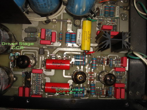

I replaced C38 with a 0.47uF Hovland and later I added a 2.0uF Hovland across C38 and R71. The latter was soldered underneath the PCB. The improvement from doing this was very similar to when I added a choke to the raw supply of my diy preamp. The sound became fuller and palpable. Hard to explain.
About adding the constant current sources(CCS), besides the input stage it's quite easy to do. If you want to try this, I suggest you do it with the second stage and the driver stage. The R13A+B are two 5.11K resistors connected in series. One end of these are connected to cathode of V2, the other to ground. There's about 70V drop across these two resistors. I replaced the one next to the cathode with a CCS configured for about 7mA of current sinking for each triode.
For the driver stage, R23 and R24 were replaced with ccs configured for about 5.5mA of current sinking. I added a 15K in series with this ccs so that the voltage drop across the ccs inself is about 20V and no heatsink is needed.
I used LM334(low voltage current source) for the second stage but used IXCP 10M45S(rated 400V) for the driver stage. The improvement was shocking.

when you added the .47 Uf hovland on top and the 2.0 Uf on the under side was because of space constriction? Is it OK to increase the values from 2.0 Uf to 2.47 Uf ???
Hi Slate,
It's because of space limitation that the 2.0uf had to go underneath. The cap was about 3" long. I didn't experience any oscillation problem from doing this.

Serratoga said:
I totally get it now, I see you have installed some Dynamicaps in the coupling section , how are they? And what values have you used?
They're 1.0uF. Slight improve on definition but also harder sounding. Very slight improvement, not a worthwhile upgrade.
Serratoga said:
I couldn't help noticing the work you did behind the 12BH7A,
is that a repair or an upgrade??
They are CCS in place of the original resistors.
