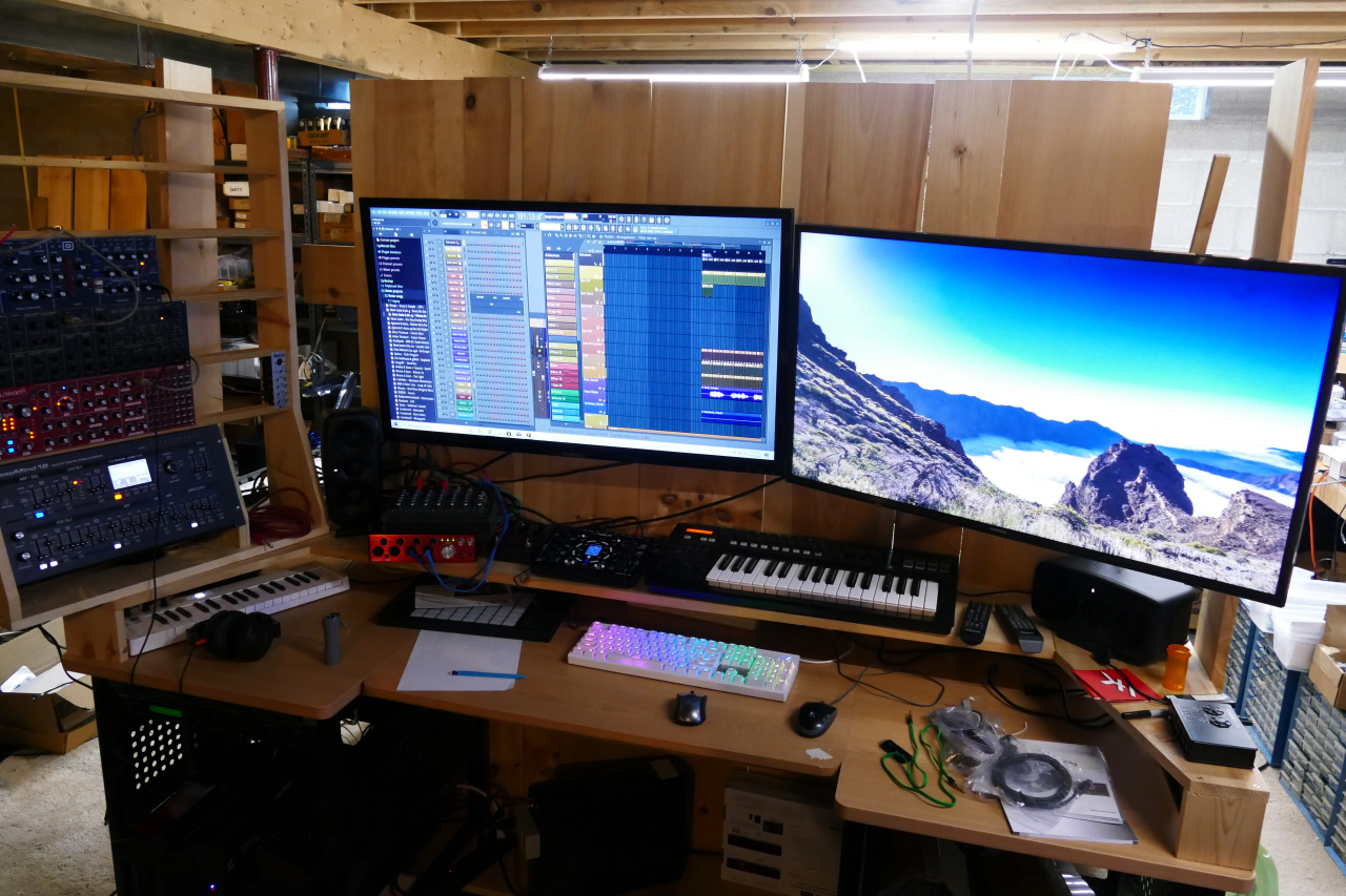

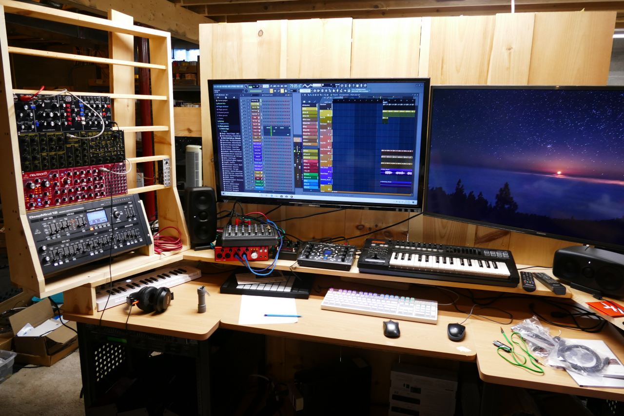

I have the exact same CyberPower UPS. It is a bit over 1 year old and has been run to low battery shutoff several times. It powers this AV workstation which consumes 250 VA before even starting the PC. The power consumption is 340 to 550 VA depending on what the PC is doing.
The display on the left is a cheap 40 inch Walmart 1080 TV which has no mention of power consumption on it. The display on the right is a bottom of the line Samsung 4K which states "typical" power consumption 45 watts.
There is a cabinet full of music synthesizer stuff, and a few more pieces in the rack above the PC (the blue dot in the lower left).
I started up FL studio and had it playing a 15 track recording through the monitors using the left TV screen. I streamed a 4K video from YouTube and put it on the right TV screen. Power consumption was 350 to 370 VA. Run time was 16 minutes before everything abruptly went dark.
If there is a power hit while I'm working I will shut down all but the PC stuff and the left TV. Run time in this case is from 20 minutes to 1 hour depending on how long I give it before starting the shutdown. We get quite a few short outages where the power company retries several times until it gives up, or blows the breaker on the shorted line. In this case it's a 5 minute blackout with several low voltage retries. Otherwise it's dark and cold for several hours or more....generator time.
