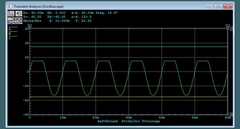

The bias setup looks like an MTX and if so, low bias means an asymmetrical clipping of the output waveform. If you see something like the attached diagram, the bias needs to be set slightly higher.
