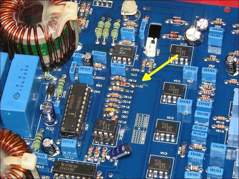

mnhiphop101 Member Joined 2011 2019-02-28 10:13 pm #1 2019-02-28 10:13 pm #1 Looking for the schematic for a US Amps MD-2D. I cant figure out what goes in Q2C in the picture I've attached Attachments Screenshot_20190228-160955_Gallery.jpg 285.6 KB · Views: 276 20190228_160853.jpg 995.3 KB · Views: 158 P Perry Babin Member Joined 2003 bcae1.com 2019-02-28 10:35 pm #2 2019-02-28 10:35 pm #2 See if this is it. Attachments MD2_output.zip MD2_output.zip 776.9 KB · Views: 96 mnhiphop101 Member Joined 2011 2019-02-28 11:42 pm #3 2019-02-28 11:42 pm #3 Is there different versions of this amp? Nothing is matching up. P Perry Babin Member Joined 2003 bcae1.com 2019-03-01 12:14 am #4 2019-03-01 12:14 am #4 Try this one. Attachments XT4000_output.zip XT4000_output.zip 824.2 KB · Views: 91 Last edited: 2019-03-01 12:17 am mnhiphop101 Member Joined 2011 2020-09-02 5:26 pm #5 2020-09-02 5:26 pm #5 This amp uses a 4080 chip. I have the chip out of the board and when I probe pin 6 instead of a nice triangle wave I get this. Any ideas why? Attachments 15990638945128304225216253326399.jpg 981.3 KB · Views: 87 mnhiphop101 Member Joined 2011 2020-09-02 5:27 pm #6 2020-09-02 5:27 pm #6 Sorry for the upside down pic. Idk why it does that P Perry Babin Member Joined 2003 bcae1.com 2020-09-02 5:41 pm #7 2020-09-02 5:41 pm #7 In similar amps, the zener goes out of tolerance. Attachments IMG_4051sgfb.jpg 122.2 KB · Views: 111 You must log in or register to reply here. Share: Facebook X (Twitter) LinkedIn Reddit Pinterest Tumblr WhatsApp Email Link Home General Interest Car Audio US Amps Merlin MD-2D schematic
