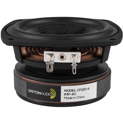

So to be more specific, I am looking for full range drivers similar to the Dayton CF-120 which is Chinese of course. In particular it has a low Fs and a large Xmax for this size and range speaker. Another example is a Tang Band W5-2143 though less Xmax. Efficiency is not a priority.Not really much to go on. Lot's of drivers available between 4" & 8". Kind of like saying you're shopping for a new car, with anything between 4 and 8 cylinders.

Dayton CF-120
Max flat sealed hits 100 Hz F6. 80 Hz in an ideal miniOnken.
But box size is a serious challenge. So small as to make it difficult to fit into the box. Might be able to squeeze some bas sout of with something like Victor or Vulcan-V.
