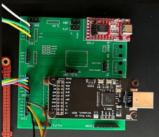

Photo of the module, second version.
The additional 4-pin connector can be configured as i2c/uart/gpio, and is also used for forced entry into the bootloader (in case of unsuccessful software update).
Available in two versions: USB-C and USB-B. The transport itself is quite compact: it fits into an area of about 2x2 cm - which is important for integration into other devices.
So I'm working on a smaller PCB with same functionality.

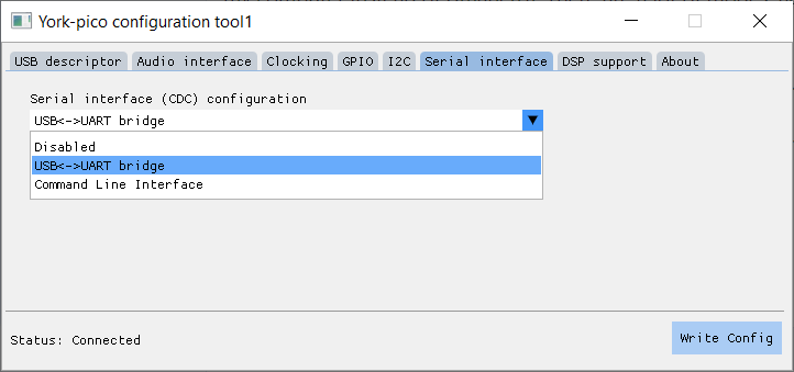

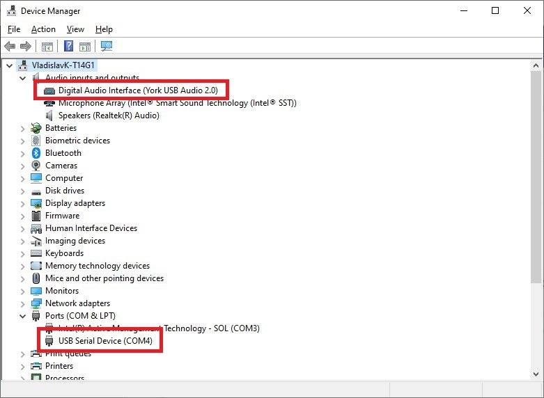

Couple of updates about the firmware.
1. I've implemented USB<->UART bridge (virtual com port), it now can be enabled from the config tool:
If enabled, the device will be seen composite VCP+Audio interface:
And the UART will be available on 4 pin header. I did ran many tests to check function with big chunks of data, among them - flashing of ESP32. No issues.

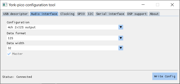

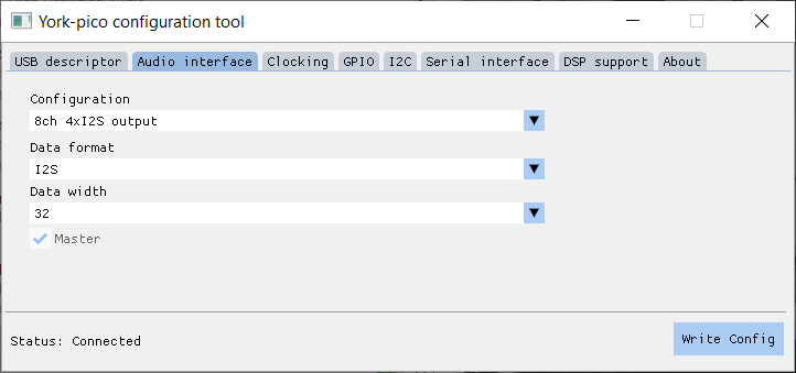

3. I've realised that in fact current hardware can output 8 channels not only in TDM but also as 4xI2S streams (1xWCK, 1xBCK, 4xSDO). So for next firmware I'm adding such option.

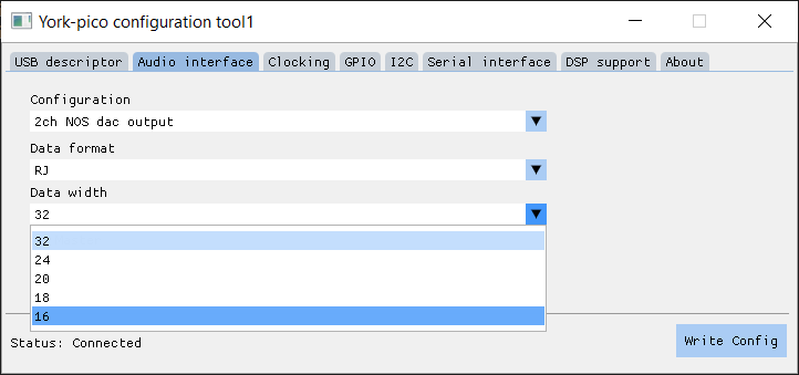

One more option is output for NOS DACs, with left and right channels streamed on different pins, 16/18/20/24/32 bits data width:

192kHz with 512fs masterclock and up to 384kHz with 1024fs.4x stereo out via I2S is just what the doctor ordered. And these can be streamed via USB with 96 kHz or higher?
The on-board oscillators are 512fs now (can be replaced by 1024fs) but most of high-quality applications have their own clocks on the board (like Crystek or something like that). The module can be configured to use external clock.

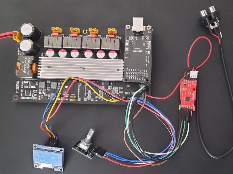

Tested in multichannel D-Class amplifier with ADAU DSP. Configuration used: 8ch TDM output + I2C to configure ADAU from PC with Sigmastudio.
Post: https://www.diyaudio.com/community/...-dsp-bluetooth-aux.376006/page-2#post-7720371
