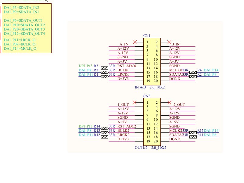

*serial ports (SPORTs) supporting I2S, left-justified sample pair
If I understand well, their mainboard 2 ADC and 4 DAC can be connected. So there is analog in via ADC, and then it uses i2s(LJ?) to connect with DSP.
According to schematics and if I read them well.. both ADC and DAC are connected Always to same pins on DSP when it comes to clock (no matter if its i2s IN or OUT):
DAI_P11 - LRCK
DAI_P11 - BCLK
DAI_P11 - MCLK
and only data lines are different
Is it possible?
I am adding full schematics in attachment also.
DAI_P11 - LRCK
DAI_P11 - BCLK
DAI_P11 - MCLK
Is it possible?

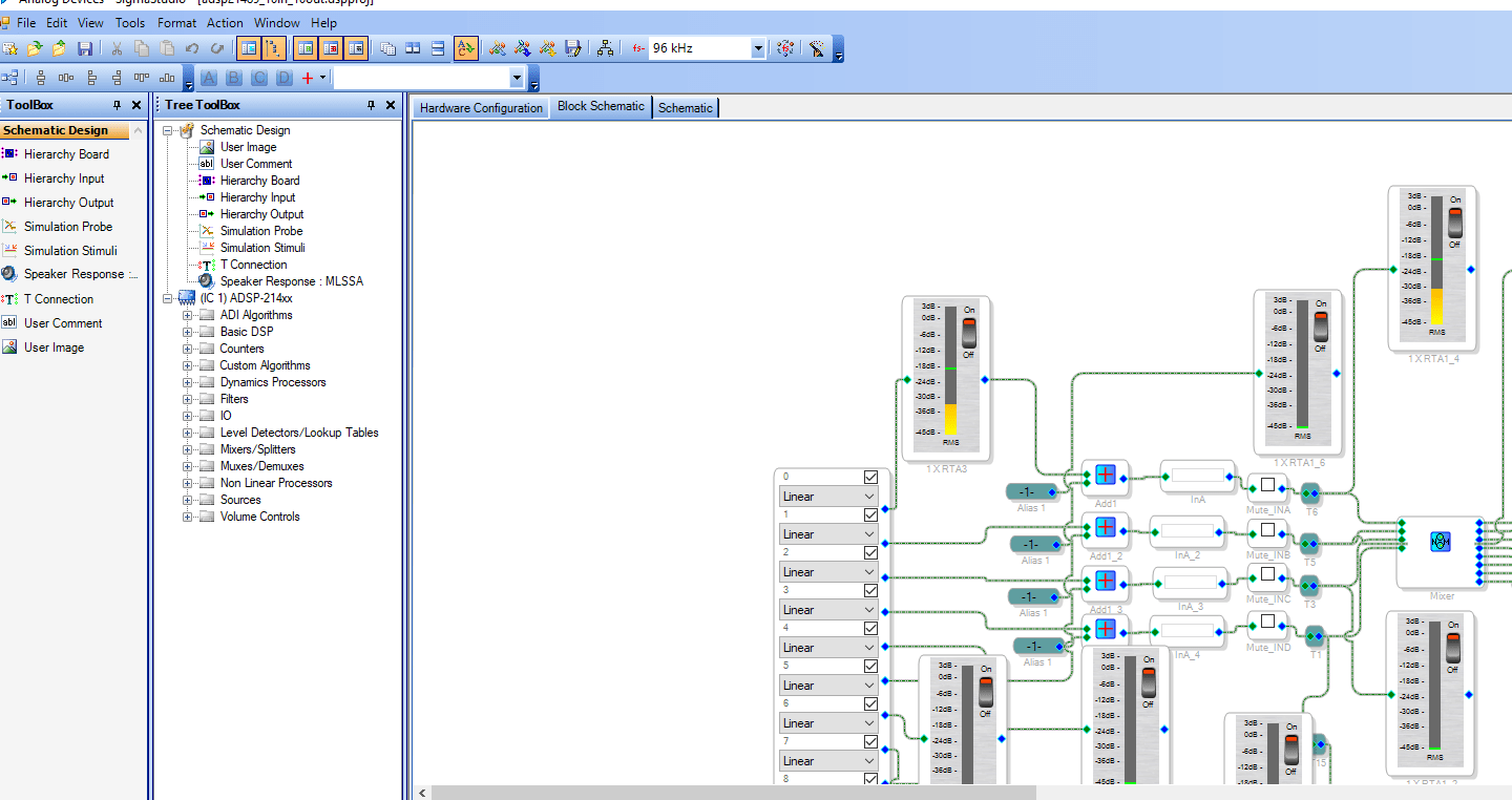

I connected XMOS with DSP again, set xmos output on windows to 96kHz.. and it worked🙂
No idea what was wrong.. connection (there been 2 differnt DGND connections on schematics?).. firmware ( i did try other from vendor).. Anyway seem to be working fine
in Sigmastudio I see signal and it responding as it should react to volume.. tone is flat line on vol meter etc

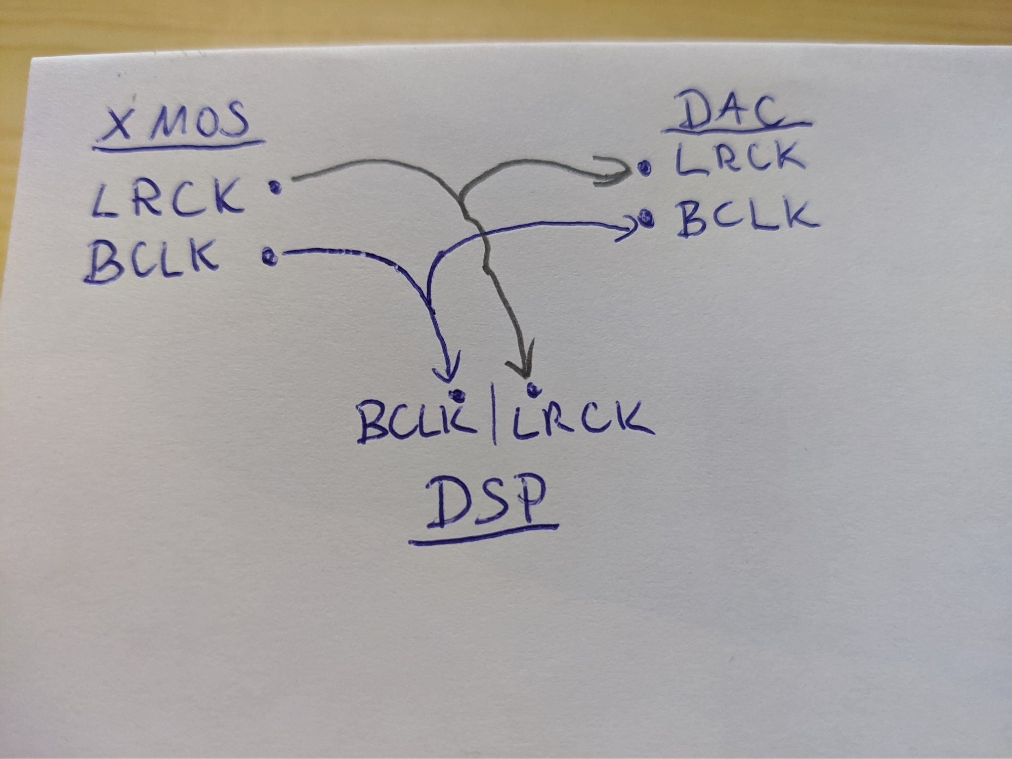

So that part is done (I hope!)
Now I have question:
Can I just take LRCK and BCLK signals from DSP and split them to go to both XMOS AND DAC ?
In dps schematics it looked like they done it this way, they just added 33R resistors

33R resistors are used at the output of I2S sources to damp transmission line reflections. Some people prefer to use somewhat higher values of resistance, maybe as much as 100R. Have to try it with a particular dac to see if any effect on the sound. The theoretical value is usually closer to 33R.
DSP is probably working now since XMOS board is outputting 96kHz, which is maybe close enough even if the XMOS clocks are not exactly the same frequency as the DSP clock (which should result in some errors, but you may or may not notice).
In Windows if you set the default sample rate and bit depth for the XMOS USB board to 96kHz, 16-bit, or maybe 96kHz, 32-bit, then Windows will resample the audio stream using its built-in SRC. Its SRC instead of ASRC since Windows can to it synchronously in this case. However, if you use ASIO drivers and or try to send DSD then you will likely have problems because then you could be sending other than exclusively 96kHz PCM all the time.

So to be sure.. its alright to just split LRCK, BLCK from single pin of DSP to two other devices?
I dont even think about DSD.. would have to be converted to PCM anyway since DSP will be my crossover🙂 And there is a lot of 24bit 96kHz flac files, rest can be resampled on PC - that suits me.
Supplying I2S clocks doesn't work with USB boards. They need master clocks. Some need 45/49MHz master clocks; Amanero uses 22/24MHz.
Some dacs only need I2S clocks, and other dacs need the master clock too. Old non-oversampling dacs may not use nor need a master clock signal. They only need I2S clocks.
Some modern dacs such as ESS have internal ASRC. That means they can work with I2S clocks from a source device without having to share the master clocks. ESS dacs still need some master clock, at least one of them. The master clock just doesn't have to be shared between devices.
Well I was asking if its electrically correct? about logic I will worry later.. first this🙂 Wouldnt like to break anything.So to be sure.. its alright to just split LRCK, BLCK from single pin of DSP to two other devices?

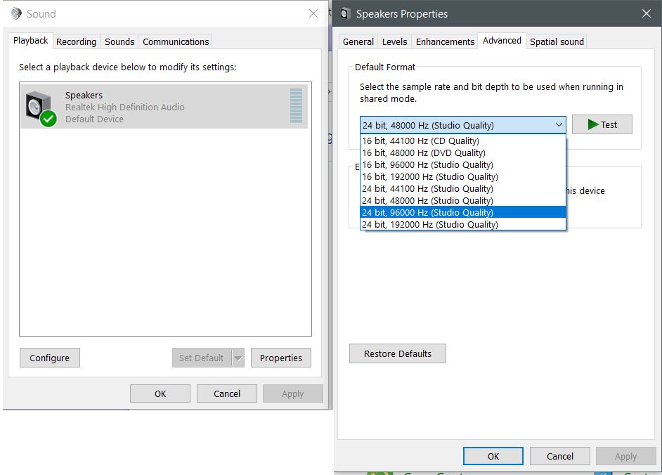

And now Im confused.. I tried every sample rate from 44.1 to 192 and 16, 24, 32bit.. and I see signal getting to DSP in sigmastudio.. same as it was with 96khz.. so I dont know how but its good I guess🤓. ASRC need to be enabled on both input and output to work?
I can verify this when I receive toroidal transformer for DAC power supply, so need to wait bit more.
Are you using Windows? If so, what is the default sample rate shown for the sound device you are using (see pic below for reference)?
OTOH, if you have verified the actual sample rates coming out of the USB board with a scope or other means, and if there are multiple master clocks in use, then ASRC must be happening somewhere, or else you would be getting errors that would affect the sound and or cause it to mute.
To further clarify, even if Windows is set for a default sample rate compatible with the DSP clocking, so long as there are multiple master clocks (after the PC) there should still be some bit errors occurring without ASRC. Whether or not such errors would necessarily be noticeable/audible could vary over time.
I have both Linux and windows now as SigmaStudio is for windows only, and yes thats exactly what I did (Your screenshot), was trying (to have other confirmation) ASIO output in foobar and set sample, but i dont see option for this, i could only select 16, 24 or 32bits. So i went for DAW software - Reaper. There is 'request sample rate' for ASIO but that also doesnt seem to work - I put something silly like 515515Hz.. and still was 'playing' in SigmaStudio🙂 🤷♂️ Apparently request didnt work.
Dac is very nicely made, there is even i2c socket so i can modify es9106 registers if needed, and can be easy way to implement volume control.
I will check real sample rate with my cheap logic analyzer.. now im in proces of learning how to make PCB at home - on DSP there is non standard male socket 2mm raster. I will try to make pcb, solder to that socket on DSP directly, also i want to put there 33R resistors for i2s signals and socket to connect to DAC.

ASIO in theory at least bypasses Windows Audio Engine so no SRC should be taking place in the PC. However, if the audio device has a green circle with a white checkmark in it as can be seen in the example I posted, then you may have a problem where Windows interferes with audio stream integrity.
One way to check sample rate at a USB board especially if you don't have a scope is the read to F0 - F3 bits on the USB board output connector with a DVM. They indicate the sample rate in a way that can be understood by an MCU controlling the dac. Since there seems some variation in how manufacturers implement that function, you might need the documentation for the particular USB board to see how they encode the clock-family and sample rate information into those bits.
