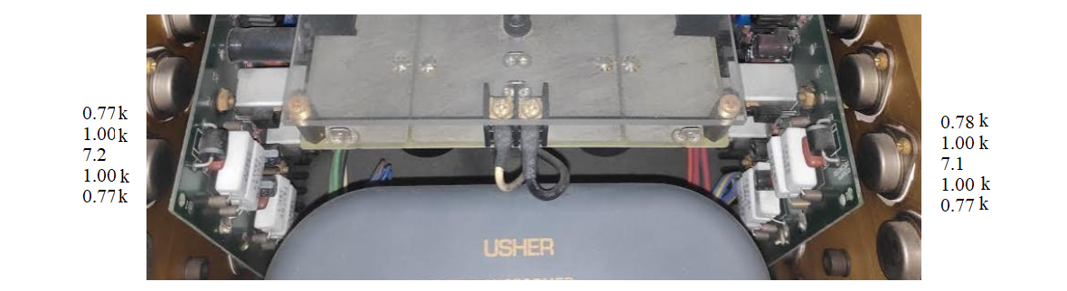

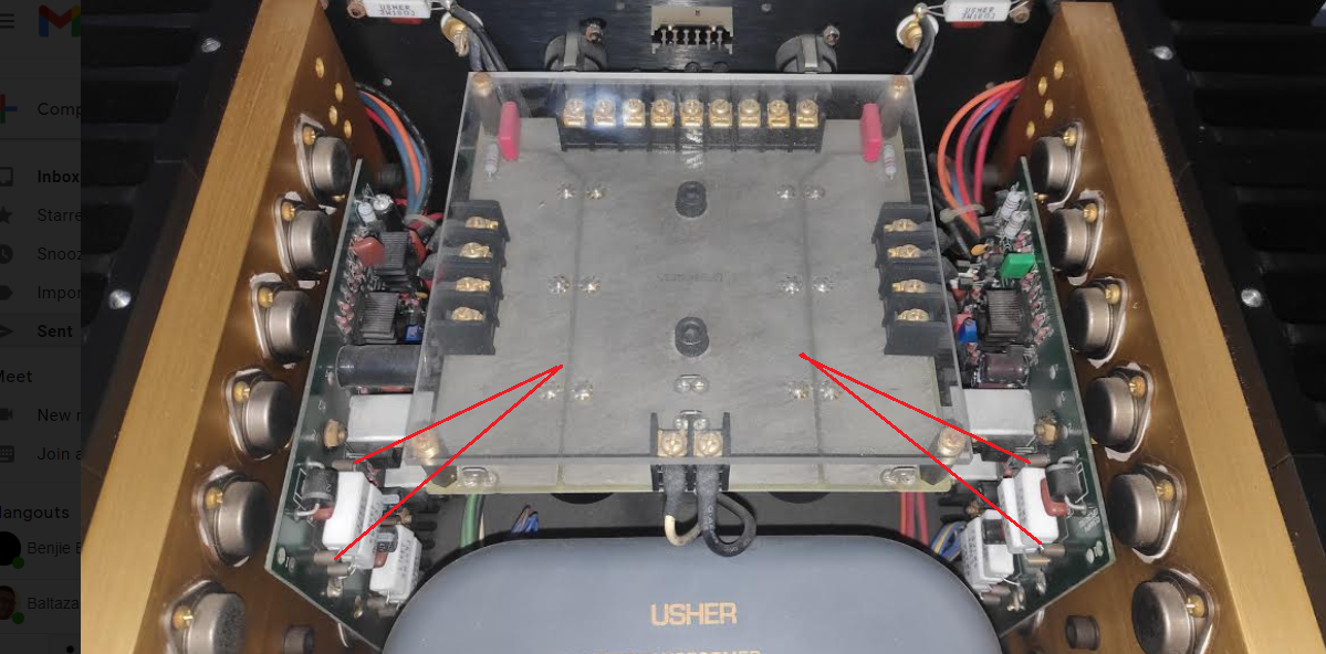

I know where the bias trimpots are, it is the blue trim pots on the left and right board. So if anyone can tell me where to exactly stick the negative and positive probe on my multimeter on the board, then that would be great.
Since there is only 1 set of trimpots, how is DC offset adjusted ?

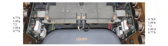

Measure the voltage across one of the white rectangular emitter resistors.
But check their resistances first, and replace any bad ones.
You have to know the recommended current per device to adjust the bias.
Or you could just adjust the bias for a steady state heat sink temperature of ~50C,
since this is a class A amplifier. Do that over a period of several hours of continuous operation.

Yes, for measuring the resistance with the power off.
If measuring the voltage drop with the power on, be extremely careful not to short anything.
One slip will destroy the amp. Recommend for this case that secure clip leads be used,
attached when the amplifier is off, and left on for the entire time that it is powered.

Yes, then V/R will tell you how much current is flowing in that transistor, but you don't know the mfr spec for that.
